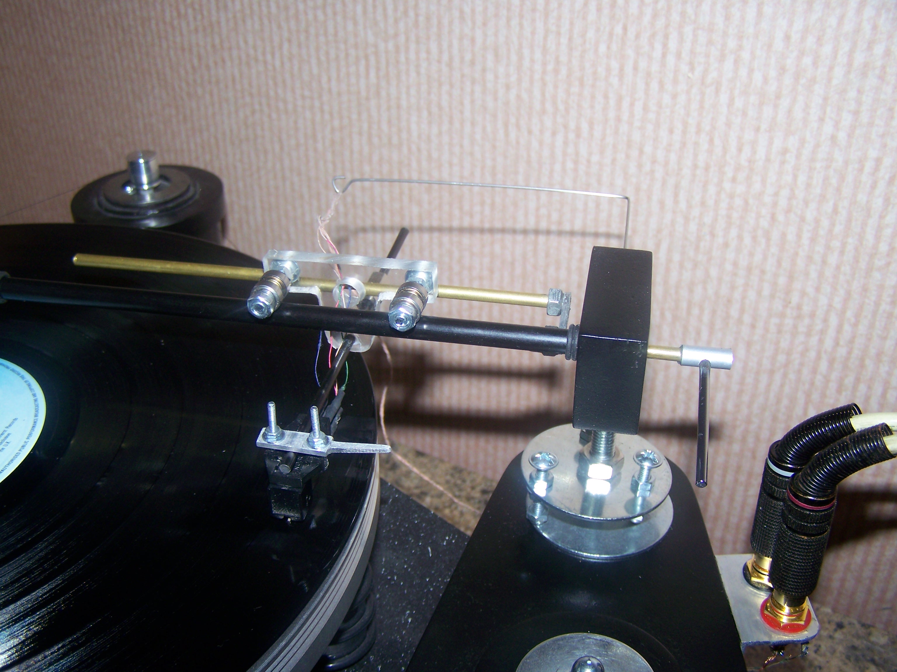

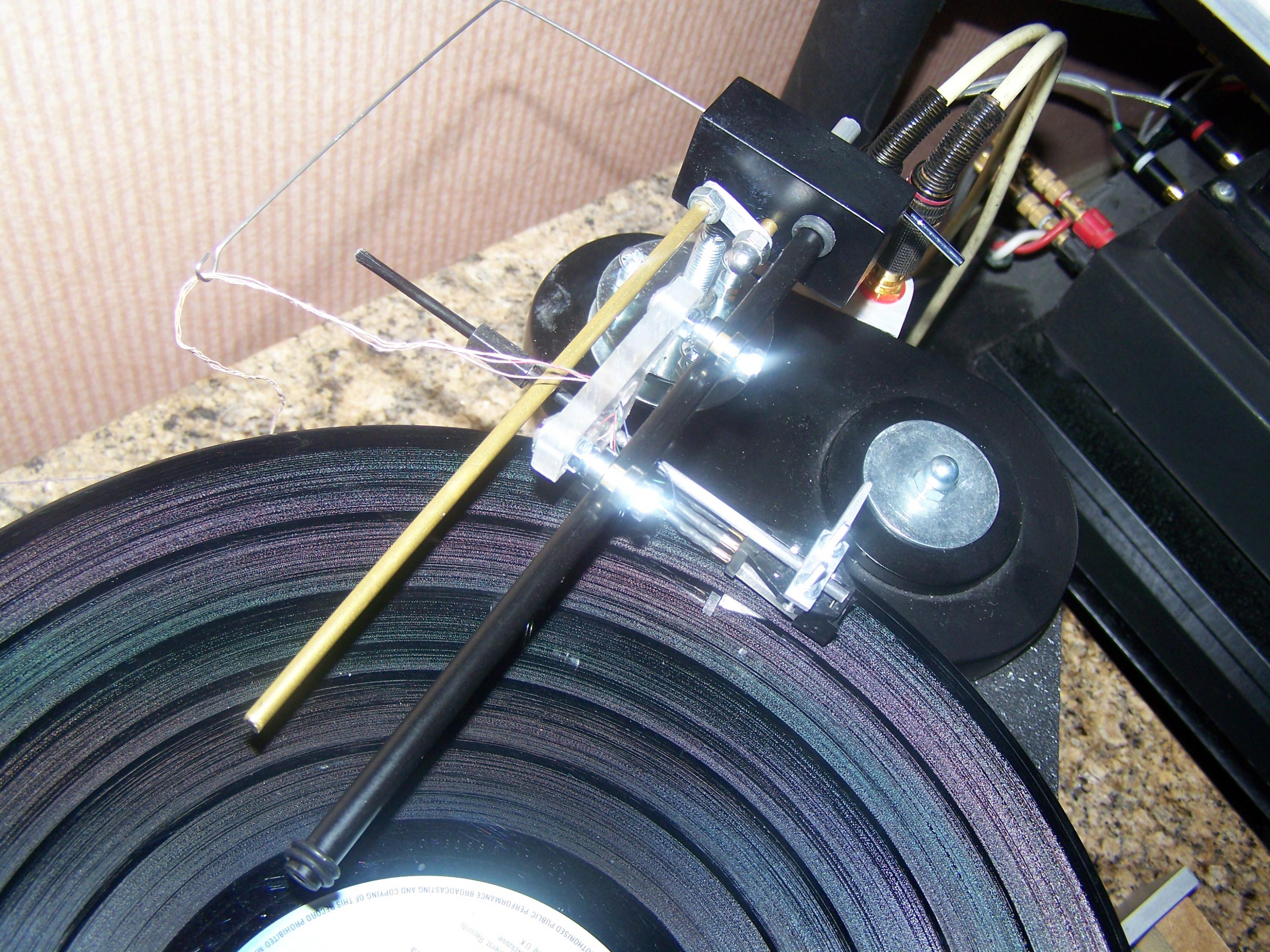

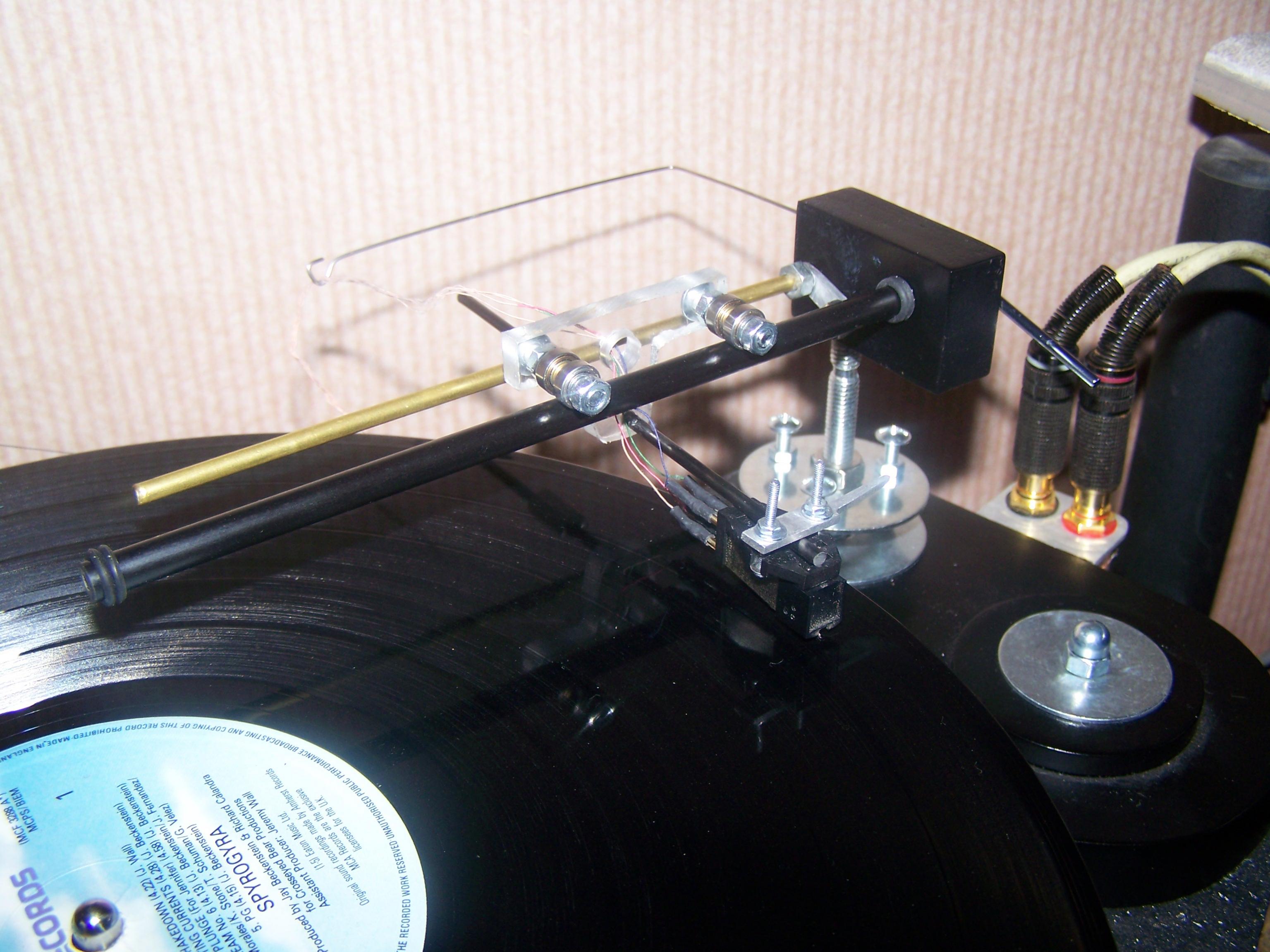

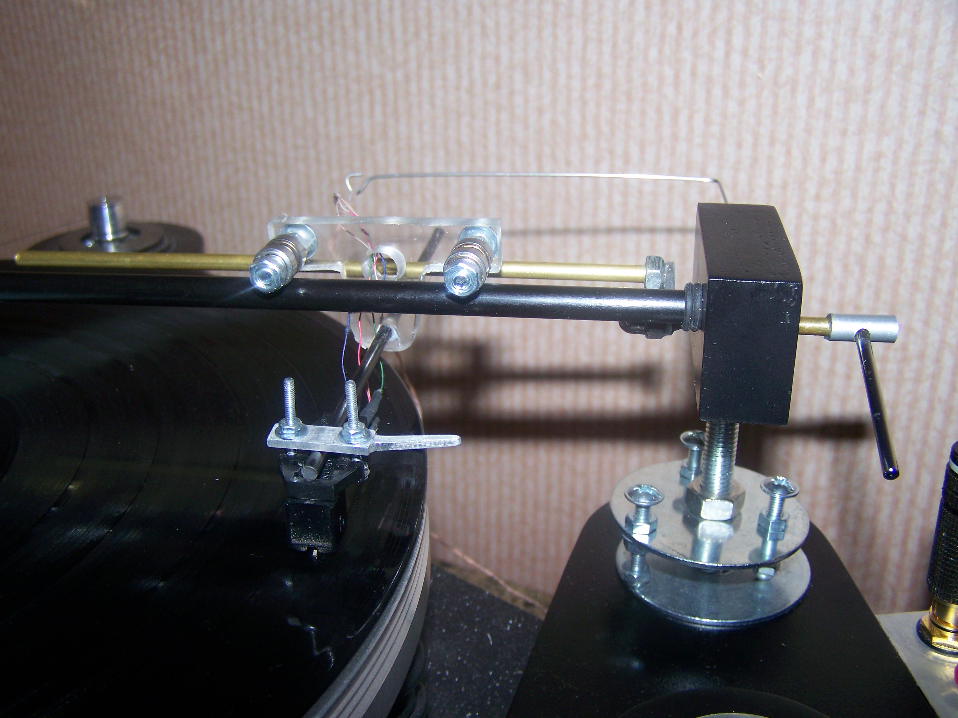

DIY Linear Tracker
Hi Everyone
Not sure if I've been successful in uploading photos, but here goes...... It worked. note the leveling apparatus at the base. Simple and works a treat.
Chris

ChrisG139, why is the tube that the bearings ride on a black color??
What sort of tube is that? Is it painted metal?
If so, that's a "no-no"
Hi
It's what I had around at the time-a fibre glass tube!
It's only temporary until the 5mm glass arrives this week-but oddly enough it seems to work very well.
