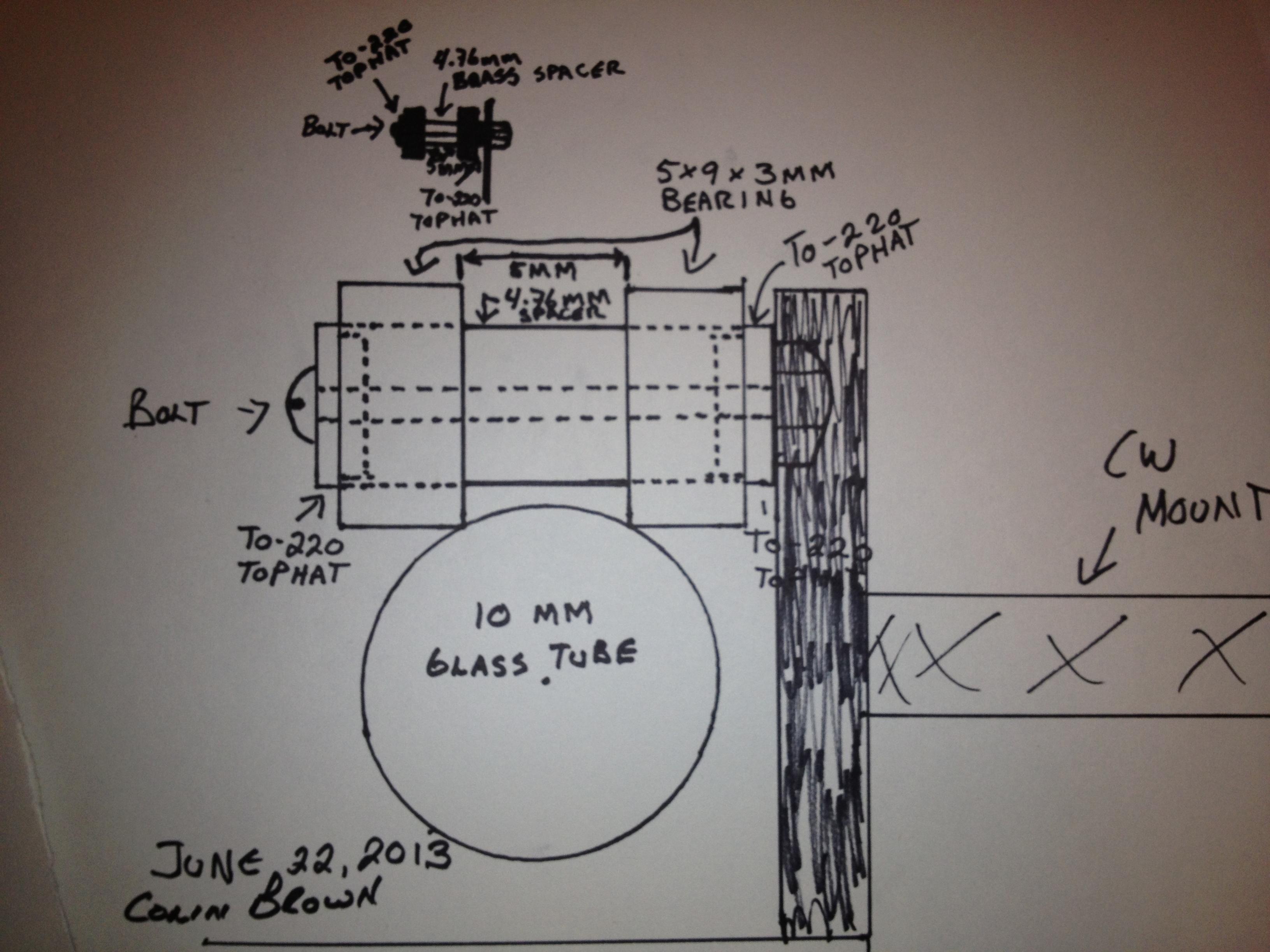

Hi, Waiting for my shipment of bearings to arrive. I'm beginning to see what you are doing with the brass tube/shim. So if the inner races were to seize in the outer races the bearings would still continue rotating albeit requiring more force than if the were free to rotate. A sleeve bearing within a ball bearing. Is this sleeve bearing well enough finished to permit the arm to continue following the grooves on its own?Hi Bill,
The bearings are used as shipped, I've also seen mention of bearing weight, I'll be lucky if these bearings even weight a gram each 🙂. One must remember too in this design the bearings don't need to entirely rely on the bearing races, the brass spacer/tube will take up any resistance encountered. I'm sure as it comes apart the beautiful simplicity of it will reveal itself. In essence it has a back up system for lateral movement.

In regards to the brass spacer, it's not polished at all, just cut, the edges filed to scale and fit!. I'd have to add, the tube size is important to a degree, larger than 10mm and you will have to revise the bearing spacing, as to how this will work, I don't know. This bearing arrangement is a case where the tube , bearings, spacer and gravity all work together as a whole.

I agree that there is probably enough information in the thread to build this arm or a derivitive of it, however, I think that one thing some of us are struggling to understand is the use of the brass shim inside the inner bearing race. Perhaps a diagram of how this part is arranged would help quite a few of us. Looking forward to any help you can give on this vynuhl addict. As they say : "A picture is worth a thousand words!".
jamikl
jamikl
I think I can help?
"brass shim" = spacer between the two inner races of opposing ball bearings.
ascii art:
Where the "[]" are bearings
and
the "------" is a brass tube used as a spacer.
it could be tungsten, titanium, plastic, bakelite, a stack of small washers, whatever you want.
ascii art:
and
