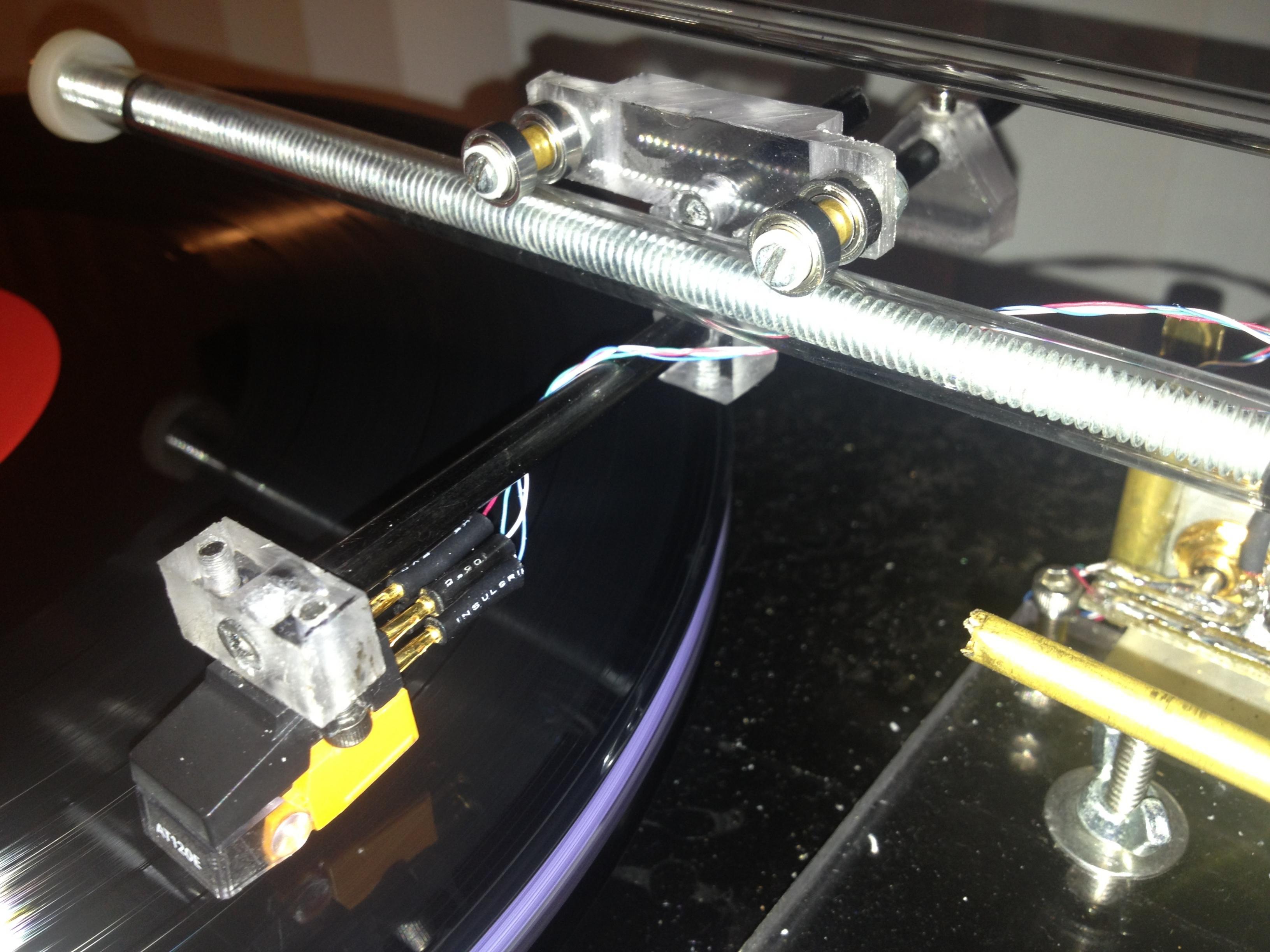

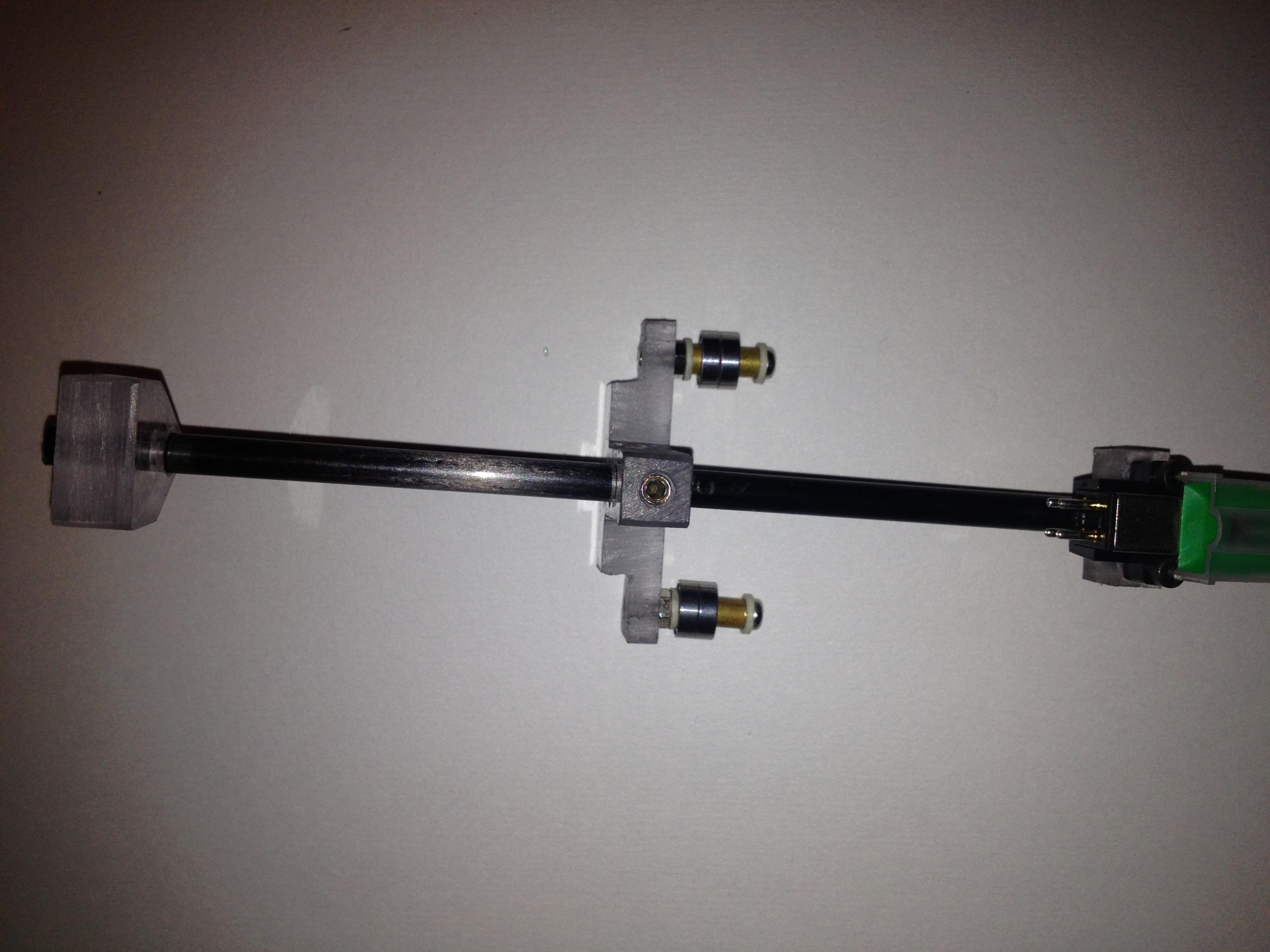

Update on recent carriage,
After some listening, this is much better than the epoxied two wand arm!. The only part glued now is the headshell with super glue, using the right drill bit I'm able to bore t out enough for a tight press fit, the glue just sites it. The wand is .220" carbon fiber tubing that is one straight piece. The counterweight is slung so that its mass now hangs just below the top of the cartridge, the better energy transfer is instantly noticed in the bass, bloody solid and deep!, along with inky black background in quiet pressings. The bearing piece that holds the wand is cut in a T from 10mm polycarbonate with a set screw to lock azimuth and arm wand.

I lashed that arm together from stuff, including the brass tube, that was around my shop. I've used metal tubes before as first approximations. If an idea works even somewhat, it may be worth pursuing. Even with the brass, the performance of Colin's design is impressive. I think I can pick up a glass tube locally. If not, I can get stainless steel.
As built, a more pressing consideration is that it's about 10 gr. too heavy, but I think that can be dealt with.

I'm not quite sure why, but dry bearings, even free spinning ones, like you and I are used to using don't work well on this design. The improvement when I switched to sealed lubricated bearings was significant, in fact it pretty much wouldn't work without them. Both sets were ceramic hybrids.
Colin's point about the geometry of this arm being critical is worth paying attention to. The arrangement of the bearings on the tube and the relative positions of the headshell and CW are important.
For me, Colin's design is an object lesson in not rejecting possibilities on theoretical grounds. I was playing with a carriage idea that involved either three or four bearings but dropped it because, without doing any testing, I decided there would be too much friction.

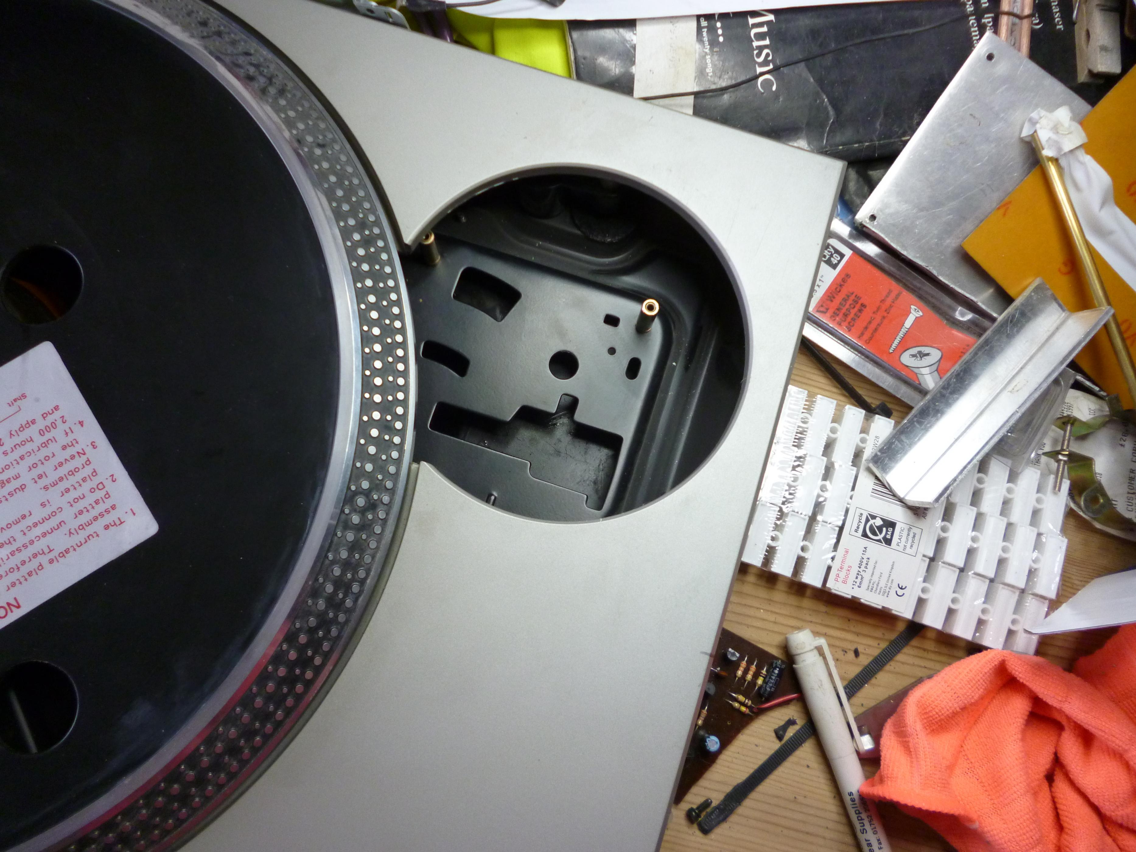

how to mount
On a technics SL 1800, the tone arm was originally mounted to the bottom half of the plinth which has some sort of suspension system on it. Will I get away with mounting on the top half or will I have to adapt the existing mounting pillars on the bottom half?
AND
I take it we are after a wand length of about 2 to 2.5 inches
Not sure why I keep posting to this thread... heh. Kinda fascinated with the simplicity of the design.
But the relationship between the arm and the record surface needs to be 100% stable. I think this means that isolation via a suspended undercarriage is out for this sort of design.
However, they may have gone to this because there is an issue with the mechanical noise of the TT motor itself that was being transmitted to the arm... otoh, was this an automatic pick up or drop arm system? That might account for the mounting set up too.
After mounting on the top I think you'll want to do something for increased isolation between the TT and whatever surface you have it sitting on top of.
One method that is very inexpensive and works well is a sand box.
Fine sand in a box, with a flat surface sitting on top of the sand upon which the TT sits.

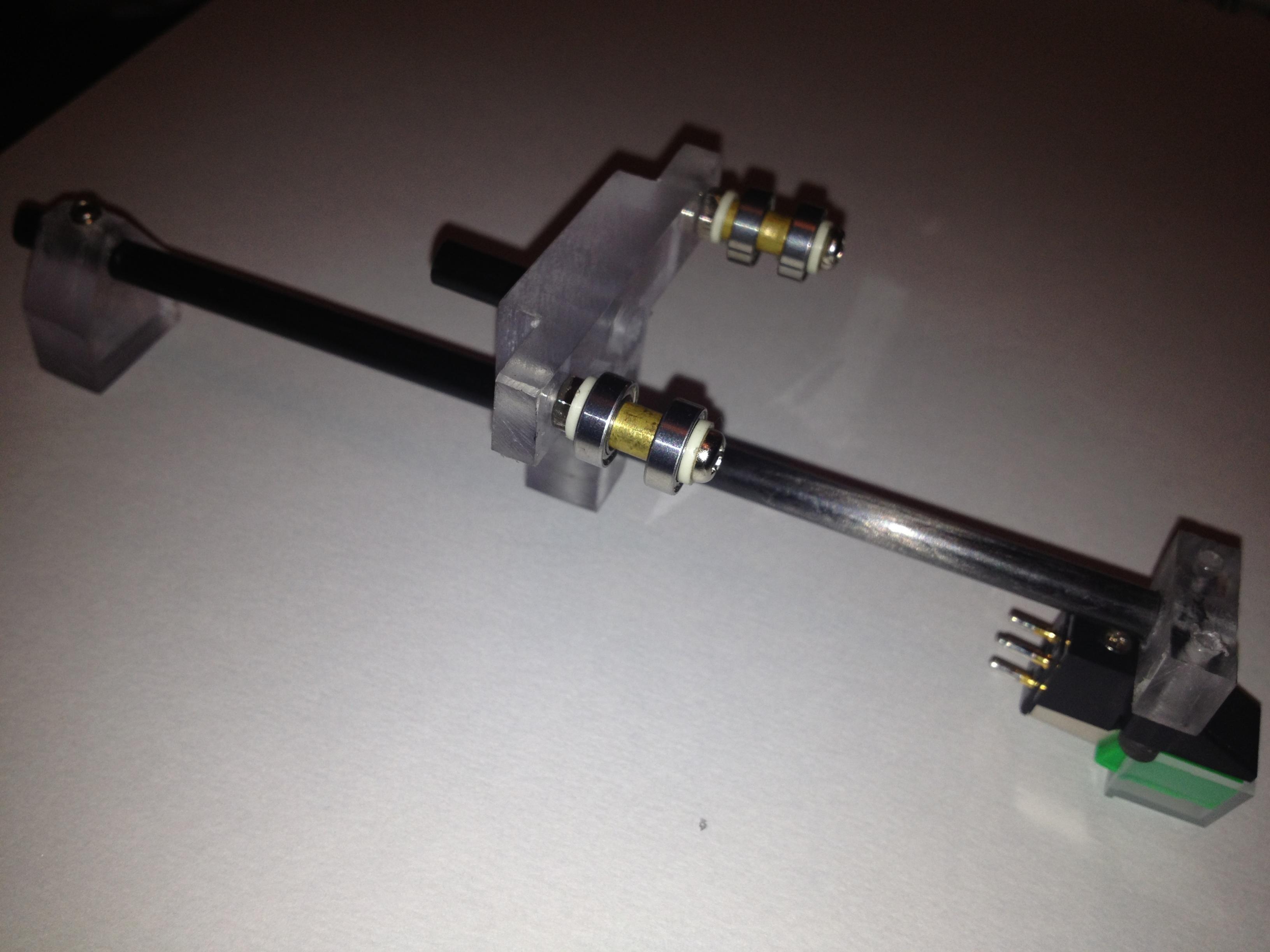

Last night I made up a new carriage. Two new 4 x 10 x 4 ceramic hybrids, lubricated as they come from AcerRacer and two taken from my last carriage. These were running clean and dry so I cleaned them again and lubed them with a tiny drop of general purpose clock oil. Followed that with a spray of WD40 to thin the clock oil a bit. (This is a temporary lubrication). I try to avoid WD40 like the plague. Mounted a 10 mm glass tube in an old experimental LT arm and today played a few records. I still don't believe my eyes and ears. Everything you guys say is correct. I'll be saying more soon after using this for some time. Have to be out of town for a few days so I won't be able to use the arm till after I get back. I will have access to the web though so I may comment on your posts.
Looks like there has to be some serious analysis to explain why Cantus linear trackers have to be run with dry bearings or conversely why these 4 bearing designs don't want dry bearings. I'm buffaloed for now but pleased with the development.

Awesome to hear that you put the concept together, even quickly thrown together the benefits are instantly noted!. I am very happy with the way the bearing arrangement performs, the spacer is definitely important and part of the success of this arrangement, brass is preferred of course since its softer than steel. With the newest pics you can clearly see the arrangement. I still can't get over how much better transients are, with any pivoted arm I've tried the sound is nice, dynamic but always seems to smooth out the transients leading edge smearing impact, some to a lesser degree than others. I guess it's a case of when it works right, linear arms have the edge over pivoted arms 🙂.
