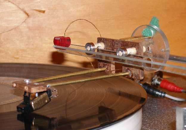

You can use window glass for your track. Not sure that adding a metal angle provides much more for the added complexity and thickness. Take a look at a build by one of the members. Best regards Moray James.

You are right Moray, the V groove track works extremely well and is easy to implement. DTUT and I have experimented with some various V angles and our conclusion was that angle didn't matter much if at all. By no means is that the final word though. See the OPUS 3 CANTUS thread for full disclosure. The pic that Moray posted is of an early prototype. I will try to post pic of a more uptodate version. It realty is the same as the crude version but is a more elegantly done piece. Do I think that a more shallow V angle would work better? I don't know. Part of my desire to experiment with the 4 bearings on the outside of the 10mm tube is to get a test of the bearings riding on a smooth round track as opposed to a 90 degree angle slab sided track.

There is no scratching there is only sliding with warps. I see (as far as the motion of the carriage goes) no difference between sliding on the outside of the glass tube or on the inside. There are other issues but as far as this goes they are the same to me. Best regards Moray James.
The reasoning behind using the threaded rod for me was ease of assembly, and the ability to replace the tube should it break or another idea pops up. Perhaps a long video of it in action might just go to put away the reasoning for why it shouldn't work 🙂. On warped records, despite the friction I cannot see any stylus deflection taking up the warps, arm carriage pivots as it should to accomadate a warp. This means clearly mass and friction is low enough to be easily overcome.

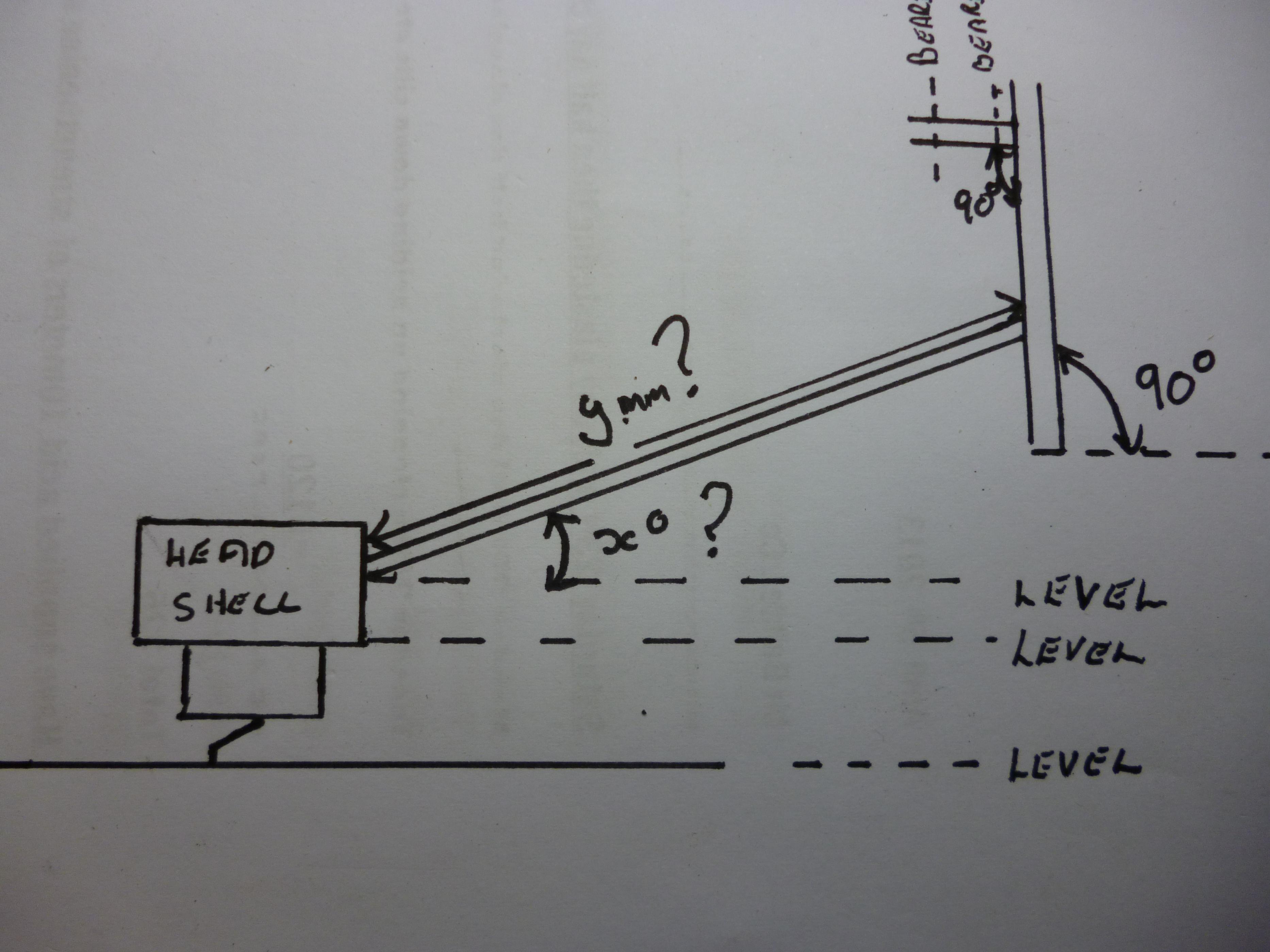

Looking at your diagram I must point out that the higher you place the tube and the lower you put the headshell the more a small warp will cause a loss of tangency to the proper cutter head replication. Even with the angle of the tonearm this is the same as placing it at 90 degrees in line with the headshell.
Colin
