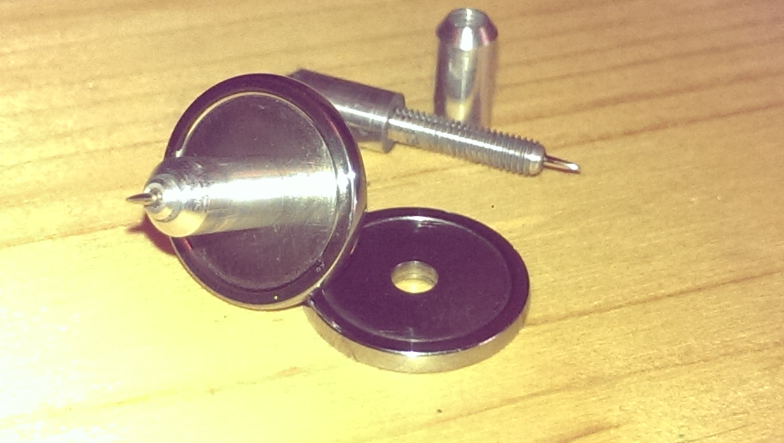

What is the armwand resting on? Ball bearings instead of spikes?
First, two air bearings can hold the carriage more stable and reduce up and down motions. Second, making the pin and v-cup this way, it will have better control of the pin(spikes). The am wand has two pins. The pins are against the v-cups. There must a mechanism to adjust the tightness of the pins and the v-cups.

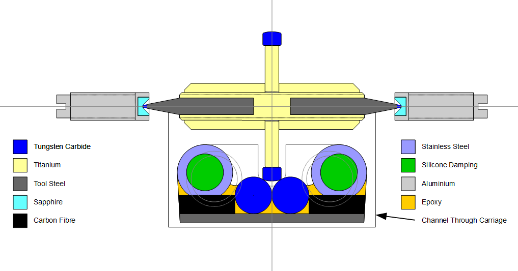

Hi all.

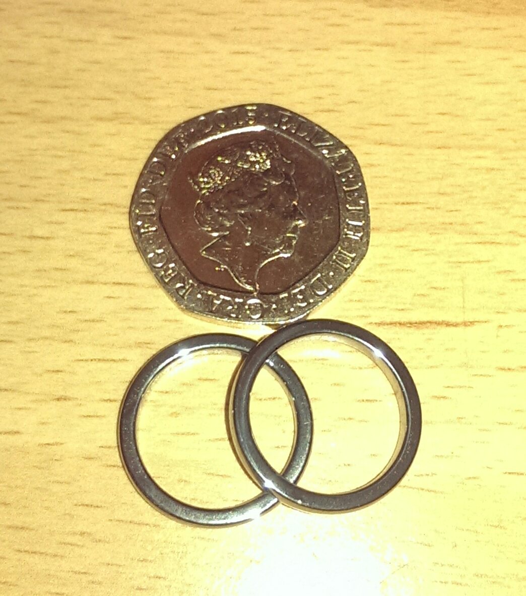

The Tungsten Carbide rings arrived today.
They are sold as wedding rings. They look perfect for the task. I measured them with a micrometer and the results were pretty good. Both were circular to within about 10micron and were also the same size to within 10micron and more importantly the perfect size for the task. As a comparison I measured one of the stainless steel wheels I had made. Remember I don't possess a lathe. These were made in a pillar drill with a file and sandpaper. These were only circular to 50micron, not bad considering the production method. So as I hoped they are more circular than my current wheels. This should help make the level of friction more consistent, the plot on the graph should be taller and narrower and hopefully at a lower friction level. Now I have to make them into wheels, test them and most importantly listen to how they effect sound quality.
Happy days.

Hi all,

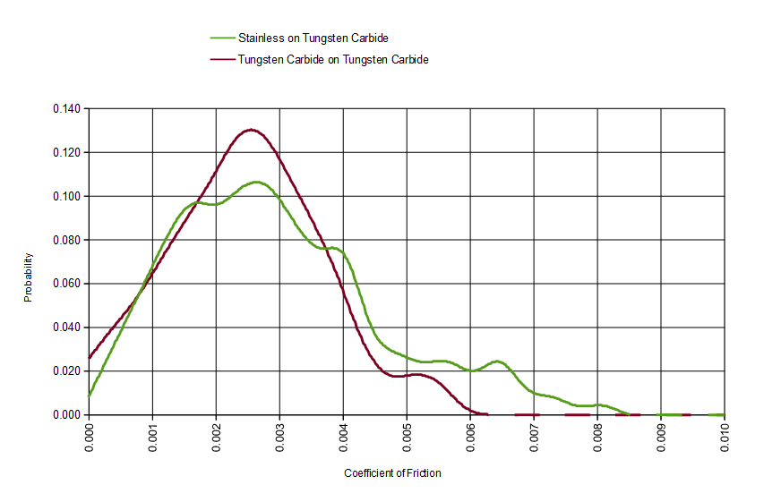

I've had frustratingly little time for building and testing since I last posted but I have now managed to turn the tungsten carbide rings into wheels.
I'm still only using the basic pin bearings as I'm determinedly making only one change at a time so I can clearly see/hear the difference each change makes in isolation. The new wheels are titanium with the tungsten carbide rings as rims. I contemplated making the centres from aluminium in order to reduce mass and made wheels in both materials for comparison. The titanium ones had a much better feel to them and their greater hardness and stiffness should aid mechanical grounding. I also modelled the effect of the different masses in my carriage design spreadsheet to see how each would effect effective mass and the overall centre of mass and its effect on tracking force variations due to warps. I also modelled the effect of using the different materials for the axles and hubs. To be honest the variations were to small to have any real significance. When starting the whole design process I set targets for vertical and lateral cantilever compliance resonance (based on my current cartridge) and tracking force variation on an average unclamped record warps (0.3mm). My targets were 9.5hz vertical, 4.5hz lateral and less than 1% tracking force variation. The best combination of wheel materials gave me 9.45hz vertical, 4.54hz lateral and a tracking force variation of 0.75% (in reality this figure will be much lower as I have a very effective warps flattening clamp). Pretty close all round. The diagram below shows the materials selected for the wheels and rail.
I managed to avoid the temptation to put the new wheels straight onto the arm and start listening. I thoroughly tested the wheels in the same way as with the previous versions. The graph below shows the comparison between the steel wheels and the tungsten carbide wheels both on the tungsten carbide rail. The steel wheels plot looks a bit different from the previous post as I have halved the amount of smoothing. As before lower friction is to the left., a peek further to the left indicates lower friction. A taller, narrower peek with smoother sides shows a more consistent bearing.
The difference between the two types is immediately obvious. The curve for the tungsten carbide wheels is very smooth and taller showing greater consistency. The irregularities in the steel wheels plot that I had assumed were due irregularities in the pivots are now obviously due to irregularities in the steel wheels. Although the mode (the highest point) in both plots is at the same coefficient of friction, 0.0026, the mean value for the tungsten carbide wheels is much lower. The mean for the steel wheels was 0.0030 giving a composite of 0.0028. The mean for the tungsten carbide wheels is 0.0025 giving a composite of 0.00255. That's a further reduction of 17% mean and 9% composite. All moving in the right direction. The cause of the lump off the right hand side of this plot, at 0.0055, is a bit of a mystery.
As performed previously I also checked vertical friction using the simple pendulum test. This indicated that vertical friction also dropped by about 17%. This is in line with the calculated drop of 20%.
Rolling the test carriage back and forth on the rail was surprisingly noisier than with the steel wheels, still much quieter than the ball race bearings.

These two wheels look very nice!
I also looked the chart of friction. Beside friction, the stainless steel wheels have large tolerance of roundness. Its curve is not as smooth as the titanium wheels with the tungsten carbide rings. In other words, the roundness is playing a role here, too. Anyway, it doesn’t overthrow your conclusion that the wheels with carbide rings are better than stainless ones in your case.

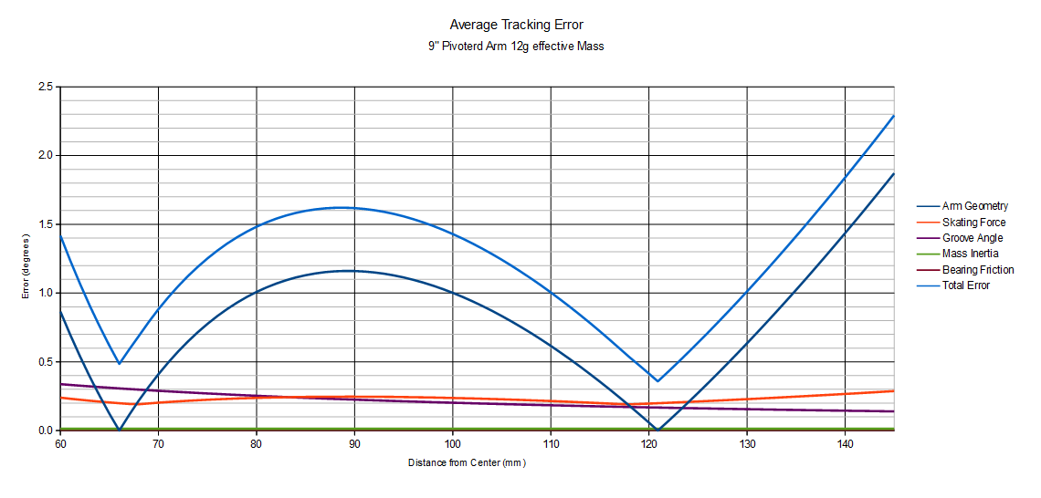

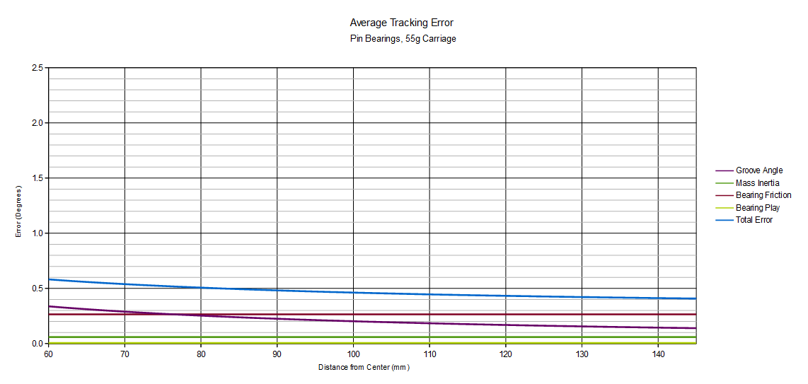

The two graphs below show the separate factors that contribute to lateral tracking error for the 9" pivoted arm and my pin bearing linear arm. I excluded the effect of bearing play for the pivoted arm as its effect was virtually zero. Arm geometry and skating error are not present for the linear tracking tonearm as these are factors that only effect pivoted arms. Both graphs shown the average tracking error, averaged over one full revolution across the whole record. All graphs are shown with the same vertical scale to enable easier comparison. The purple line in both graphs shows groove angle and represents the minimum possible average tracking error for this level of eccentricity. Of particular interest in the pivoted arm graph is the red plot that shows skating force error. This is calculated assuming perfect anti-skate adjustment. Even perfectly set up anti-skate still leaves errors as great as those due to groove angle changes. Even if the record was perfectly concentric the level of skating error would still be at this level. The single largest contributing factor for the pivoted arm is the arm geometry as shown in dark blue.
The dark green plot in the linear tracking graph shows the level of error due to the mass inertia factor. This is at a very low level and definitely does not contribute anywhere near enough error to increase total error to be as much as that of a pivoted arm. Having said that, this is still a quite a lightweight arm and a heavier arm would have had a greater effect but not to anywhere near the level some have claimed. The red plot on this graph shows average bearing friction which is the largest contributing factor apart from groove angle.

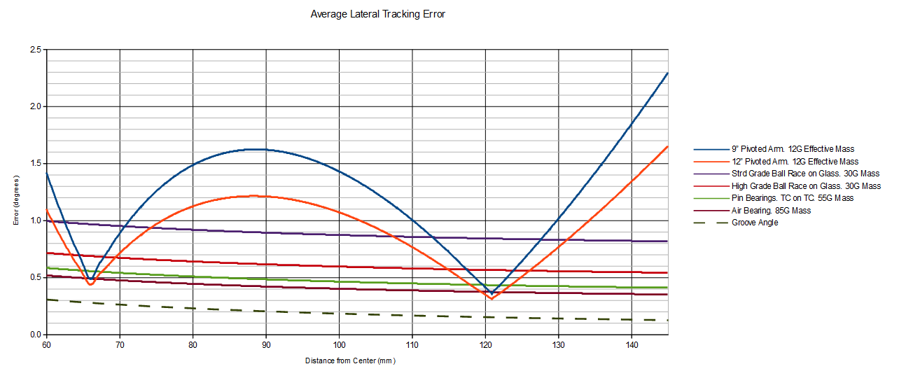

Investigation into lateral tracking errors pt2
The two graphs in this section show the totalled lateral tracking errors for the 6 arms previously described. The first graph shows the average tracking error over a single revolution of the record. The second graph shows the maximum tracking error that is likely to occur during a single revolution of the record. I have included the error due to groove angle, dashed green line, separately in both graphs as this shows the minimum possible tracking error.
As can clearly be seen in this graph both the pivoted arms have much greater average tracking errors than any of the linear tracking arms. Only at their null points do they drop below the friction of the linear arms and even at the null points the air bearing arm is still as low. Although the pin bearing arm, light green, shows a tracking error almost as low as for the air bearing, plum, it has to be taken into consideration that the air bearing arm is considerably heavier. Likewise the ball race arm using high quality bearings, red, only gets as close to the pin bearing arm because it is much lighter still. This highlights the advantage of a low friction bearing design as it allows the use of a more massive rigid carriage without paying the price in increased lateral tracking error.
Another feature common to all of the linear arms is that the tracking error remains much more constant across the record than either of the pivoted arms. This can be highlighted further by looking at the overall average across the whole record. The overall average tracking errors are:
9" pivoted. 12g 1.202°
12" pivoted. 12g 0.912°
Std grade ball race. 30g 0.878°
High grade ball race. 30g 0.601°
Pin bearing. 55g 0.469°
Air bearing. 85g 0.407°
Even the std grade ball race arm has lower average tracking error than the 12" pivoted arm although the difference is quite small. This does seem to partially confirm the original hypothesis that bearing friction in mechanical linear tracking arms can cause tracking errors as great as those in pivoted arms. It is of course pitching the best of one breed against the worst of the other and still coming up short. When the advantage of being able to utilize short arm tubes is added into the equation the linear tracking arm moves even further ahead.

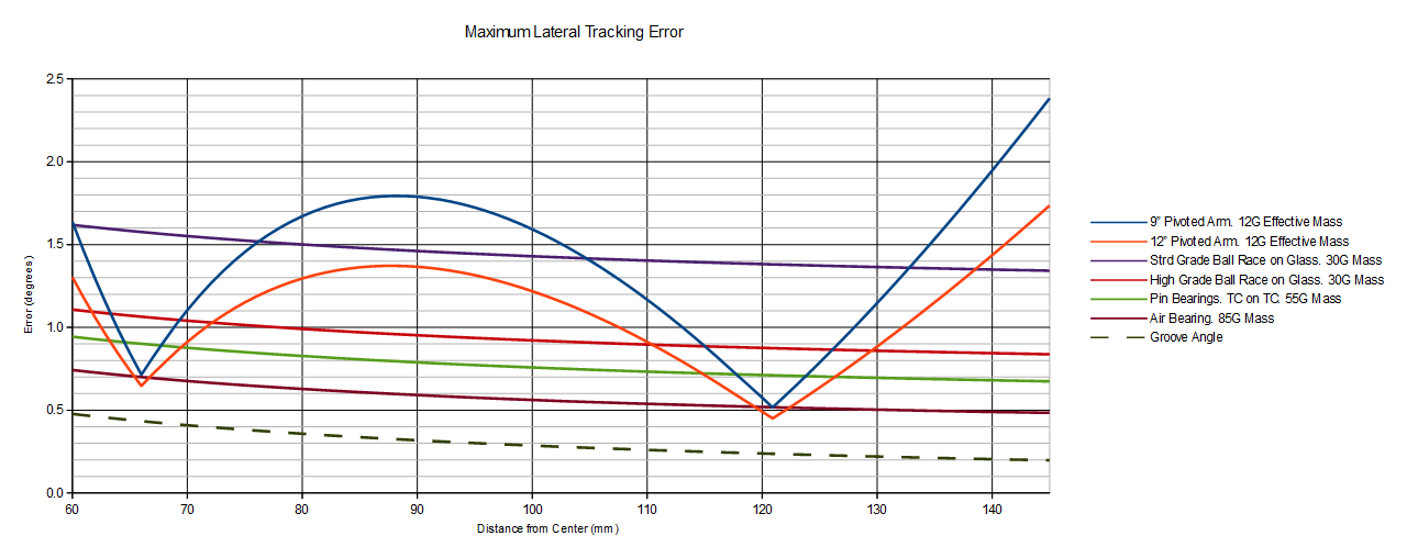

The next graph shows the maximum tracking error that can occur during a single revolution of the record
The most notable feature of this graph is that the maximum tracking error for the std grade ball race bearings exceeds that of the 12" pivoted arm for most of the record and is similar to the 9" on average. This shows that although the variations averaged over a whole record may be lower the variations within a single rotation are higher. This is due to the low consistency of this type of bearing and would recommend that anyone considering building a mechanical linear tracking tonearm with ball race bearings avoid the basic grade bearings and buy the best quality available. This was confirmed in my listening tests
All of the calculations and testing would indicate that air bearings do offer the lowest levels of lateral tracking error. This is of course only one aspect of tonearm design and in itself does not guarantee high sound quality.
On the initial premise that bearing friction can cause tracking errors as great as those in pivoted arms. This is only true if you select low grade bearings if you are using a low mass arm, so is not a fair comparison. High quality bearings in a low mass linear arm will offer significantly lower lateral tracking error than even the best pivoted arm.
On the premise that the high mass of a linear tracking arm causes tracking errors as great as a pivoted arm. I don't think that this investigation has totally debunked this or relegated it to myth. To approach the same average level as a 12" arm would require an arm mass, using the same 22um/mN cartridge, of 600g. (assuming moving air bearing with flexible air line). Remember that this is still assuming that there is a high level, 1mm peek to peek, of record eccentricity. With a record with little or no eccentricity the tracking error for the pivoted arm would drop only fractionally whereas with the air bearing it will drop to virtually zero.
However combining the two premises... If you were to be using the high grade ball race bearings the carriages mass would then only need to be 50g before the average tracking error was as great as the average for a 12" arm. This figure was derived using all the same factors as used throughout this investigation. I originally had these bearings on my carriage which had a total mass of 53g which would have meant that my average tracking error was slightly greater than that of a 12" pivoted arm. Even at this mass the linear arm would be much more consistent across the record and the absolute maximum tracking error seen would still be considerably less than that for the pivoted arm. Plus My 100mm total length carriage has better resonance control than is possible with a 300-350mm armtube so any minor losses in terms of tracking angle are more than made up for.

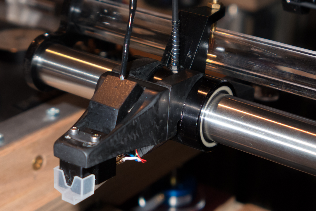

WOW Jim,
That is one smooth running bearing! I might have over calculated the effect of the stiffness of the air supply tube in my previous post, maybe by as much as a tenth of a degree. Very impressed.
The new carriage looks fantastic. It looks much more like a single solid component than your previous versions which I think will make a positive difference. Tapering the headshell in the way you have is an excellent idea. It will take mass away from where you want it least, the end of the arm. This will definitely help to keep the vertical effective mass down but will have little effect on the overall rigidity of the arm. Tapering the arm is in this way will therefore push the resonant frequency of the carriage up even further, a very good thing indeed.
Combining the ultra rigid carriage construction with the increased rigidity of the 1" bearing and the higher than normal effective masses should keep that cartridge body rock solid. I imagine good thing will flow from your sound labs.

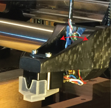

Hi Niffy,
Thank you for encouraging words!
Actually, the bearing can run ever more resistant free. The arm lifting device on the back of carriage toucheed the back part of arm slightly. This added more friction.
For this arm, I have pay great attention to its functionality as well as cosmetically. I will post all the updates in my diy air bearing arm thread later on.
The head shell turns out to be a pretty good. I sank the cut parts in epoxy first, then, sanded them. After gluing them together, I coated two more layers of epoxy. It is pretty rigid now.
For adjusting azimuth, I use two #6 brass screws. The top screw is in a short curved channel so the head shell can be turned to both sides while the bottom screw is fixed. The contact of head shell with carriage is very solid.
