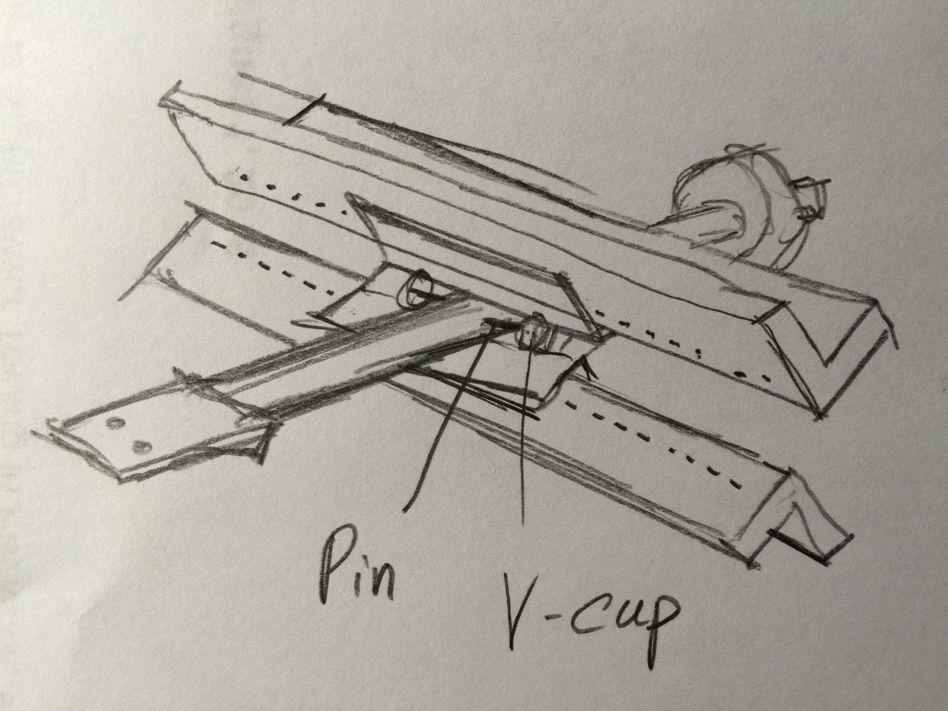

Here is an idea for you. However, it is just an idea. I can’t say it will work perfectly for sure. You need to judge by yourself if it is worth to do it. It may be beyond diyer’s capacity. The top slider and bottom slider have to be lined up very precisely.
Jim

Thank you very much for your explanation.
But practically though, the air supply will not be constant will have chattering effect. Th higher the pressure the higher this effect on the cartridge.
While it is true that the stiffer spring effect will have resonance beyond audio band, the noise of the air supply itself will be somehow picked up by the micro phonic transducer. Can this consideration be realistic?
A lower pressure arm, though suffers more on resonant frequency, which could technically be mitigated by choosing proper compliance, will have less chattering problems. Is this statement correct in your opinion?
Also another question: if you increase the mass to make it stiffer and increase air supply. Won't the equivalent horizontal mass increase as well and make vertical and horizontal mass eve more different to each other thus causing more phase distortion (assuming grooves are cut at 45deg angle)?
Stefanoo,
Jim
I will have to digest this idea.
At first glance it seems very complicated to implement. How are the two slides going to be installed so precisely. Carrier has X-shape and would have to be CNCed.
Why would this solution produce an improvement?
What is the armwand resting on? Ball bearings instead of spikes?
Btw..congrats your hand drawing skill is amazing!
