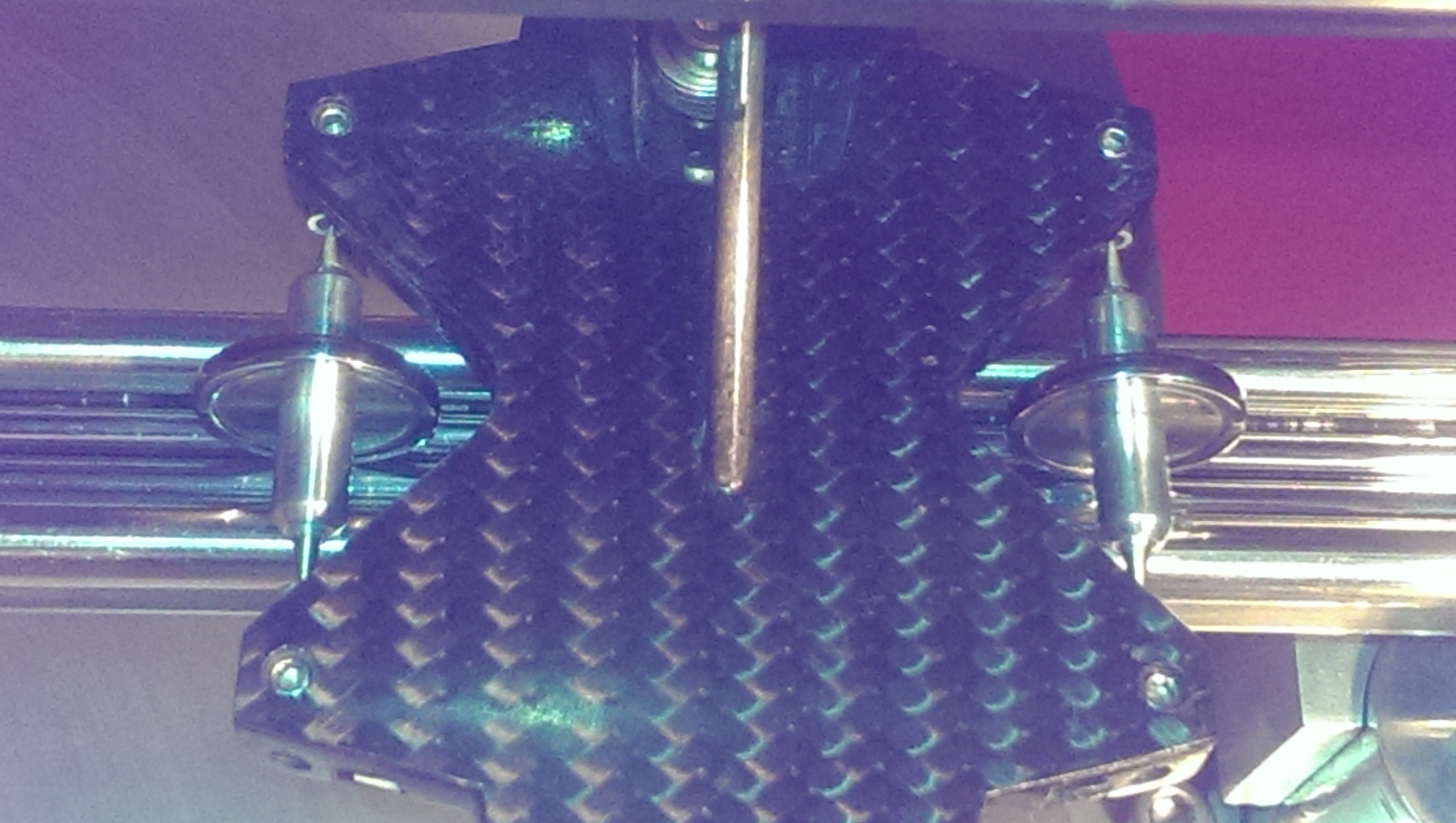

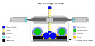

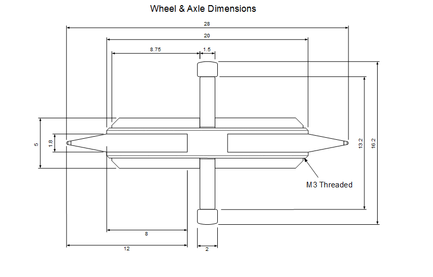

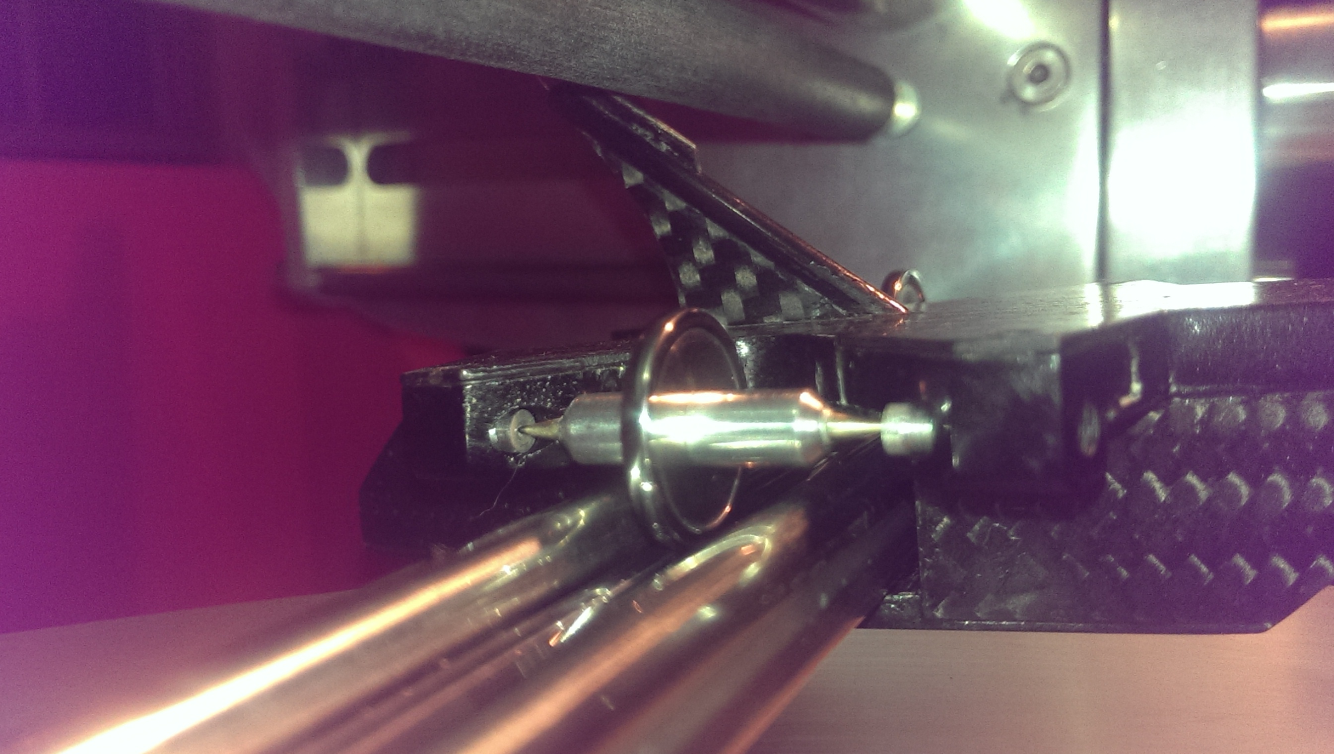

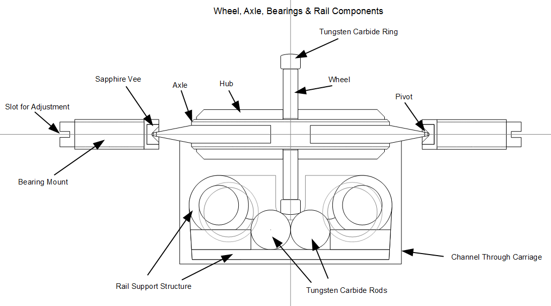

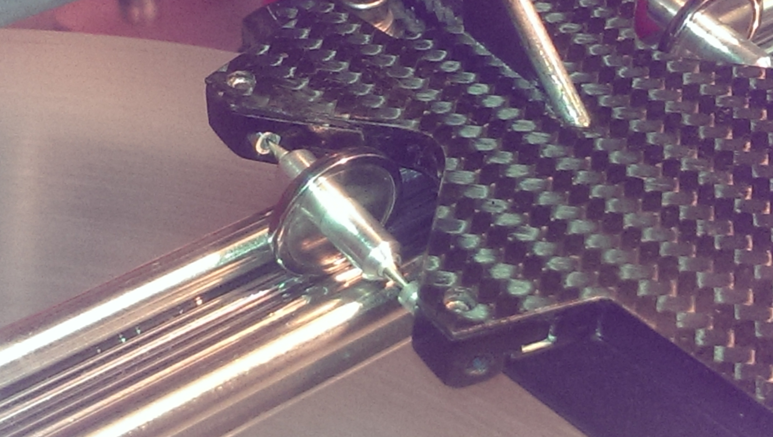

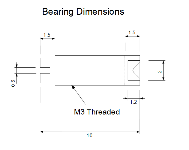

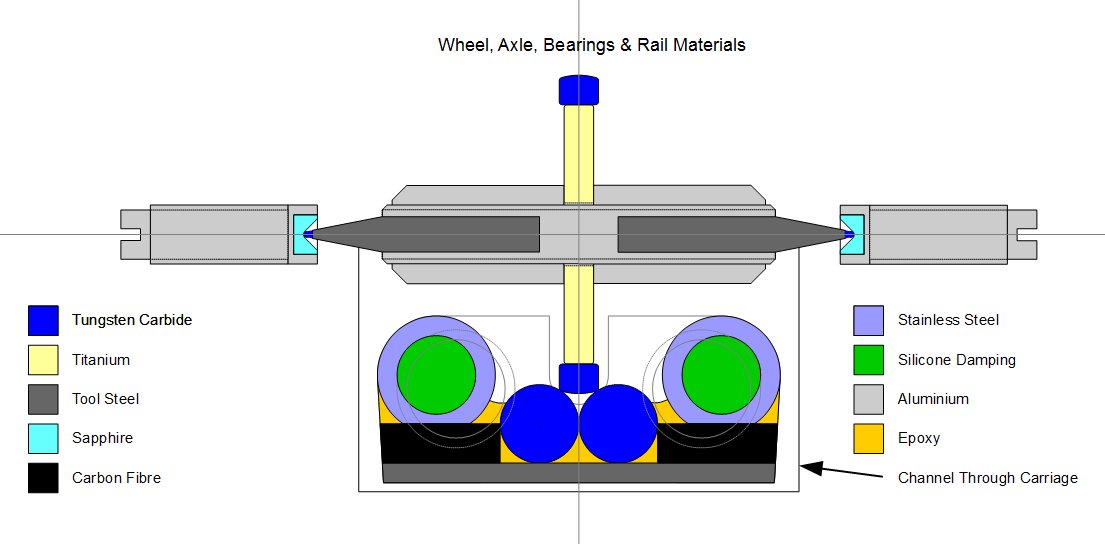

Hi all,
As promised here's some more detailed photos and drawings of the bearings.
The exact dimensions that I have shown are just the ones that I have used and there is no reason that any of the dimensions or materials can't be changed. The rings that I am using are American ring size 2 that have an inside diameter of 13.2mm. These just happen to be the ideal size for me but are difficult to find. Ring size 4 is easy to find and has an inside diameter of 14.9mm and is also available in 1.5mm width. This may have an advantage if used with 3mm rods. Similarly the total axle length is 28mm pivot to pivot. Keeping the axle relatively long helps keep the bearings rigid. There's no reason not to make them 25 or 30mm. The wheels could just as well be made of aluminium or ceramic instead of titanium. The exact dimensions and materials will depend on your carriage design.
One important point. The pivots have a tip radius of 0.125mm and the vees a cup radius of 0.25mm. I would recommend not changing this.
The pivots were purchased from true point in GB. The vees were purchased from small parts, part of Amazon in the US. The vees are actually metric but are in inches on the Amazon website.
I hope this helps.
Niffy
Hi all,
I hope this helps.
Niffy

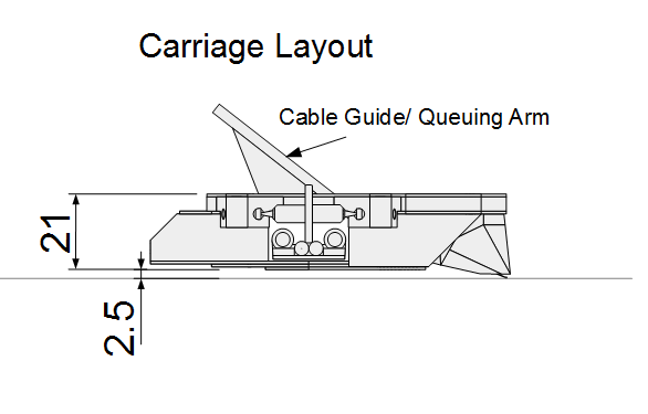

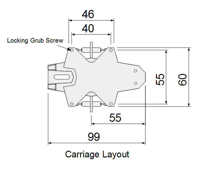

I would like to ask why you thought that assembly in the picture above was to heavy...I too am designing a linear (no air) tonearm but my question is how much 0f an effect horizontal moving mass has on the performance of a linear arm if friction is negligible in the linear path?...Considering that the centre hole is reasonably centered.
Hi Stuart,
I'm not sure if the question was aimed at me or Colin. We haven't heard from Colin in a while. Hello Colin are you still following? I don't know what your level of knowledge is so I'll start from basics and work up.
Unfortunately you can't assume that linear friction is negligible. With mechanical linear tracking tonearms the level of friction is proportional to the mass of the arm, if you double the mass of the arm the friction also doubles. The level of friction is related to the mass by the coefficient of friction (cof) where:
Mass x cof = friction
The level of friction is the amount of force required to push the carriage sideways. In these arms this force comes from the record groove pushing against the stylus. If you push the stylus from the side it will move relative to the cartridge. The amount the stylus moves is dependent upon how hard you push it and the cartridge compliance. The higher the compliance the further it will move. As the stylus moves the cantilever it rotates slightly causing the stylus to become slightly twisted in the groove misaligning it. This results in a reduction in sound quality.
Therefore lower friction results in higher sound quality.
I'll use my arm as an example. I'll round off all the numbers to make life easier.
My arm weighs 50g and my ball race bearings have a coefficient of friction of 0.006. The amount of force required to move the carriage is therefore 0.3g. This will result in a tracking misalignment, with my cartridge, of 0.75°. Which is quite a lot.
If I halve the carriages mass to 25g and still use the same bearings the force will also halve to 0.15g and the tracking error will reduce to 0.375°.
I didn't want to reduce my carriage mass but I did want to reduce the tracking misalignment. This is one of the reasons why I started investing better bearings.
With the 50g carriage but using the pin bearings with a coefficient of friction of 0.0017 the force is only 0.085g and the tracking misalignment is now reduced to 0.21°.
Having the groove pressing harder on one side of the stylus also means that the tracking force will be different for the left and right channels. If the force is much too high it may make the stylus skip out of the groove.

Hi Hiten,
The total amount of friction is made of two components. The friction of the pins rotating in the vee cups and the rolling resistance of the wheels rolling on the track. About 20-25% of the total friction is due to the pin bearings and the remaining 75-80% is due to the rolling resistance. By using the best possible materials and design I have reduced the level of friction from each component to an absolute minimum. I doubt that it is possible to reduce the total friction in a mechanical linear bearing much further.
Unfortunately most records are not perfectly concentric so the carriage has to constantly move back and forth. Any biasing system would have to constantly sense which direction the bias was needed in and change the direction of that bias back and forth. Several manufacturers of linear tracking arms have built such arms, they are known as active linear tracking tonearms. Unfortunately the sensing and bias mechanisms normally create more problems than they solve. There are a couple of exceptions but they are all in the mega bucks price range.

Isn't a very small coefficient of friction necessary at the wheel/rod interface? I haven't run the numbers (nor am I especially qualified to do so) but it would appear that as one approaches zero friction, the wheels would slide rather than rotate. It also seems to me that one would want slightly greater friction at the wheel/rod interface than at the pivot bearing. If true, then there is a very small, optimum coefficient but not zero.
Hi Seth.
For lateral motion the coefficient of friction between the wheels and rods is unimportant. The wheels do not slide laterally at all, they roll. Even if the coefficient of friction was a tenth as much the resistance to sliding would still be much higher than the resistance to rolling. The coefficient of friction between two pieces of polished tungsten carbide is 0.15. The total coefficient for the entire bearing system is only 0.00177. As long as the sliding resistance remains above the combined rolling resistance and torque due to the friction of the pin bearings no sliding will occur.
For vertical motion the wheels do slide on the rods. The relatively low cof of tc on tc combined with the very small amount of vertical movement at the bearing means friction is very low.
A small amount of friction is useful in that it acts to damp the motion of the carriage. However if you did have a zero friction bearing you could easily damp the carriage by other means.
