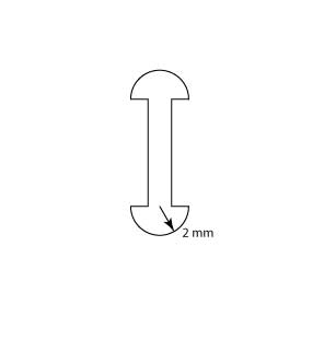

Hi Niffy,
For your arm’s rail, I have a suggestion. Please see the drawing. If the edge of the wheel is 2 mm in radius. Then, even if the wheel swings front and back, its parameter with the rail will not change. And, VTF won’t change either although VTF may not change too much on your existing wheels.
Jim
Hi Jim,
After you made this suggestion and I replied I have been thinking more deeply into this approach. I may have replied too hastily.
When using ball race bearings I aimed to keep the contact angle between the edge of the bearing and the rods low, about 20°, as this helps to minimize lateral friction. As vertical movement is accommodated by the play in the bearings the effect of this low angle on vertical friction is not an issue.
With the pin bearings all of the vertical movement is accommodated by the wheels sliding on the rods. Keeping the contact angle low in this approach has the negative impact of increasing vertical friction. In order to keep the vertical friction as low as possible without negativity effecting the lateral friction too much I have increasing the contact angle to 40-45°. In your suggested configuration the contact angle would be 30°. By reducing the width of the wheels to about 2mm the contact angle would increase to about 42°. This would alleviate both of the problems that I proposed. The increase in wheel mass would be much smaller, 0.6g per wheel, and the vertical friction would be much the same as it was with the 1.5mm thick wheels with 0.15mm radius edges.
I have crunched some numbers and came to a compromise design that uses 1.5mm thick wheels with a larger 0.5mm radius edges. This will maintain the same wheel mass. The contact angle is almost exactly 45°. This should have almost identical lateral friction to my previous design but may help to reduce vertical friction by as much as 15%. By increasing the wheel edge radius the area of the contact points between wheel and rods will have increased and in doing so will have reduced contact pressure. Whether this is beneficial I am unsure.
I have made these wheels and fitted them to my arm. It is only a small physical change and may have had an effect on sound quality but any change is so small it is difficult to be certain.
Thanks for your input. Any further insights or suggestions are always welcome.
Niffy
Hi Niffy,
I am glad it helped.
In order to reduce the mass of wheels, you may make the wheels as my drawing. I know you have access to a lathe so it is not a problem to make such wheel. I always wish I could have this kind of machinery. However, yours is only 1.5 mm thick, I don’t think it will make too much difference though.
Speaking of sonic effect, I think it won’t make too much difference. It is all about better controlling the behavior of the carriage.

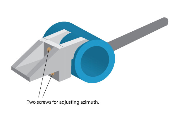

Hi Niffy,
Thanks for replying!
The all carbon fiber carriage I am planing to make is for 1” Newway air bearing linear tonearm. Please see the drawing. So far, it is just a rough drawing. I may try to make it a bit nice looking.
No. I haven’t done any calculation of vertical and horizontal mass yet. In fact, I am not sure how to do it. I guess they should be almost same since the air bearing is frictionless vertically and horizontally.
My main goal for the all carbon fiber carriage is to make it as simple and rigid as possible. I have the feeling that the carriage can be too light if it is all carbon fiber. Therefore, I already thought about how to add some mass to the carriage. I have some 2 mm thick lead sheet left. If needed, I may add some mass to the bearing by covering the bearing with lead sheet.
Jim

Hi Jim,
The drawing of your proposed carriage looks great. Pretty much an H beam and should be extremely rigid, especially if fabricated from 3/8 carbon fibre. I would suggest making the rear section, that supports the counterweight, in a similar fashion to the front.
Increased mass can have beneficial effects. Depending upon your cartridges compliance there will be an ideal mass for the entire carriage. I believe that every gram of this mass should be used in a way that improves the rigidity and damping characteristics of the carriage. I call this total mass the mass budget and aim to spend every fraction of a gram in the most economical way. Adding lead will increase mass and damping but will not add rigidity. Thick sections of carbon fibre in the small sizes your drawing suggests they will have excellent self damped. Increased rigidity results in higher resonant frequency. Higher frequencies are easier to damp. Your proposed design should require no additional damping material.
The lateral effective mass is the mass of the entire carriage including cartridge and counterweight. If I recall correctly your cartridge has a compliance of 15um/mN. I reckon a total mass budget of between 70g and 140g covers the ideal range. This gives a lateral cantilever resonance of 5hz to 3.5hz.
The vertical effective mass will not be the same as the vertical and should be much lower than the lateral. Again for your cartridge, and taking into account your excellent record clamping system, I would aim for 17g to 26g. This will give a vertical cantilever resonance of 10hz to 8hz. This is lower than the normal recommended range as you have pretty much eliminated record warps. I have explained how to work out vertical effective mass in Kevinr's souther arm on a thorens thread which I believe you have posted in. I can repost it here if that is better for you.
Happy building.
Niffy
