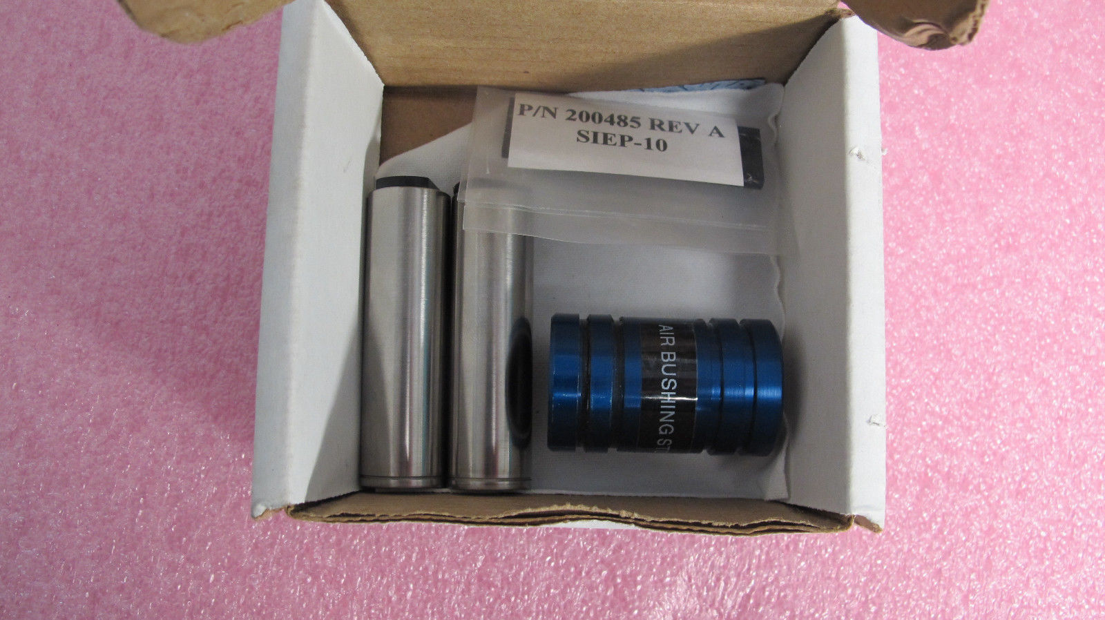

By the way, I recently bought a 20 mm air bearing off ebay. It is not expensive, USD$50 with two short shafts. I paid USD$280.00 for my 3/4" air bearing and $100 for a 225 mm long shaft. I am thinking to make air bearing uni-pivot tonearm although I am a firm believer of linear arm. For others, it may be too much trouble. It is not for me because I have a complete compressed air supply. What I have in my mind is to do something like Kuzma 4 point arm but with air bearing as the vertical bearing and two jewel bearings as horizontal bearing. I may experience using silicone damping fluid for anti-skating.
Jim

btw. I wonder why You showed the blue air bearing in the same thread You plead for lowest friction :scratch2: ... the necessity of a air supplying hose -which stiffens under air pressure- contradicts Your claim 😛
Also, it's drag upon the slider isn't constant between outer and inner groove.
Clearly that can't sound decent at all 😀
Showing the new air bearing was a friendly side chat with niffy. There were no other reasons if you are curious. Yes. Air tubing does produce certain level of damping on this kind of air bearing arm. My air tubing choose is probably the most flexible available. It is 1/16” latex tubing. Latex tubing can’t resist high pressure. However, it doesn’t contradict my opinion at all.

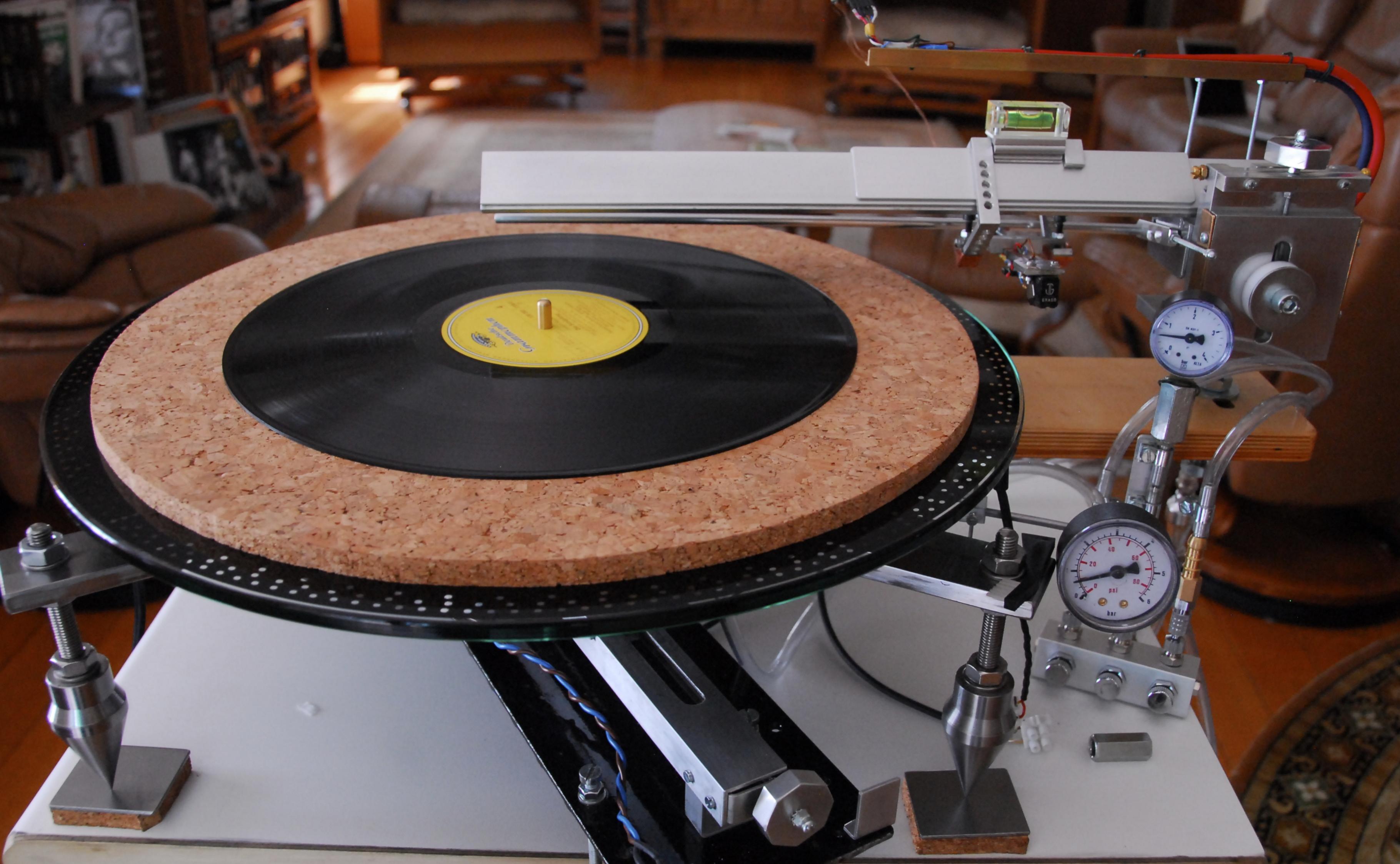

Niffy’s post involved serval important topics about tonearms. I would like to express my thoughts here as well.
1. Linear vs. Pivot.
For me, using pivot arm is not logic in theory. As we all know how LP is made, the cutting head moves in straight line but playing back a record does differently. There is no theoretical base for that. The only reason for pivot arm is its practicability.
Sonically, I have no doubt that linear arm is superior to pivot arm. The clarity you can get from a linear arm may never achieve through a pivot arm. I have seen a lot of people complained that bass performance on a linear arm is not as good as it on a pivot arm. This is completely misleading. The linear arm these people talked about must be some of poorly designed linear arm. Bass performance on a linear arm can be vastly better than it on a pivot arm. By saying that, I don’t mean a well implemented pivot arm can’t sound good. But there are very very few good pivot arms can sound as good as linear arm and linear arm is the shortcut to sonic nirvana.
I have both Graham 2.2 and VPI JMW tonearm. My current air bearing arms are vastly better than these two pivot arms using same cartridges and same table.
So, what are the reasons for linear arm outperforming pivot arm? Niffy thinks one of reasons is shorter arm wand. I agree that it may be one of reasons. However, I feel it may not be as critical as we may think. My personal feeling is tracking error plays a major part. Everything is in the tracking error. A well implemented pivot arm minimizes the negative impact of tracking error. A poorly implemented pivot arm amplifies such impact.
In reality, adjustment of cartridge on a linear arm is very simple and straightforward. It is not same on a pivot arm. This adds more uncontrollable variable into the equation of linear vs. pivot.
2. Air bearing vs. others.
Niffy thinks a design where both the vertical and lateral movement of the carriage is accommodated by the same bearings is the most elegant solution. I can’t agree more. Air bearing meets such requirement. For ball bearing arms, in my opinion, some meet this requirement while some don’t because ball bearing movement is directional. Let me take Cantus arm and Clearaudio’s arm as example. Clearaudio’s arm meets this requirement because they use convex ball bearings. I can’t say the same for Cantus arm. Cantus arm does not meett this requirement 100%.
I would like to take this chance to express my opinions about two kinds of air bearing arms.
THE TERMINATOR TONEARM
The bearing is not stiff enough and it has too many loose parts. A good designed arm should be compact, simple and rigid.
MG-1 By Advanced Analog
The bearing on this arm isn’t stiff, either. The mass of its carriage is too low. To my experience, ideal mass for a air bearing arm should be 70-110 grams.
Although I expressed my opinions about these two arms, they may still sound good to some people.
3. Active vs. Passive.
For active arm, I think the key is its tracking system. If the tracking system is too precisely as for ELP Laser turntable, it will be against the principle how a cartridge works. If its tracking too loosely, it won’t do the job right. And, active tracking is always post-tracking. There are also noise problem, etc. I saw there was an active arm on this year’s High End Audio Show. It looked nice though. I think if it is well implemented, it may sound nice, too.
Some of you may know I bought a Rabco active arm from eBay. The arm was in working condition. The arm is very poorly designed by today’s standard. I completely lost my confidence to further mod the arm. So, I sold the arm.
