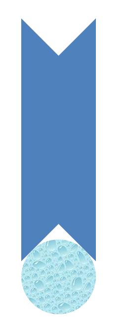

I have already successfully built an air bearing type tonearm I have used for about one year. It worked fine but I wanted something new... And this is how I found this thread.
My initial design goal was a pair of U shaped bearings riding on a stainless steel rod, but I've learned reading this thread (among may other things) that 4 POC are better than 2 and glass is better than SS 😉
I have one question though: has anyone thought of (or even better, tried) a pair of V shaped bearings riding on a single glass rod?
This would keep the 4 POC concept in place and would use a single glass rod instead of two, making good use of the KISS principle mentioned extensively in this thread 🙂

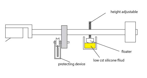

I think it works, but you need to add some kind of protecting mechanism to prevent the cartridge dropping off the glass rail. Most of linear tonearms here don’t have this kind of mechanism, therefore, I used C type glass rail. The ball bearings move inside of glass tubing.
There are no doubts in my mind that 2 points of contact is better than 4 points of contact. Any 4 points of contact tonearms will cause VTF changing while the needle travels. I have been thinking this for a while, here is the proposal which may work. I can’t tell for sure if it works fine or not unless I actually build one. However, I don’t think I will build one in the foresee future with two air bearing tonearms in my hand.

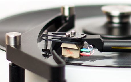

The only commercially available tonearm using the silicone damping trough trick that I know of is the Rock 7 from Townshend. But please note that according to them, the submerged paddle must be placed as close as possible to the cartridge in order to get the full bass improvement expected. Of course, you'll easily notice this is not the most record changer friendly solution... 😉
Townshen’s is for pivot tonearm. Mine is for linear tonearm. They are different although mine has damping function as well. Mine also provides third supporting point for the arm. So, with two supporting points from the v-groove bearings, it forms a triangle to keep the arm balanced. Damping is secondary because the paddle floats on the surface of silicone fluid and doesn’t sink in the silicone fluid. The third supporting point may also reduce the fiction of bearing since it may reduce the mass of arm.
But wait a minute... Wouldn't the floater pose a huge rise in VTF for each "hill" in a warped record? Remember what Archimedes said about the force pushing upwards an object submerged in a liquid... With a floater, it is not only the viscosity of the fluid that matters but mostly its density!

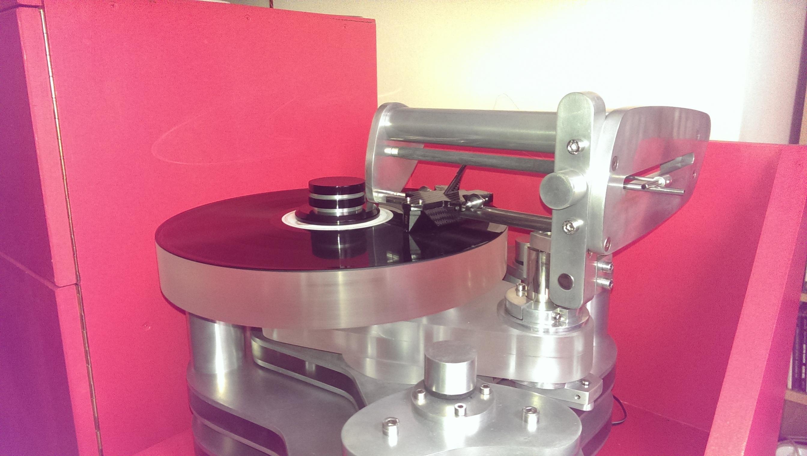

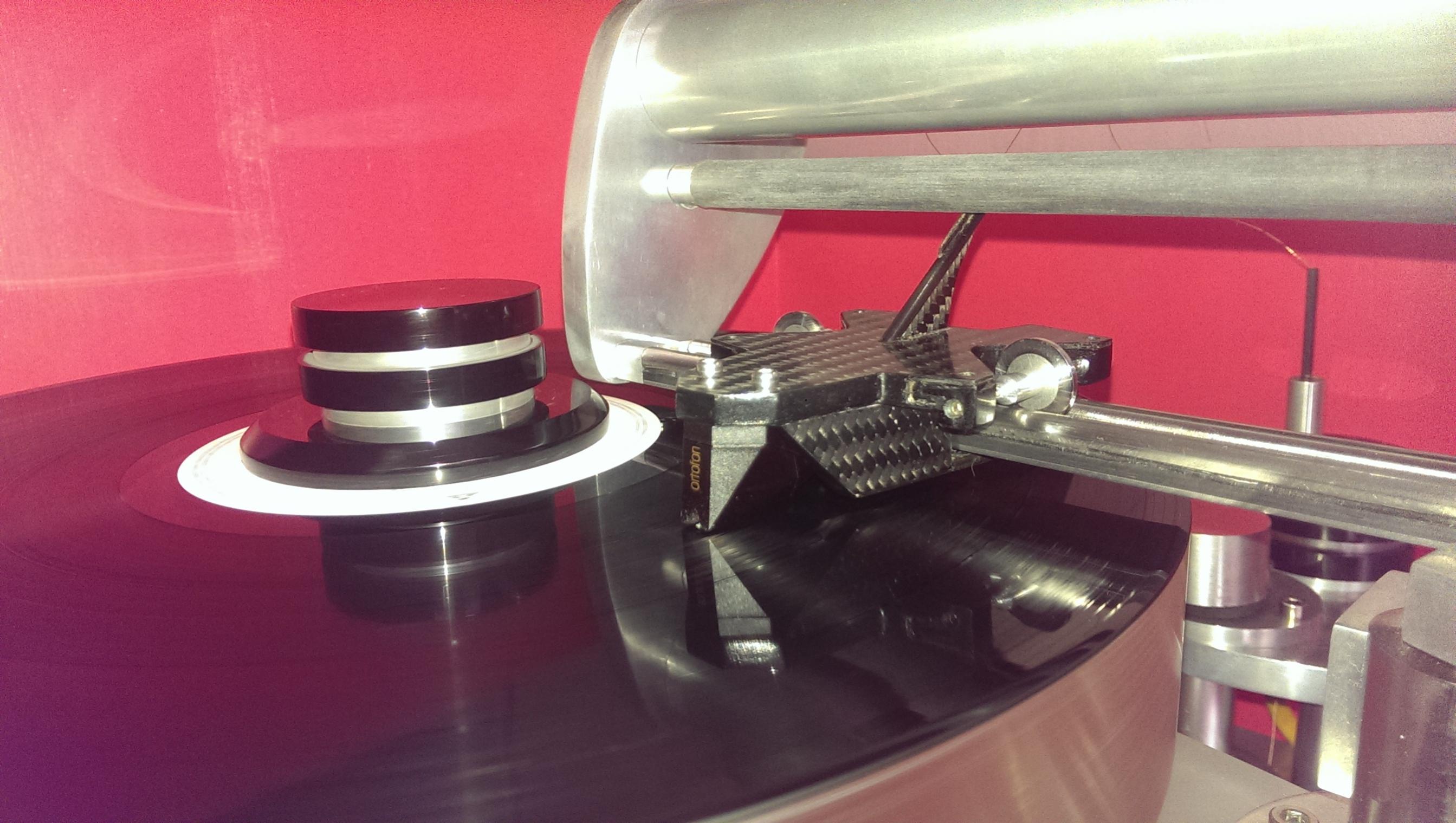

Hi consty, Hi Jim,
Recently I have been heavily involved in developing a better mechanical bearing design. As part of this I built a rig to measure actual lateral friction on which I have tested many different configurations. The best couple of these have been fitted to my arm and listen to. So far this experimentation is looking very positive and improvements in sound quality over the dual rod two bearing design has been achieved. I have built and tested both of the designs you have suggested. When testing I take hundreds of separate measurements and plot the distribution. This reveals a lot about the behaviour of the bearings but to try and keep this post reasonably short I'll just present the mean coefficient of friction for each type tested.
My new design is reverting to the use of pin bearings, similar to those used in clocks are watches, and am therefore not using the ball race type bearings. These are, I admit, considerably more effort to make and set up. Theoretically pin bearings should have several advantages. They should have lower friction than ball race bearings. As they have no loose unloaded balls bearings chatter will be eliminated. The carriage will be supported on what are essentially four spikes, similar to those used in speakers and equipment isolation supports, leading to ideal mechanical grounding. The pin bearings I am currently using are really basic. The pins are made from sewing pins with the ends rounded and polished. The vee cups are made from stainless grub screws with the cups punched and polished. Once the best wheel/rail configuration has been determined these will be replaced with tungsten carbide pivots and sapphire vee jewels.
The test rig has the bearings set the same distance apart as in my arm carriage with the load appied at the same location relative to these as the stylus in order to give as realistic a result as possible.
As a baseline I have measured the friction of two different types of ball race bearings on a dual rod rail.
The first tested were full ceramic zirconium oxide. These had a mean lateral coefficient of friction of 0.01. The other bearings were Boca silicon nitride hybrid. These had a mean coefficient of friction of 0.006, a 40% improvement. Both types are almost certainly better than the standard grade used by most contributors to this thread but as I haven't actually tested all types this is conjecture. The Boca bearings definitely had the edge on sound quality.
The design suggested by super is a knife edge design. This design should have minimum vertical friction so a damping system as shown in the diagram is needed. Bo Hannson moved away from using knife edge design in the cantus in order to increase vertical friction which acts to damp the arm, making the damping trough unnecessary. Using a knife edge design with ball race bearings has another disadvantage. With the dual rod ball race design the vertical pivoting of the arm is accommodated by the play in the ball race, the vertical pivot is aligned with the lowest balls. With the knife edge you have a second pivot where the wheels touch the rail. Having two different pivot points is unstable. I tested a knife edge design with pin bearings so I only had a single vertical pivot. The mean lateral coefficient of friction with this design was 0.0097, not as good as the best ball race bearings. I did not pursue this design further so cannot comment on sound quality.
I also tested the design as suggested by consty. Again this used my pin bearings. The rail was a single 4mm glass rod. The wheels were 15mm in diameter with a 140° V groove and 3mm thick. The shallow V was selected to minimize friction. This design resulted in a marked reduction in lateral friction with a coefficient of friction of 0.0051. The vertical friction was, however, noticeably higher than the ball race type. I have not built a rig to measure actual vertical friction but a simple pendulum test shows that it is about three times as much. When testing this design I used my spare dual rod rail and just ran the wheels on top of one of the rods, saved me having to make another rail just for this test. My dual rod rail uses two 4mm rods which are separated by a 1.5mm spacer.
Whilst testing this design I inadvertently knocked the wheels so that they ran in between the rods, similar to how the ball race bearings run. I immediately noticed that the test carriage seemed to run more smoothly so I retested with the wheels in this location. The lateral coefficient of friction dropped to 0.0044 and the vertical friction dropped by a similar amount. A serendipitous discovery. These wheels were made of aluminium. Using a harder material for the wheels should decrease rolling resistance so next I made another set of wheels from stainless steel (316) and tested these. The friction dropped again quite dramatically to 0.0035. The vertical friction also dropped slightly but was still notably higher than with the ball race bearings.
I built a new rail to accommodate these new wheels and fitted them to my arm and sat down to listen. Remember that they were still using my crude home made bearings. The improvement in sound quality was subtle but immediately noticeable. The separation between individual instruments improved giving a greater sense of air. Fine detail improved as did what many call prat (pace rhythm and timing). However the high vertical friction did cause some issues. So next I built another rail but this time with the 4mm glass rods touching and new wheels, again from stainless steel but now only 1.5mm thick. These tested the same in lateral friction, 0.0035, but had half the vertical friction (confirmed by theory and testing).
These new wheels resolved the vertical tracking issues and the sound seemed to take another small step forward.
In my opinion the improvements in sound quality are mainly due to the elimination of bearing chatter, though improved grounding and reduced lateral tracking error due to friction will play their part.
My experimentation is on going. The addition of quality pivots and sapphire vees will almost certainly help. I have also been given some tungsten carbide rods by fellow diyaudio member hottattoo that I am very excited to experiment with. The extreme hardness of this material should reduce rolling resistance further. Thanks hottattoo.
My experiments do suggest that the current dual rod rail design is actually superior to either the knife edge design as suggested by super or the V groove wheels as suggested by consty.
Here are a couple of photos showing the current setup.

Hi Niffy,

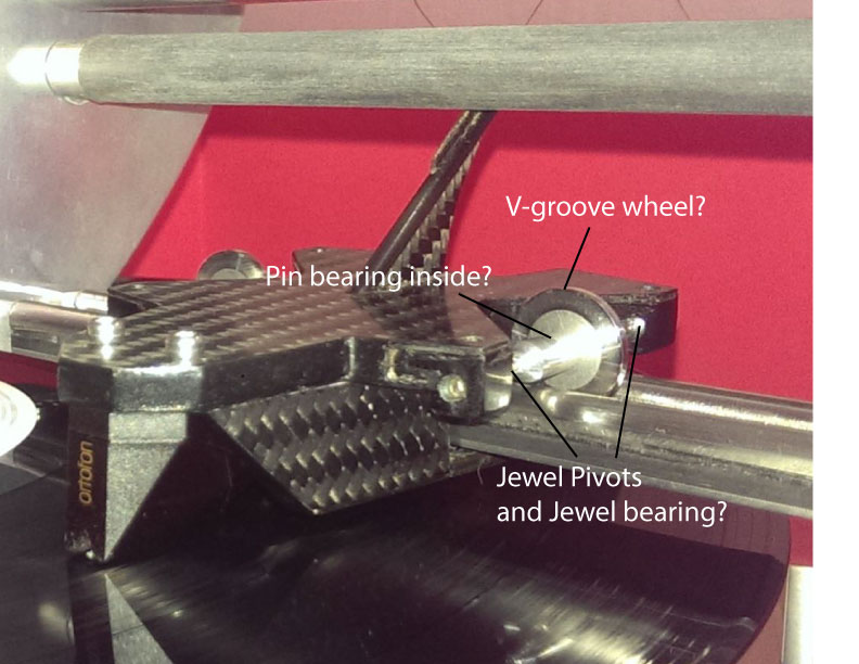

First, I am trying to understand the construction of your tonearm. Please see the attached photo. So, the wheel moves in between two rods. From the picture, it seems to me that the wheel has v-groove. Correct me if I am wrong.
Speaking of my proposal, if I understand it correctly, Bo Hannson’s so called knife edge means that the edge of outer ring of a ball bearing touches the glass rail. It will generate damping. I don’t know if he did same design as my proposal. But, I don’t believe his proposition personally. Clear Audio uses convex ball bearing. Convex ball bearing can generate damping, too. You don’t need a regular flat outer ring bearing to produce damping. In the meantime, a flat outer ring bearing will change VTF. Convex ball bearing may change VTF, too, but not as much as flat outer ring bearing.
In your knife edge rail and v-groove wheel test, what kind of rail you used? I think the rail should be stainless steel or carbide blade. I think the friction will be reduce greatly.
Jim

Hi Jim,
I've knocked up a diagram on my computer this morning but could not get it to convert to a format suitable for posting on this site so I gave up and photographed the screen, sorry for the low quality of the image.
As you can see there is no V in the wheel. The edges are radiused slightly, about 0.15mm.
I have tried the knife edge design several times in slightly varying styles and all seemed to have the same problem of excessive lateral friction. The knife edges were stainless steel in all cases. One of things that is important in a knife edge design is not to make the edge too sharp as this causes the contact pressure to be very high, exceeding the elastic limit of the materials used resulting in binding. The wheels also work better if the groove in the wheel is a V rather than a U shape. The small radius of the knifes edge then has two contact point, one on each side of the V. If the radius of the knife edge is small the distance between the contact points will be very small. My current design is in a fashion a knife edge design. Instead of the knife edge being the rail the edge is the wheel is and the V is formed between the two rods that make up the rail. My current wheels are similar to a large radius knife edge but with the excess material removed leaving only the portion that actually contact the rail. The effective radius of my current knife edge is 1mm. This may seem quite large but the amount the wheel has to slide over the rods is still very small. For the arm to pivot by 1° requires the contact points to move by only 0.015mm, that equates to a record warp of 1mm. With my record clamping system that's about 5 times as much as I ever see. As the movement is so small variations in tracking force will be insignificant, less than 0.5% (rough calculation)
In a way my design is half way between your proposal and that of Consty. The main difference being that in my design the V is the rail instead of the wheels.
One idea that I am contemplating is to use rods that are 2mm diameter for the rail and make the wheels 0.8-1mm thick. This will reduce vertical friction by 40-50% whilst keeping lateral friction about the same. Basically moving closer to a true knife edge. One thing I have to be careful of in this approach is not to make the wheels too narrow (knife edge too sharp) as this causes the lateral friction to increase. I think that an equivalent to a 0.5mm radius edge is probably the limit.
I hope this clarifies things. Any insights or ideas on how to further develop this idea are of course always welcome.

Hi Niffy,
I understand it now. Thanks for the drawing!
It surprised me a little that pivot bearing has less friction than ball bearing. I didn’t expect that. It can be design dependent. If pivot bearing has less friction than ball bearing, there is no question its sounding will be better than ball bearing. If I were you, I would definitely use sapphire vee jewel bearing.
Furthermore, I looked my proposal. If I replace the shaft for v-groove ball bearings with a jewel bearing, and make a small wheel to fit inside of outer ring of v-groove bearing, I believe it will perform even better if pivot bearing has less friction.
Jim
