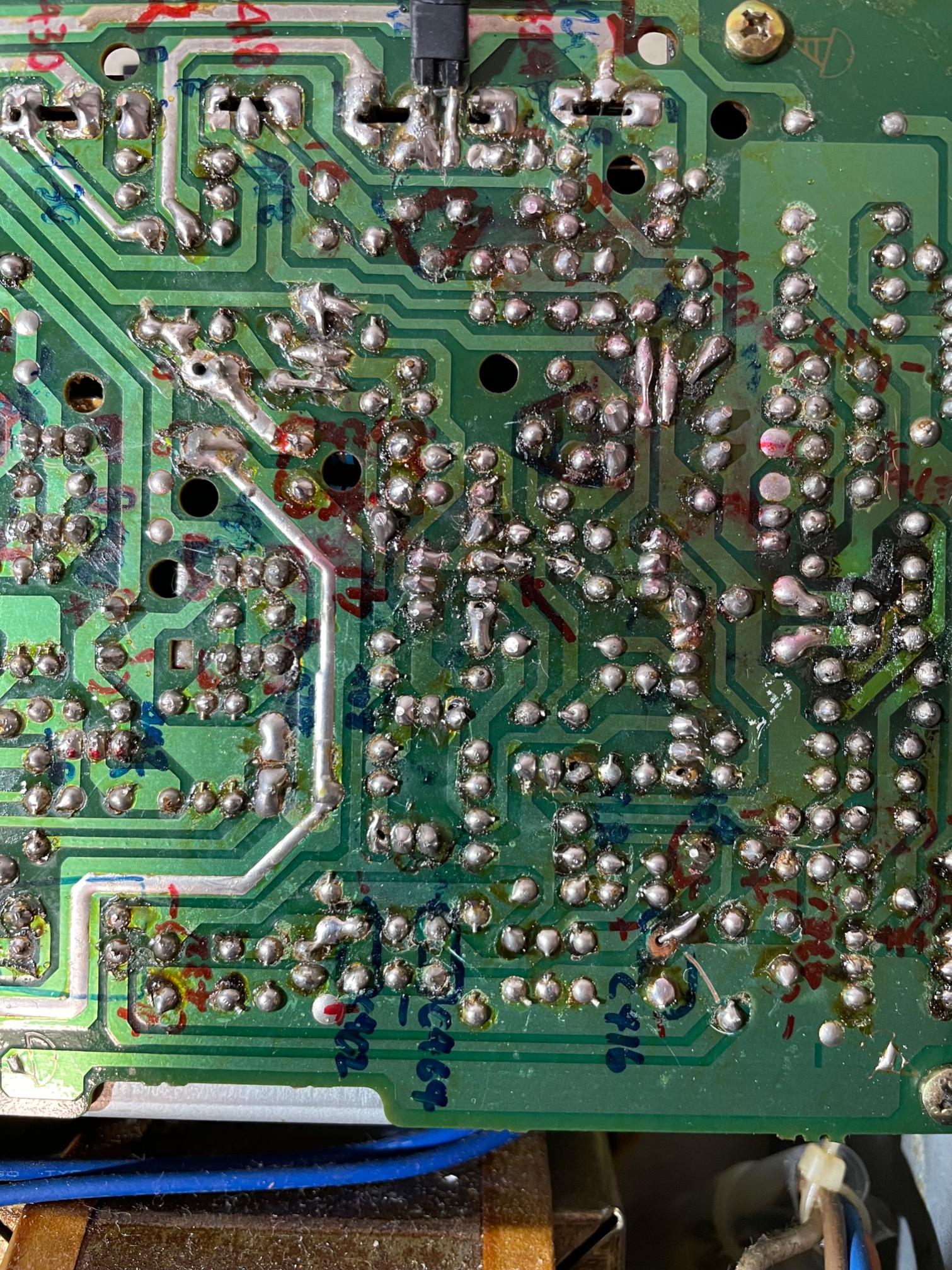

R Channel root defect - break in PCB track
Dear all,
Defect in R channel high DC offset is due to a break in the PCB track, from the bases of Q412/Q416 to R442. I discovered it by chance when checking for continuity after replacing both transistors.
This was after futile attempts (changing zener diodes, BD501, all low power transistors - 2SA970s & 2SC2240s).
After bridging with a component lead (see photo, break is at the track indicated by a red arrow).
This brings a good closure to this, after more than a year!

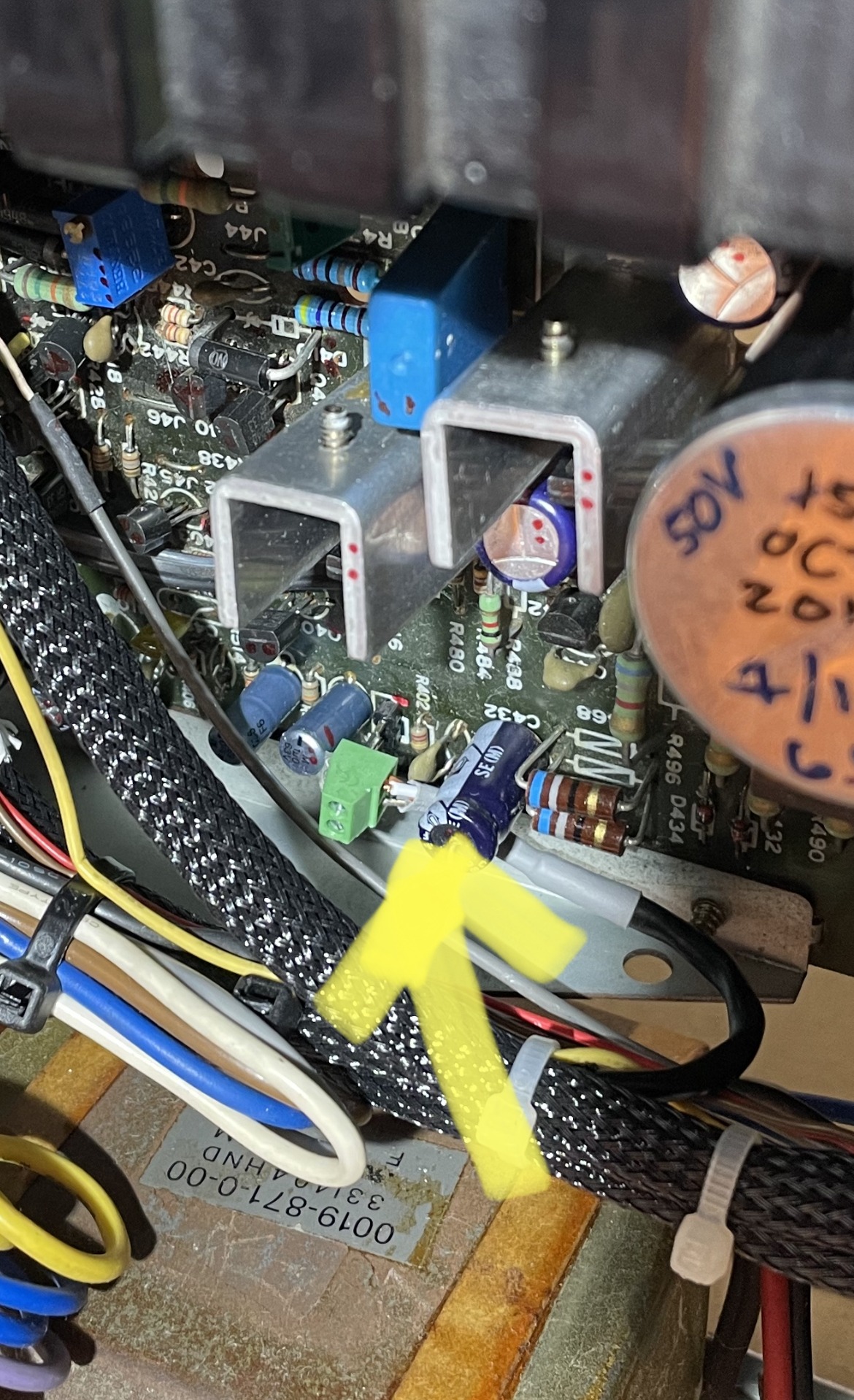

Dear all,
I managed to nail down the R channel intermittent issue to the PCB pre-amp to power amp connector, which I replaced (see photo with yellow arrow). The contact was having high resistance.
I ended replacing the L channel too. I’m confident I resolved all the R channel issues finally (I now know for sure!).
Happy New Year all!
