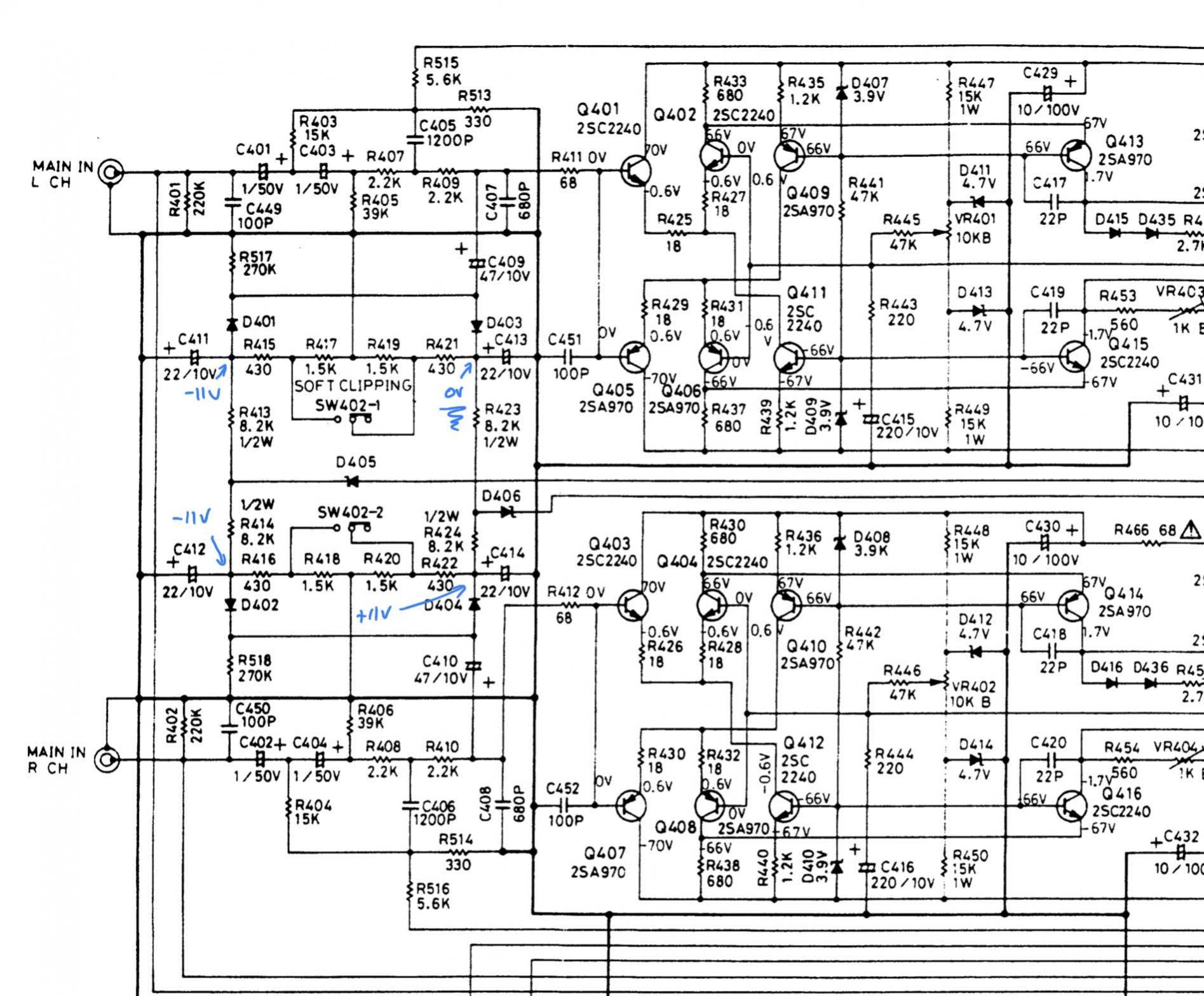

Both outputs are <10mV offset straight off, so I threw a sine wave in and looked with the CRO (no load). Lovely output on both channels, with no sign of clipping until I hit the ~70V rails.
Looking with more detail (spec-an) I've got harmonics suppressed ~90dB (10V out) on the right channel, but only ~40dB on the left. I suspected there might be something wrong with the soft clipping circuit, so tried turning soft clipping on and off. Interestingly the distortion disappears for thirty seconds or so after I switch the soft clipping switch off, but then returns.
I'll go have a good look at schematics, but my guess is that it's a leaky cap between pre-out and power amp in, much as what was causing the mute issues on my other one.

That was a straightforward fix. I went probing around the soft clipping circuitry on each side, and found the +ve supply for the left channel soft-clip was 0V rather than 11 for the right channel, and -11 for the -ve supplies on each channel.
I initially figured C413 had gone closed circuit, so swapped it out, but no joy. Turns out R423 was open circuit. Absolutely no signs of anything amiss visually, but tested >1M out of circuit.
So swapped in a replacement and now both channels have distortion products lower than -90dB at 40V RMS out.

Before you do anything else, check C416. If the output had +32 V on it, this part (a 10 V electrolytic) is very likely toast. The 2SC2240s and 2SA970s are rated 120 V C-E, they probably would still just about hold up even if subjected to full rail voltage (up to 140 V).
Another common kind of defect would be the feedback resistor, R470, 18k 1/2 W. If that is bad, DC offset would skyrocket. Linearity for this part is rather important, so it should be a metal film.
Check all of Q403/404 and 407/408. It's often the ones on the feedback side that suffer damage. If any of them have to be replaced, note that you must do so in pairs (i.e. 403+404 or 407+408). The transistor pairs should also be thermally bonded (using epoxy, wire or whatever else may already be there).

It looks like there is a schematic discrepancy between the images at the start of this thread posted by BentMike and the images in the NAD-3240PE-int-sm.pdf service manual that is on-line.
R466 is shown in the service manual schematic as feeding Q420 collector as well. My pcb follows this schematic (not BentMike's), so I'd also check Q420 and Q424.

There is an error in the clean version of the schematic. With regards to R466 the left channel (R465) is correct, the right channel is not.
In post #46, suzyj may not have been aware of that schematic error and only assumed a failed Q403 could have caused a burnt out R466. Were your Q420 and Q424 ok then, given R466 was burnt out ?
