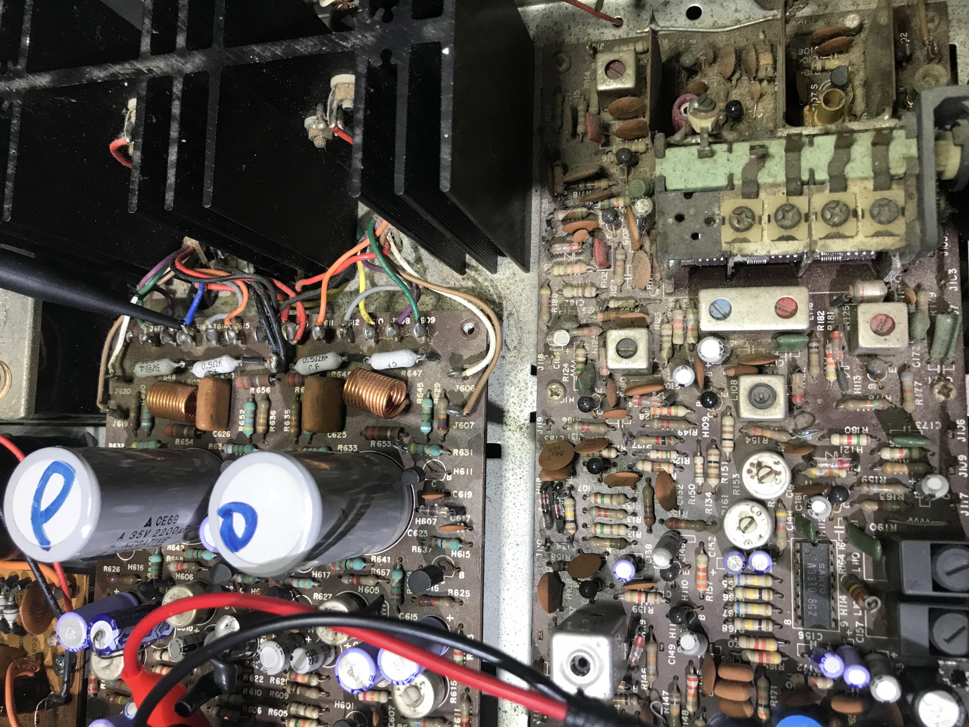

My 3240PE arrived through the week, and I just got home to have a play. The output from the pre is down ~40dB from what it should be. One side of the power amp appears to work quite nicely, the other side is missing it's PE bit on the positive side - that's the weirdest clipping I've ever seen (note it's divide by ten).
Oh, and it's filthy. Bloody smokers. I think before I progress much further I'll give it a thorough wash.

Just isopropyl and a little scrubbing brush, then mopping up the gross stuff with cotton buds. It’s a lot cleaner than it was but by no means good yet.

I ordered new trim pots, as I couldn’t adjust the bias or offset. With the new trim pots I still couldn’t set the bias in one channel. Turns out the Vbe multiplier in that channel had popped. Luckily I had a spare 2SD669 for replacement.
So that’s it. I promise. A whole bag of new caps, some replacement transistors, and new trim pots. It’s better than new now.

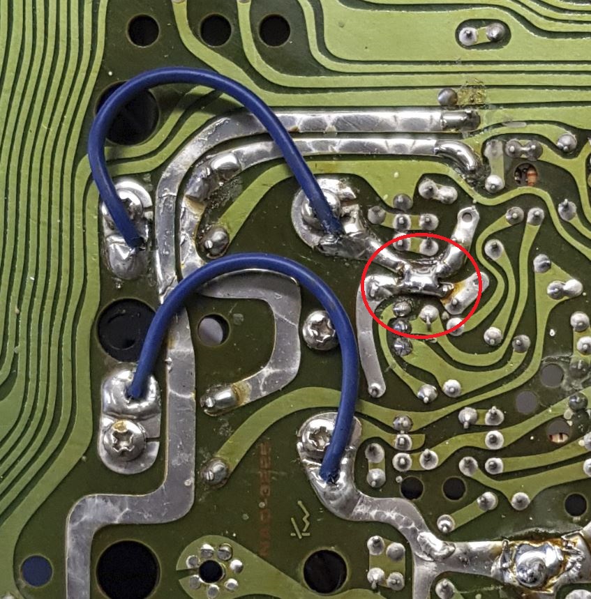

A question on idle current adjustment if you have a moment. Service manual calls for solder bridge removal on R471/R472, and then replace solder bridge once adjustment done. Can you confirm what this solder bridge looks like? Is it simply a solder trace between the resister leads? This unit was doctored in the past and I can't be sure it was bridged correctly. I can't find a reference pic anywhere.
Hello Mark,
I've found that in the NAD, the solder bridge tends to look like a nasty blob across two traces (pic attached of a 3225PE).
Once you have sorted your bias out (remembering to allow plenty of time for the amp to warm up and stabilise), make sure you resolder the bridges!!!
I found out that it is easy to forget after reassembling the amp, only to have to strip it again to replace the vaporised 1 ohm resistors!!

Yup it was just a couple of pads bridged, though on one side of mine a pad was missing due to some really crap soldering. I mounted some 1Ω resistors underneath, replacing the ones on the top side, and then bridged across the resistors themselves.
