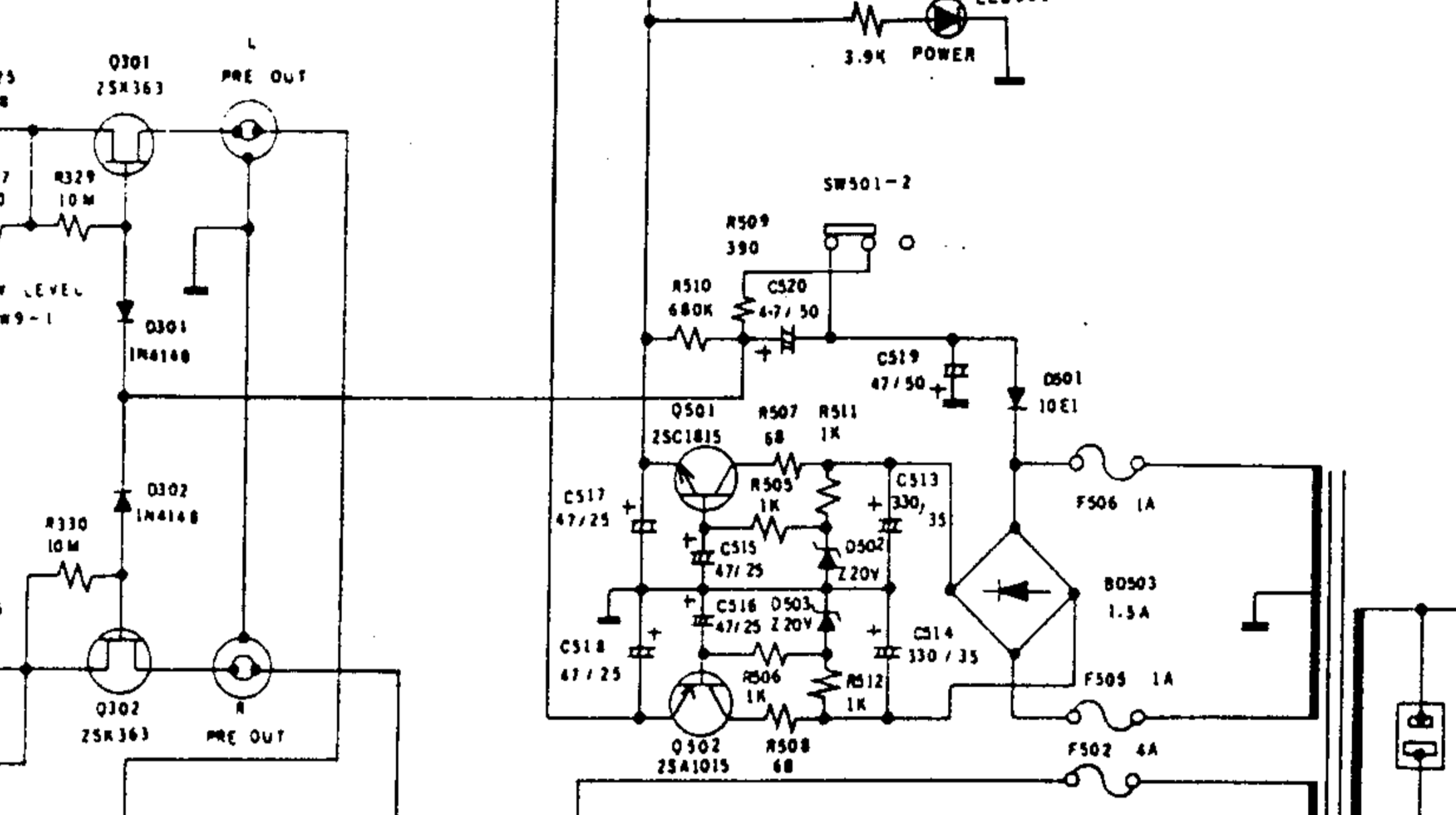

Hi All,
I posted earlier that I have readable schematic for this NAD 3240PE. I am happy to share that, if anyone want a copy.
Now I have to try to solve the problem - the right channel doesn't respond to the balance adjustment as it should.
The amp sounds very nice, completely noise free when nothing is playing. IF I turn the balance knob all the way to the right and then just a little left to get some left channel going I can turn it up and get very pretty sound, but the right channel has only a tiny fraction of the left channel power.
If I take the Pre Out to another amp it sounds just fine, but when I use the integrated amp not much right channel.
I am surprised by this, I would have expected the balance pot to be a preamp failure, not manifested by the power amp alone.
I tried the usual contact cleaner hose out and rotate business. No difference.
I am attaching images of the schematic (the rest of the service manual has component lists, wiring diagrams, etc.) that can be placed side by side.
I probably just don't understand how the switches and pots work together and all I need is a new balance pot, but I could use any trouble shooting advice you all are willing to share. Should I go for a volume pot, too - while I am in it?
Thanks! BentMike

I apologise profusely for not actually reading your request for help and just grabbing the schematics you posted.
From the sounds of it there's something going on with either the right preamp output or else the right power amp input.
Divvy up the problem by trying another preamp on the power amp, then trying a different power amp on the pre.
I'm guessing here, but if there's no obviously smoked transistors that are the culprit I'd be looking at leaky electrolytics in the right channel power amp - starting with C410...
Another possibility is C416. This is supposed to ensure the amp has unity gain at DC, but gain set by R444 & R476 at AC. Ignore the stuff after R446 - that’s just to provide DC offset adjustment from the look of it. Anyway if C416 goes open then the AC gain will drop from ~20 back to 1 and the amp will be really quiet.

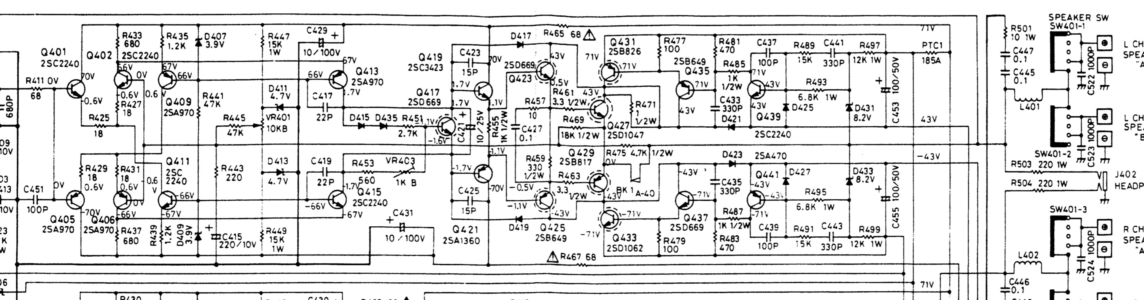

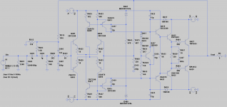

The receiver version manual for NAD 7240PE is a lot clearer and contains the power amplifier schematic on a single page. Free download after signing up here: NAD 7240PE - Manual - Stereo Receiver - HiFi Engine

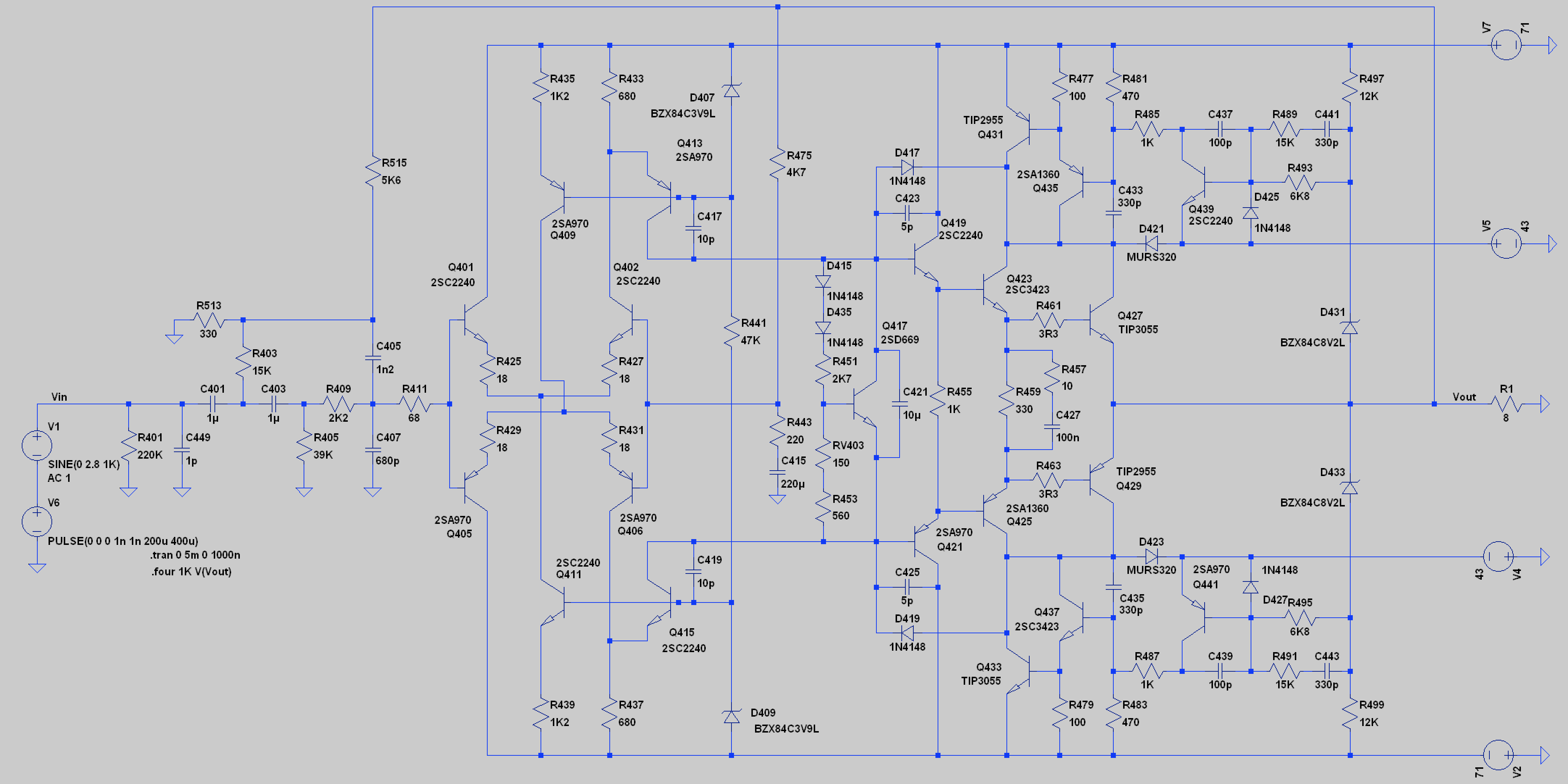

Okay - here 'tis without the soft clipping gumph at the input and without the PE stuff. I used TIP3055 & TIP2955 models for the output pair as I couldn't find models for the 2SD1047 & 2SB817, and figured they're probably not dissimilar to a 3055/2955.

Anyway it seems to work reasonably well - 0.003% pushing 1KHz, 28V RMS into 8Ω. Dunno why they bothered with the PE stuff - the basic amp is quite nice.
Guess it all comes down to marketing in the end.

And with the PE stuff added - excuse the transistor substitutions.

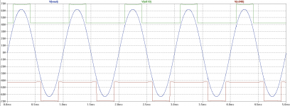

I can see why they did the PE stuff now - it makes for a very capable amplifier with low quiescent - assuming the driver SOA and supply are looked after, it will push an easy 240W into 8Ω.

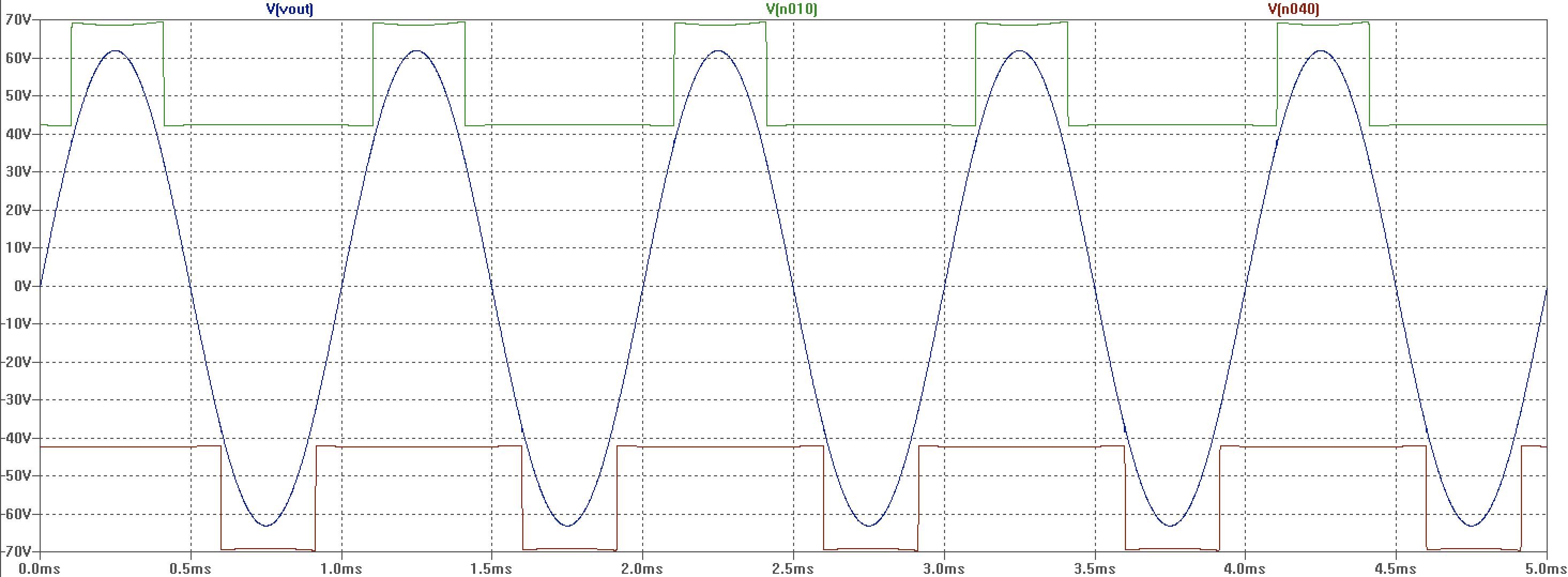

The graph says it all about the PE - it's a straightforward class H - n010 and n040 are the collectors of the main driver transistors.
Bear in mind the specs for this thing say "40W RMS into 8Ω". That's an impressively conservative rating.

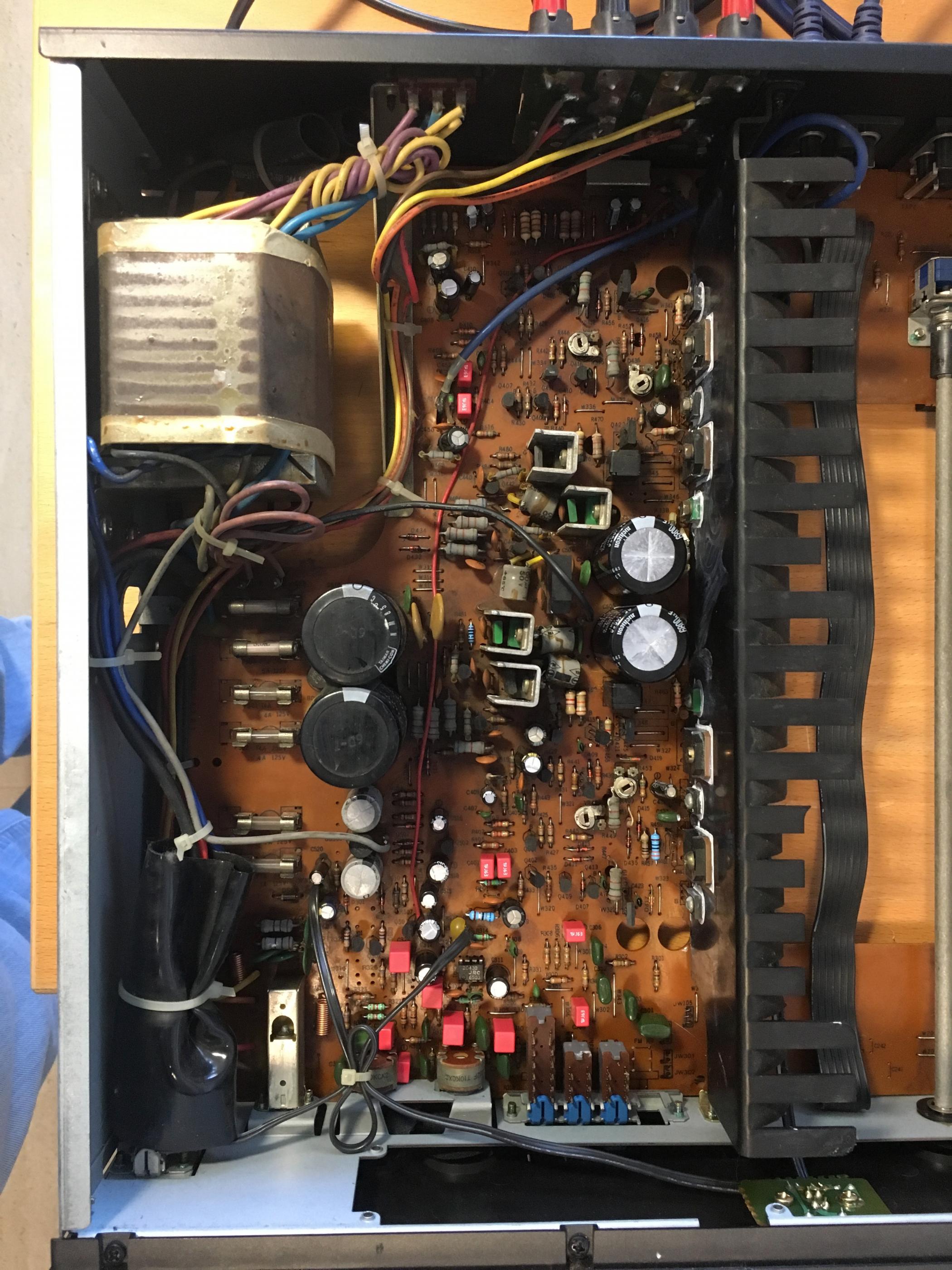

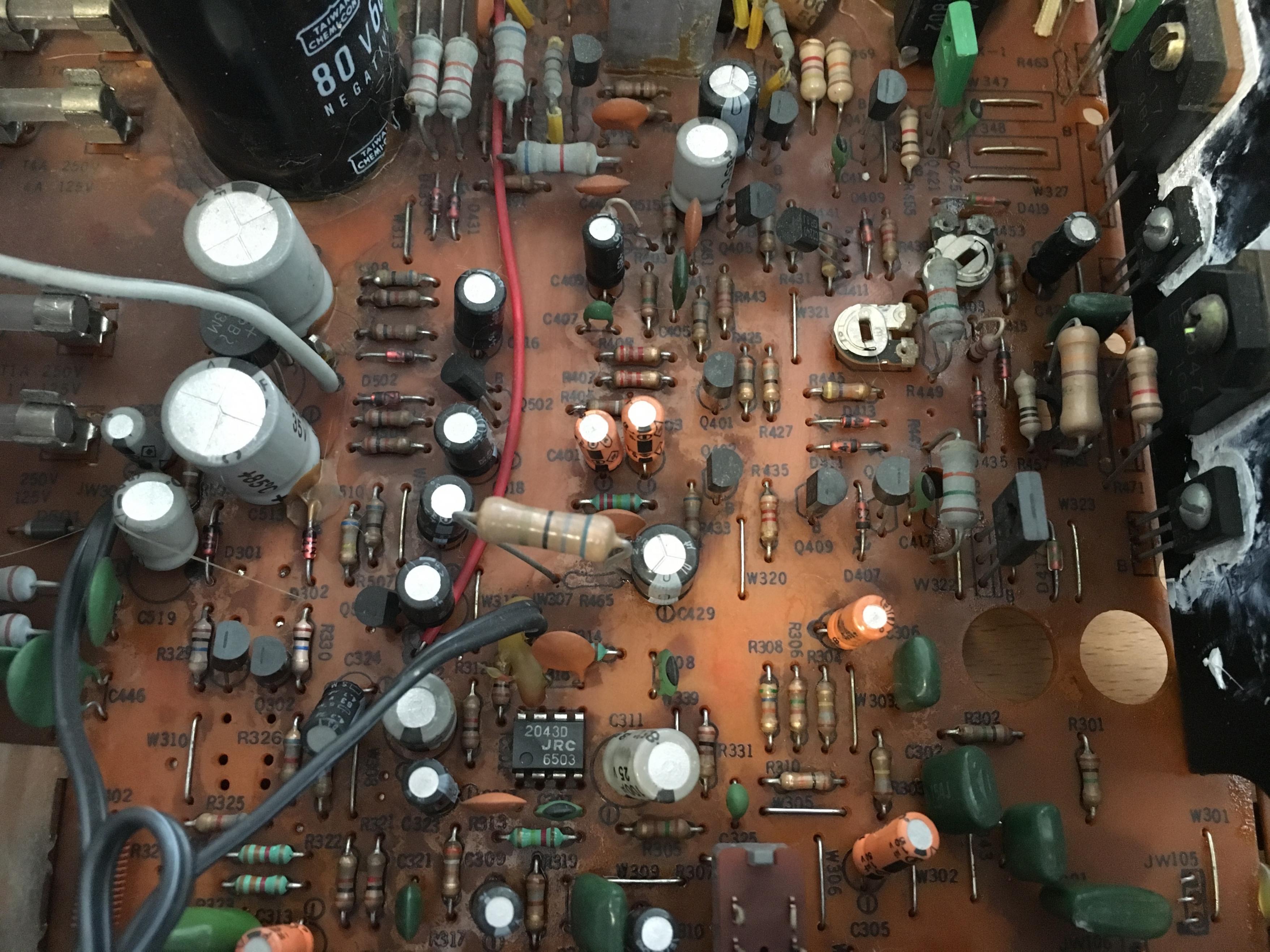

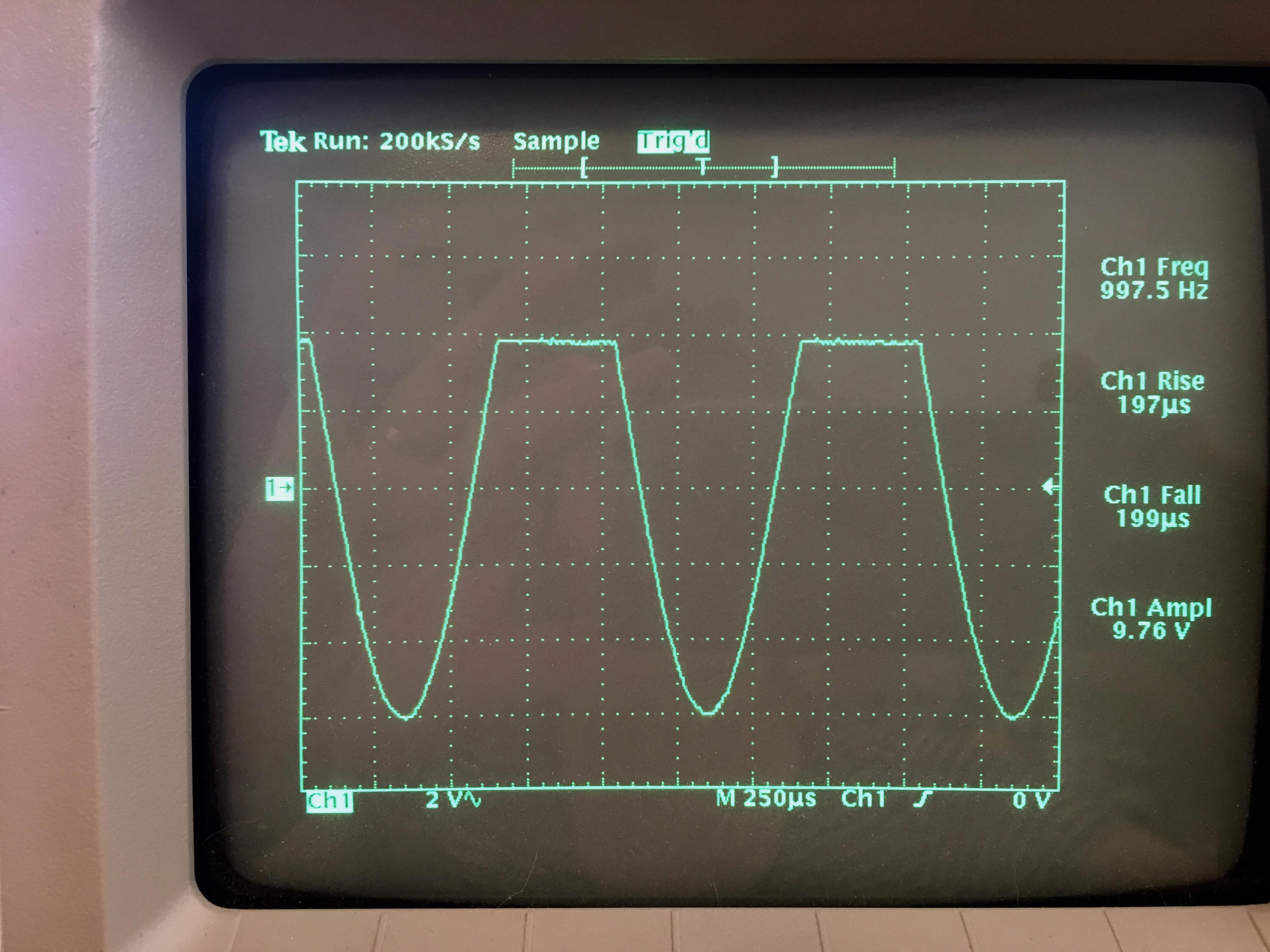

My 3240PE arrived through the week, and I just got home to have a play. The output from the pre is down ~40dB from what it should be. One side of the power amp appears to work quite nicely, the other side is missing it's PE bit on the positive side - that's the weirdest clipping I've ever seen (note it's divide by ten).
Oh, and it's filthy. Bloody smokers. I think before I progress much further I'll give it a thorough wash.
That looks pretty grubby! And an interesting waveform you've got there. Hope you can get that back on it's feet without too much trouble!

Part way through - I've sorted the pre anyway. I was getting a signal as far as the mute JFETs, but no further. The circuitry around the power-on muting circuit is significantly different for the 2340PE and the 7240PE (I spent twenty minutes searching for Q503 on the 3240PE circuit board before I figured that out. So the dodgy 3240PE schematic is luckily good enough.
Anyway it was very easy once I'd worked out the circuit. The JFETs are turned off when the power is off, by holding their gates at -30V. When you turn it on, C520 (4µ7 50V) charges slowly to +20V via R510 (680K), eventually turning the JFETs on. In my case C520 was a bit leaky, so it never charged up and never came out of mute. Replacing C520 fixed that.
I'm suspecting one of the PE transistors for the lack of +70V drive for the left channel (possibly Q431) as I've definitely got +70V available at the +ve side of C453, and the cathode of D431 is driving up above 43V happily.
And now it's working properly.
The lack of +70V drive on the left channel was due to a dead 2SB649, Q435. This is the transistor that turns the main HV switch on.
I don't have any spares for that, but while I was working I noticed that in a previous repair someone had substituted 2SB649 and 2SD669 transistors for Q419 & Q421. While this substitution clearly worked, they really aren't the right part for this spot. I noted that the other channel uses 2SC2911 and 2SA1209 here (original from factory from the look of it), so did a bit of swapping and ended up with a spare 2SB469, which then went into Q435.
So yay, all working nicely now.
I've also done some more capacitor replacement (everything bar the high voltage 100V and 80V ones which I don't keep stock of, and some 330µ 35V ones on the preamp supply which I also don't have in stock. So it's still a Mouser order from finished. I think I'll order new trimmers too, as the ones it came with are awful.
In the meantime it's gone into my NAD stack, and it's very nice to have matching logos and green power buttons finally. My cats are impressed.
