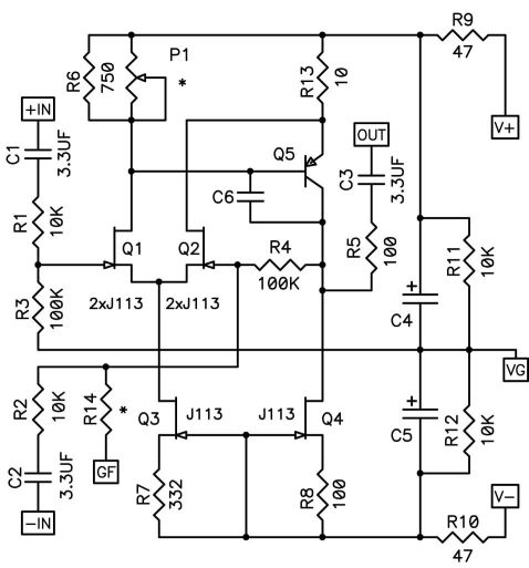

Hi,i want to try on a breadboard and i'm looking for the final as built schematic diagram.
Can someone help?
1)This will be used as preamplifier for F4. balanced to unbalanced option.
2)what is the purpose of R14 and what's the value?
PS .Is this what i'm looking for?
Thanks in advance!

See the post #686 by Nelson in this thread for all of your answers - and more on the latest revision. First iteration is in post #1.

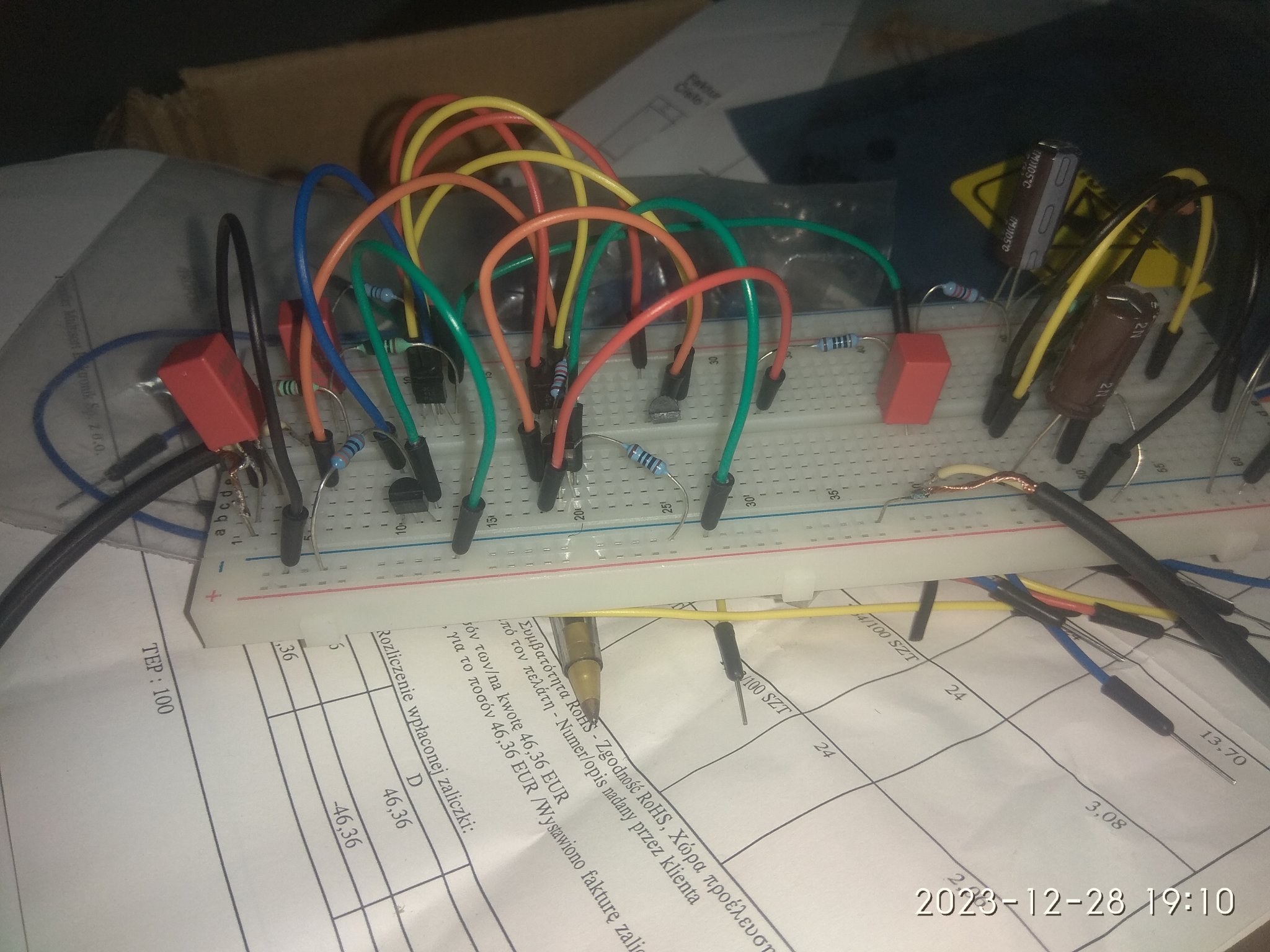

This circuit don't love breadboard...
I used non matched for Q1,Q2,Q3,Q4.
CCS Q3=2.8mA
CCS Q4=8mA
I have tried R3,R4=22K
(gain2.2) and R3,R4=100K.(gain10).
Power supply is +22V regulated.
The breadboard test circuit oscillate in both gain leveles .
CCS Q3=2.8mA
CCS Q4=8mA
Is virtual ground solidly 11V? If you've checked wiring, could try adding a BFC (100-1000pF) from Q5 base to collector or to VG. Also check DCV at Q5 base.
Also keep -IN grounded for now.

Thanks,i will try your suggestions soon.
Just now i have tried to connect between sound card and power amplifier,it is functional but with hum and worm power amplifier(oscillations).
PS.I have tried C6= 27-54pf but worse results.

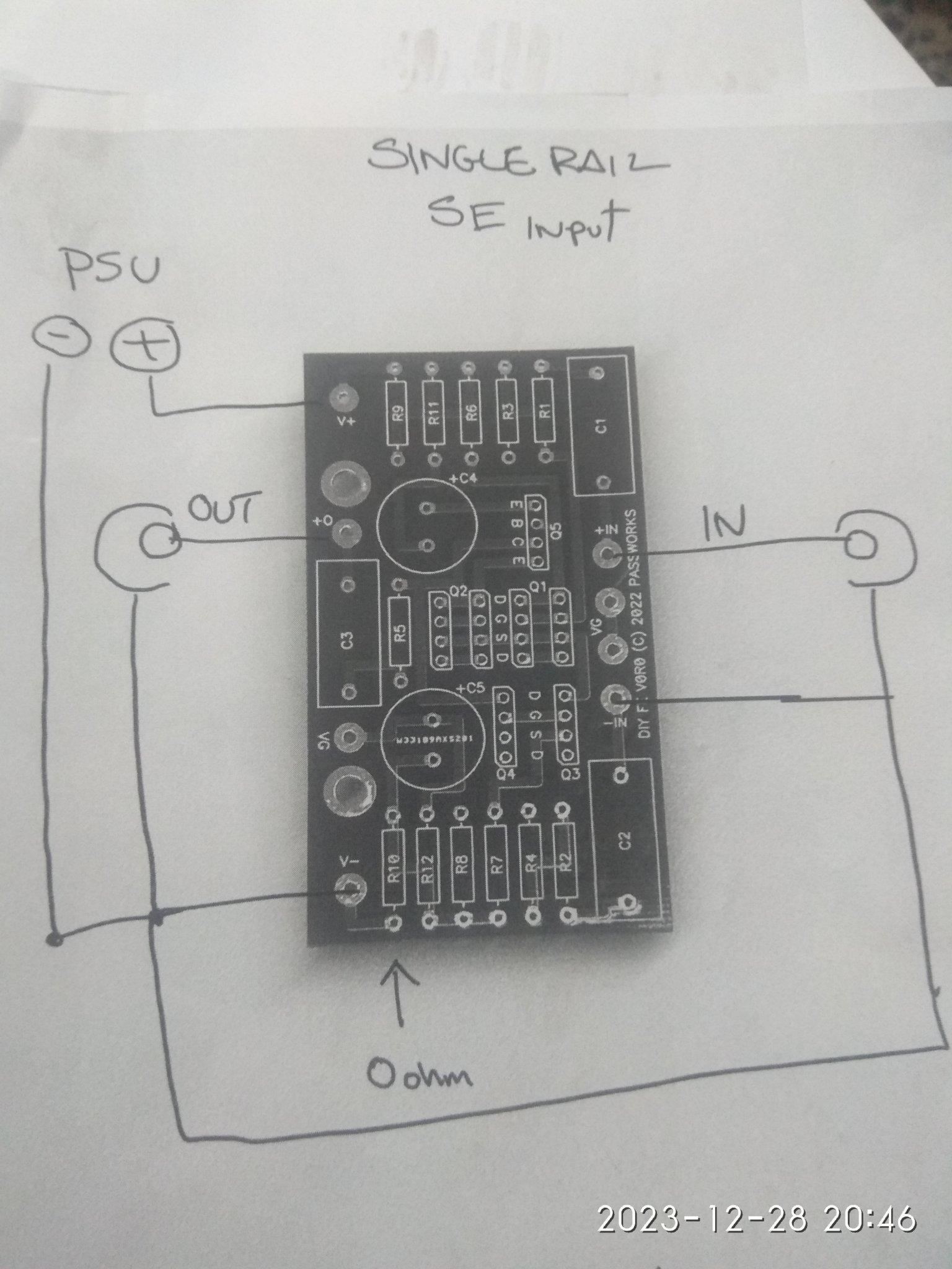

Yes,vg=11,4VAlso keep -IN grounded for now.
Q5 Vbe=0.6V
VR6(680R)=0,68V
What do you mean,keep -IN grounded?
Eliminate C2 and R2 connected to 0V?
I use this configuration as in photo.
Don't eliminate those parts; you're correct--just drive SE as you show, and not BAL. When you get it sorted out, you can use BAL, but easier for now to keep it simple.
I haven't used those breadboards in a long time. Maybe they're the problem, as william2001 states. ¯\(ツ)/¯ Does the oscillation change when you touch around the different nodes?
