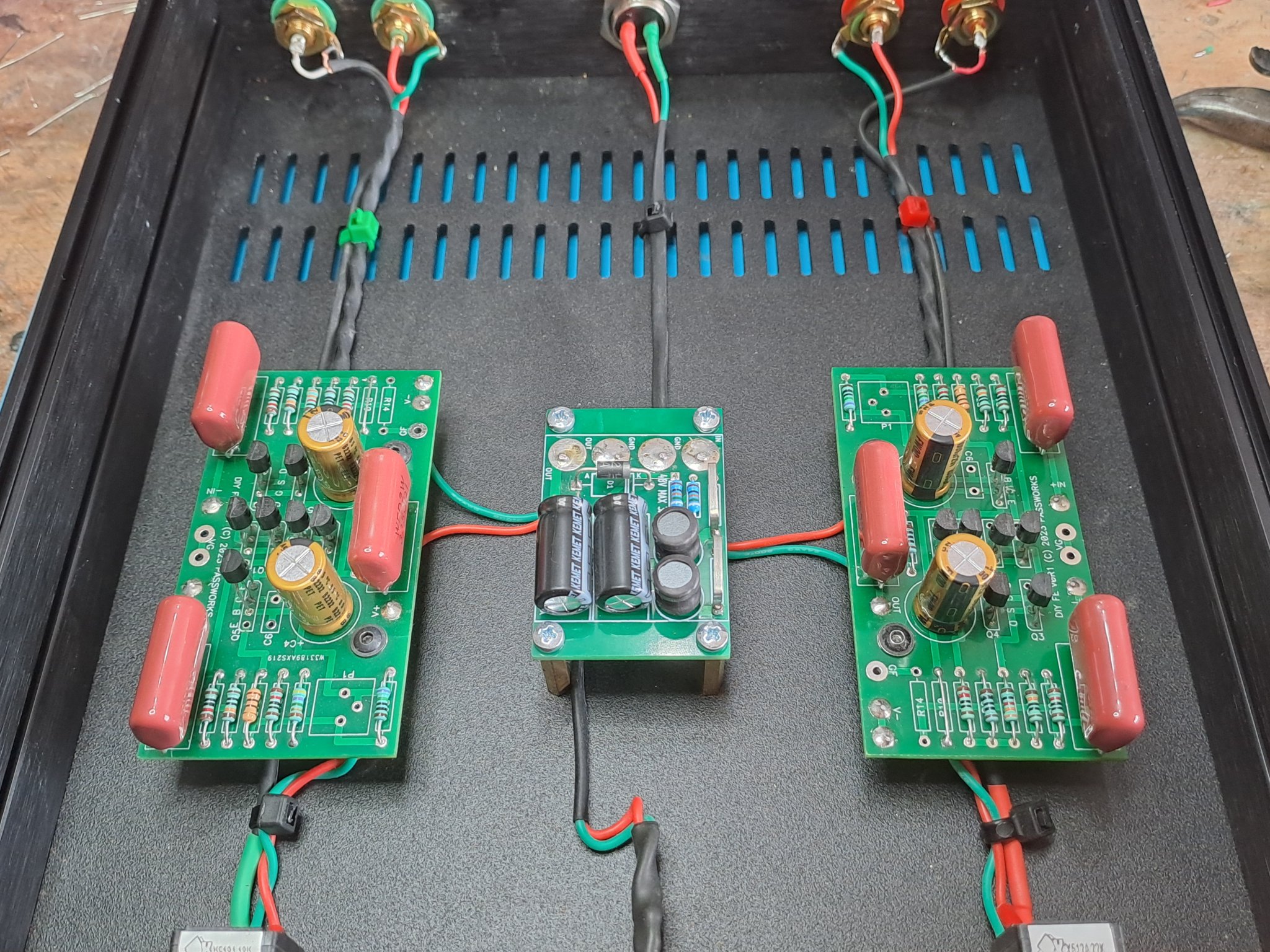

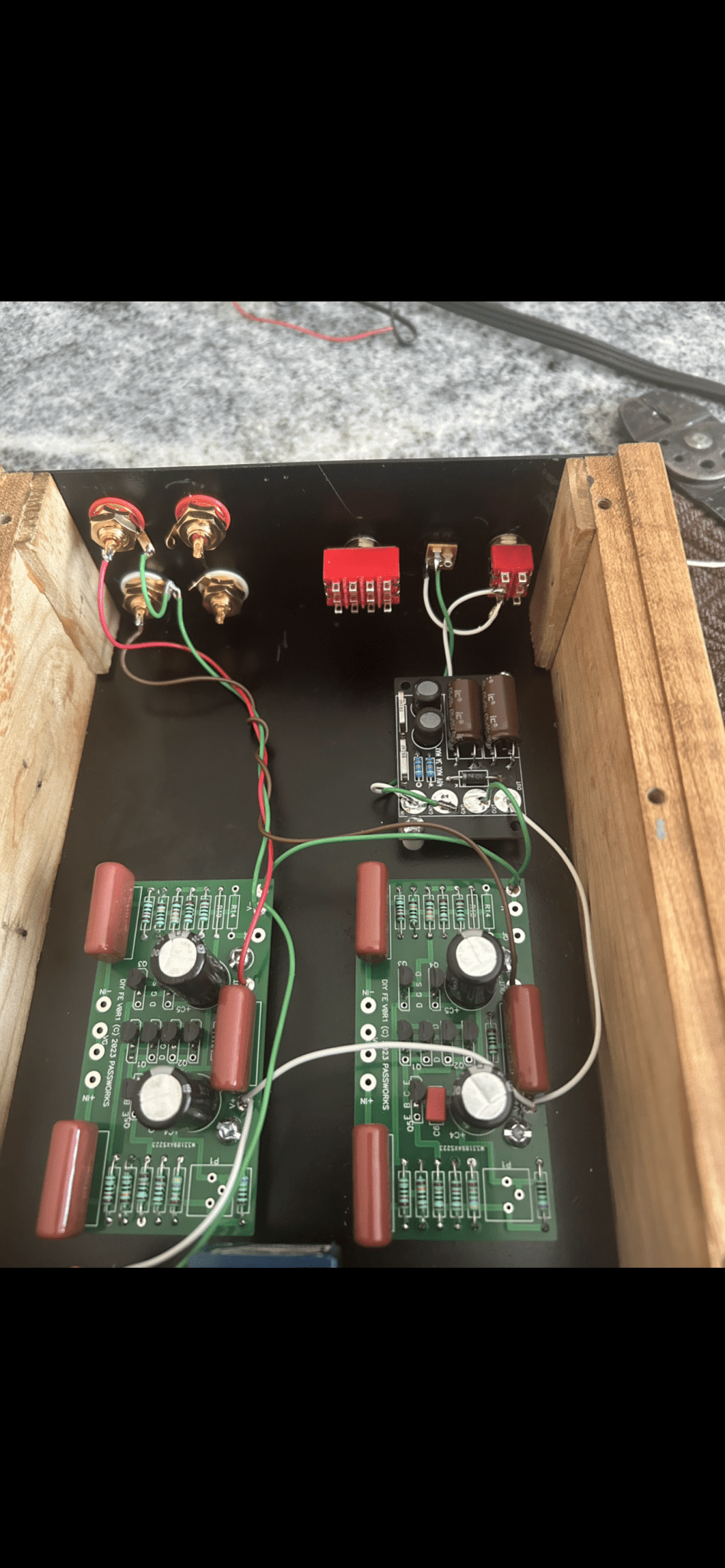

How balanced does the power supply need to be? I built a +/- 27 vdc supply using 3x 9.1 volt zeners and fets and it ended up +0.3 volts higher on the positive side. I think I could change some zeners to get it closer but I don't want to if this is good enough.
Also....What current draw should I expect?
The current draw is approximately 12mA per channel: https://www.diyaudio.com/community/threads/diy-front-end-2022.394339/post-7231380
The slight voltage imbalance shouldn't be an issue.

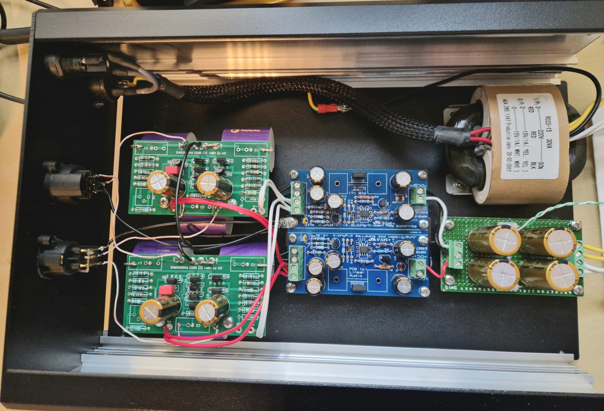

Can you guys tell if I can use this as mic pre for SM7B? I have a tube preamp with 2 channels with phanthom power (REDD .47).
How to commutate theese correctly from preamp XLR with 48V and mic output? What connect where.
On the board I see In+, in-, v+, v-, grnd, out. I plan to use 2 boards in same enclosure for both channels. SK170BL pair on each board.

I can't help but think that it's the result of clipping, which is not perfectly symmetric.When it played lower than 30W its offset is only 10mVDC. I used latest version of FE2022 with 1K trim pot and also trimmed it to 0VDC at the output of TR (in front of output cap)

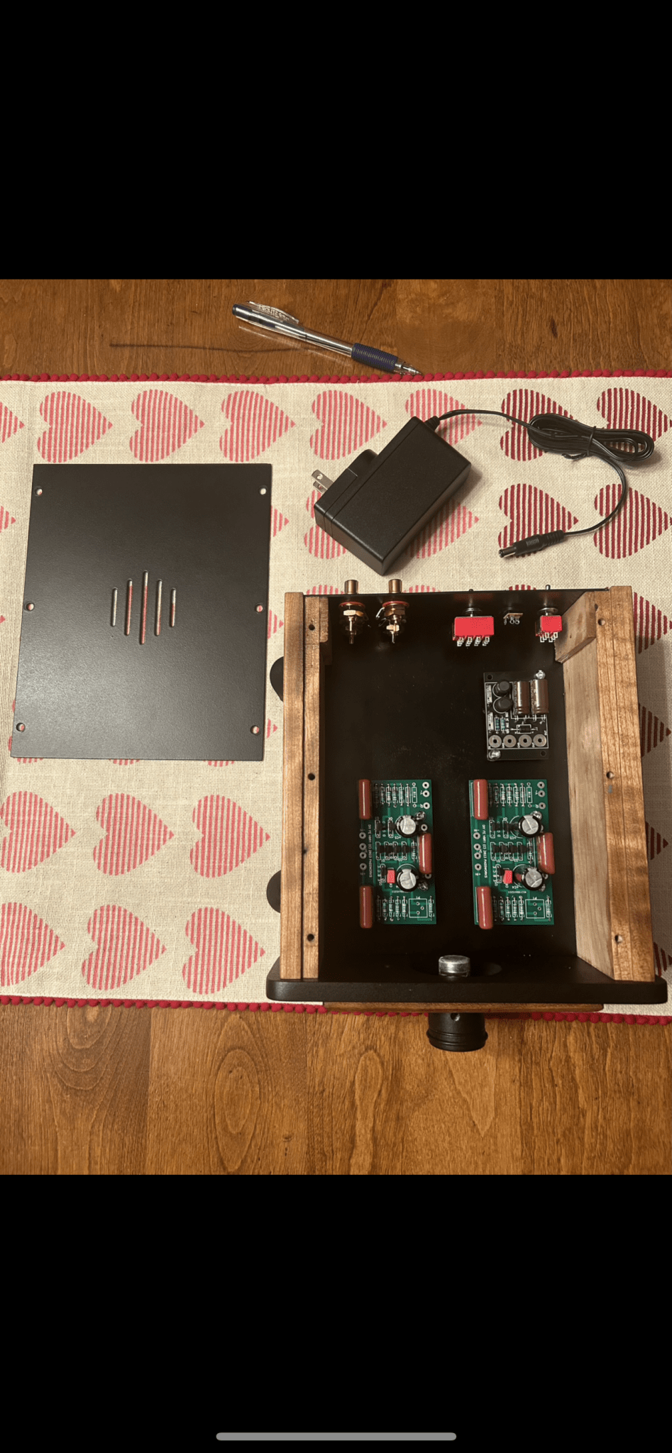

If i want to keep the inputs as XLR / balanced until it leaves the Front End, can i put a volume pot (Alps RK27 10k) after the Front End without any adverse effect ?
Idea is to have "XLR/balanced inputs" -> "Front End" -> "Volume Pot" -> "Ship of Theseus" in 1 box.

why placing vol pot after gain stage ?
proper place for volpot is before gain stage, which is also acting as buffer for volpot output impedance
if your goal is to save money, instead of using bal volpot in front of gain stage, so you can use normal stereo volpot after the gain stage, logic is no good, reasons explained above
and also you get gain stage not working in full scream mode, if getting full voltage from sources
