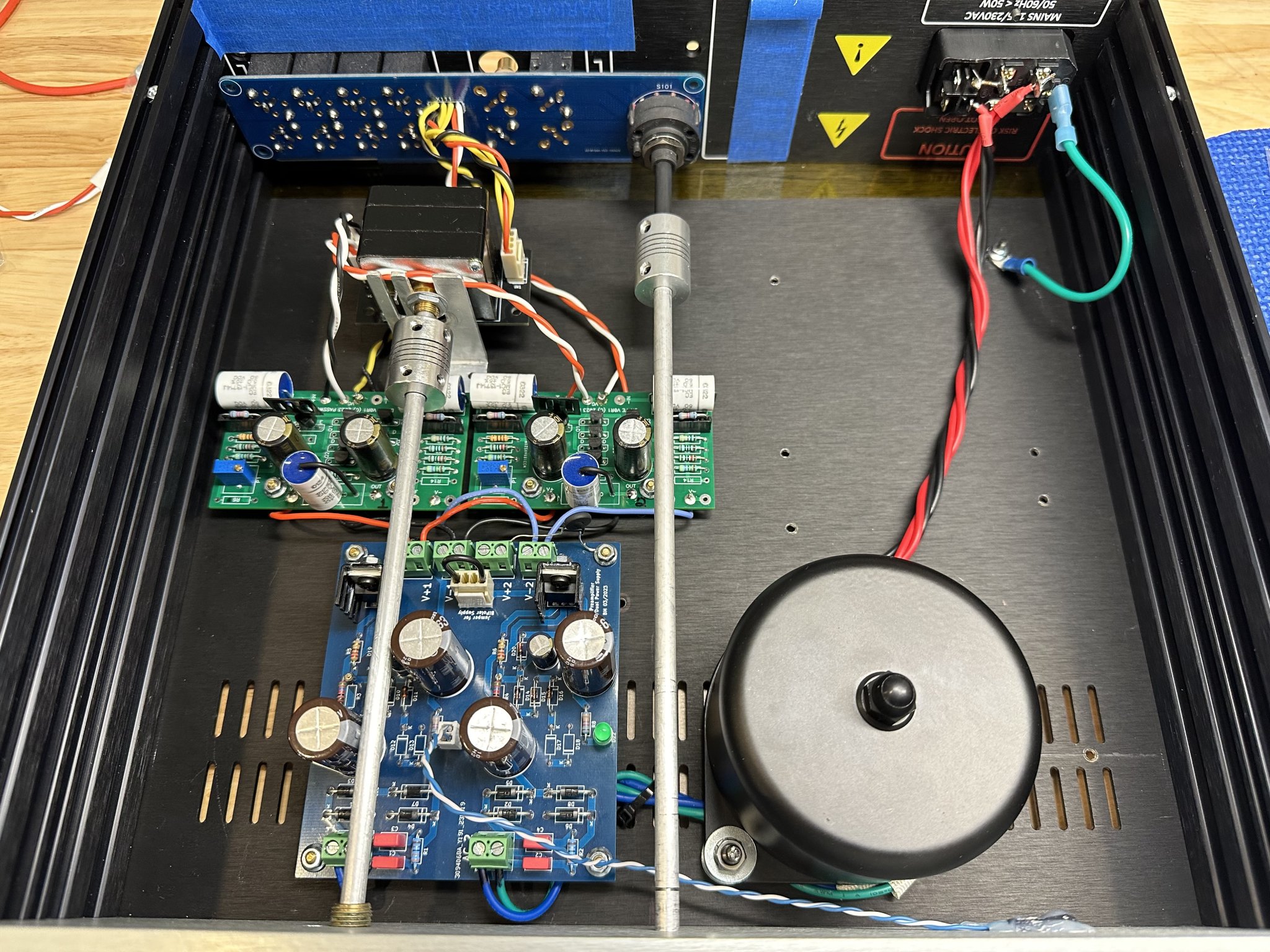

Finally whipped together the FE2022 as a preamp into a chassis already in my stash.
Used @Ben Mah's psu board set up as a +/-25V bipolar supply.
Sockets installed at R3 and R4 for easy gain adjustment to match different amplifier needs.
C3 is physically installed, but a jumper is soldered under the board to bypass the cap.
Wow!
These gems have been sitting in my drawer since they were released, I should have built them sooner. Impressive sound for such a simple low parts count build. Now that I've had some listening time, this pre deserves more attention to build details.
Thank you for sharing the FE2022 Nelson!
Wow!
Nice build, and I agree that it is a great preamp.

Very nice build Vunce - as usual for you. If you are using the J113 fets at the input pair, then a pair of matched 2SK170BL's will be so much better, like chalk and cheese on my build. Still my pre amp of choice - as you say, so simple.
It's a steel center bolt but they give you a plastic shoulder washer and plastic "acorn" nut that avoids the problem.I hope your transformer enclosure does not create a shorted turn.
