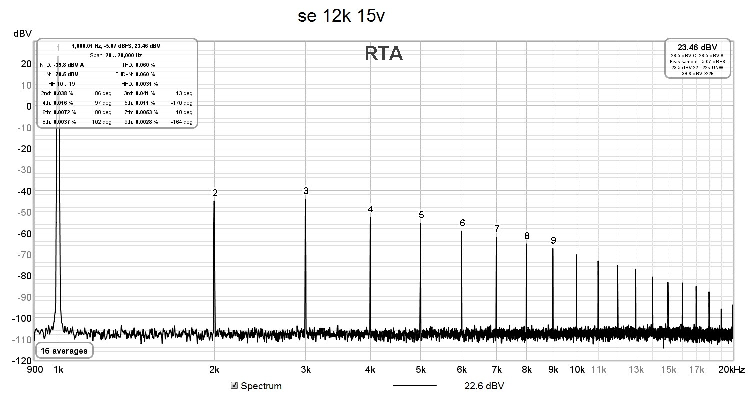

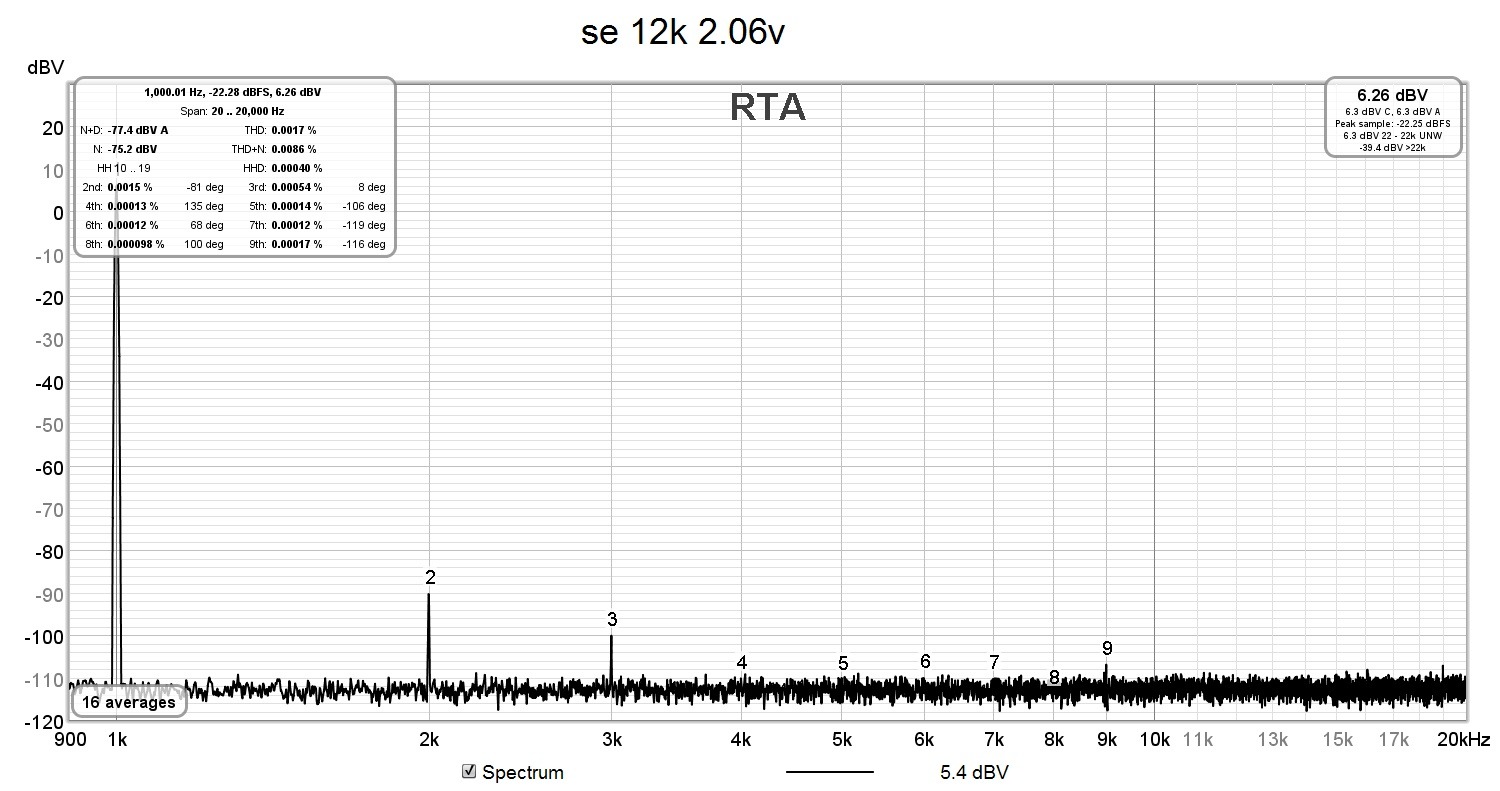

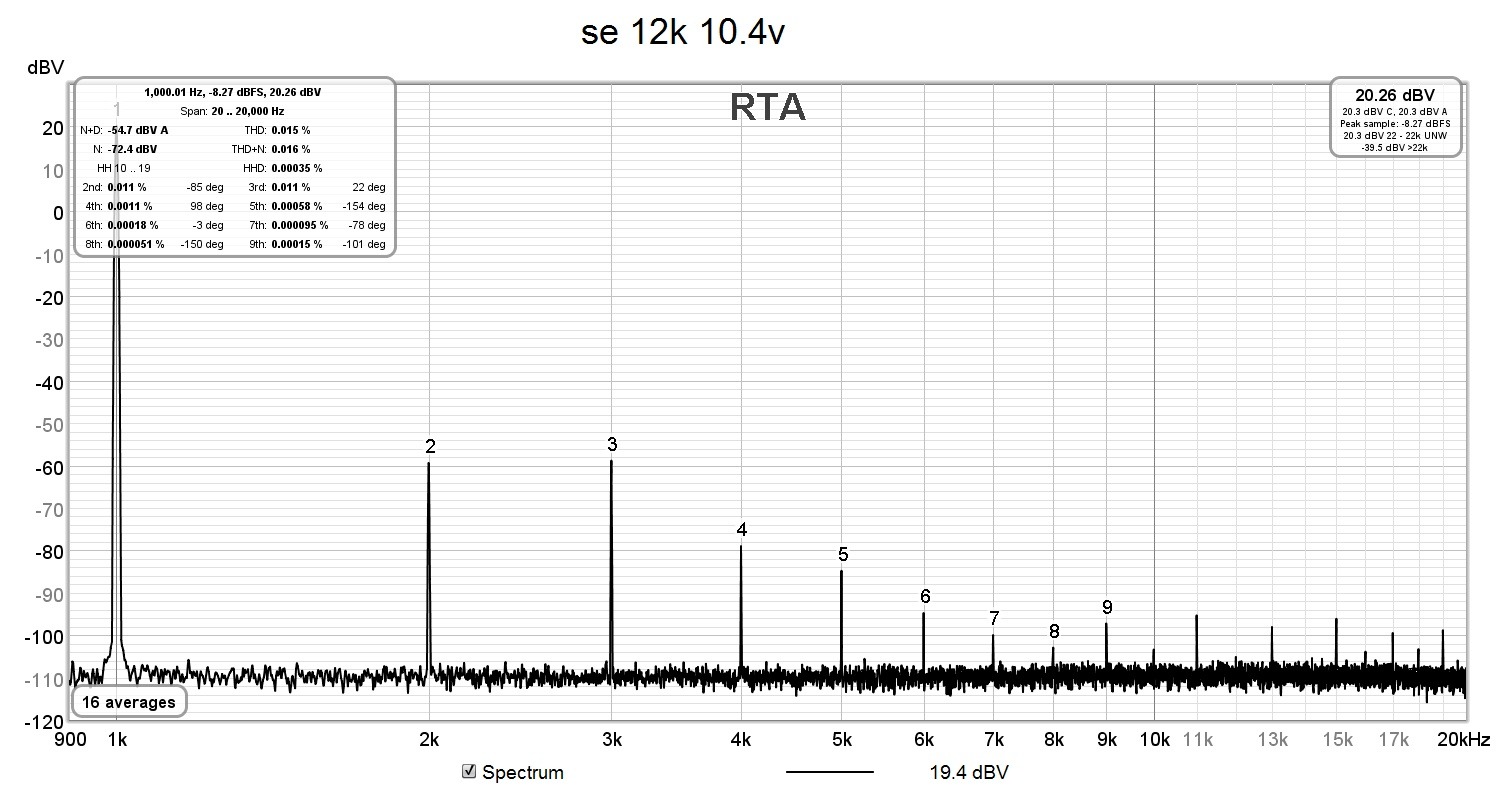

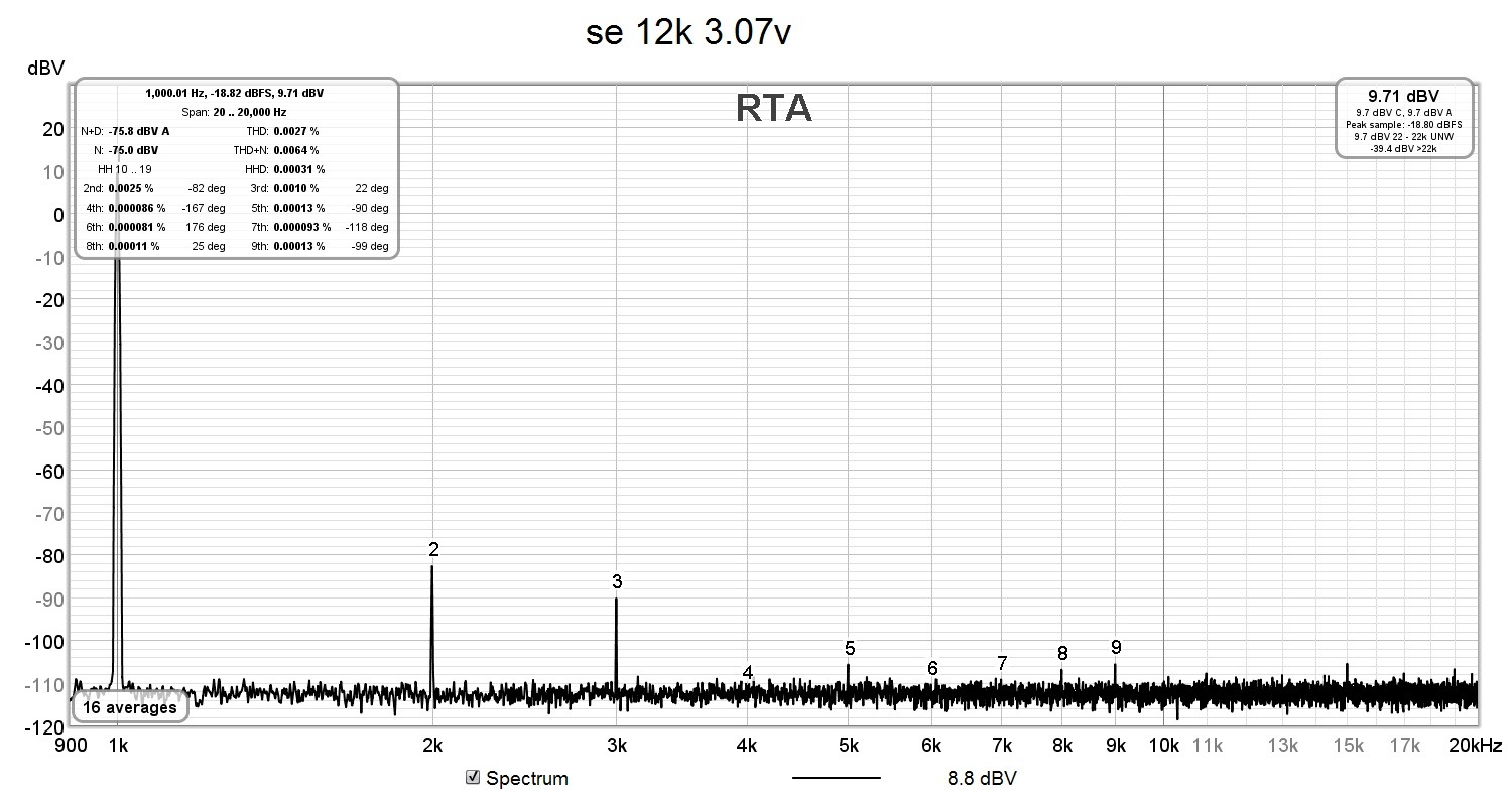

In the post #1290 the THD, for the same output voltage, decreases as the output load increase. The simulation also shows the same decreases. REW and Spice also show in the a change in the phase of 2H. Can this affect the total THD?
Spice with supply +/- 23V prefers a lower load. 😡
Also in this case there is a change in the phase of 2H.
Positive or negative doesn’t matter if the level(of h2) is the same you get same thd.
If you drive your amp with a preamp that has negative phase 2nd it doesn’t mean your amp will give you negative phase 2nd on the output.
Don’t loose your sleep with this.
Ltspice is good until a certain point from there on you need to build the gadget and test it in the real world.
OTOH, if the H2 in the FE is out of phase with the H2 in the OS, some cancellation will occur. Which you may or may not want.

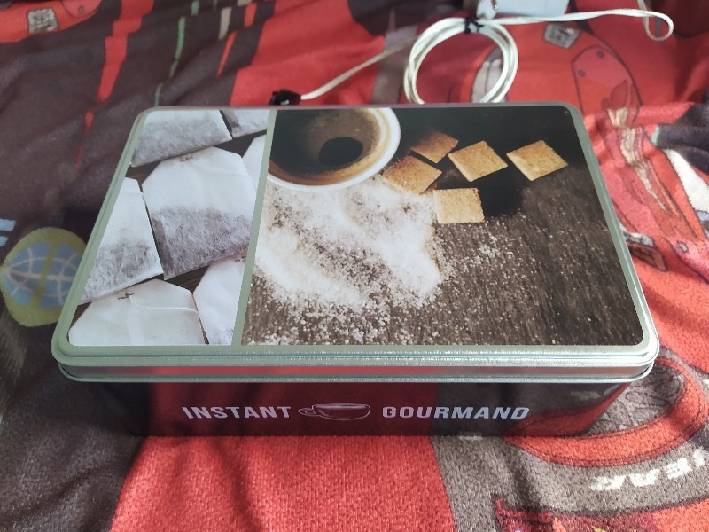

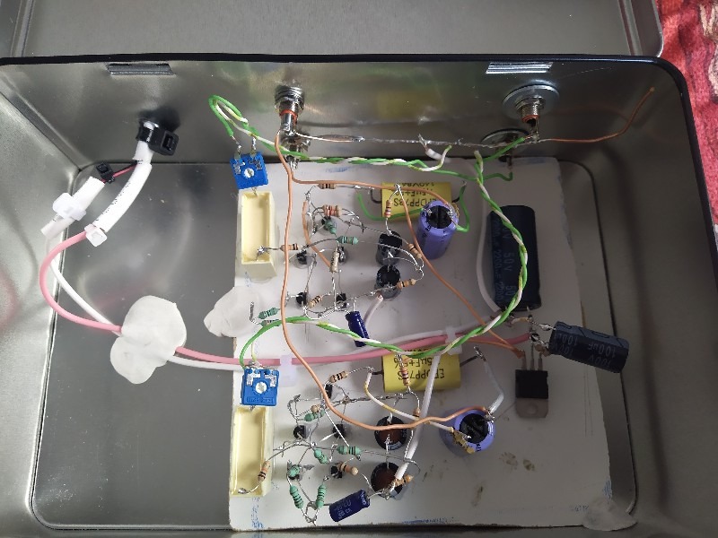

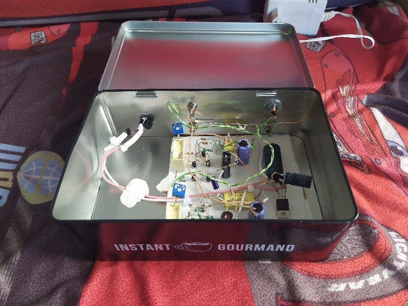

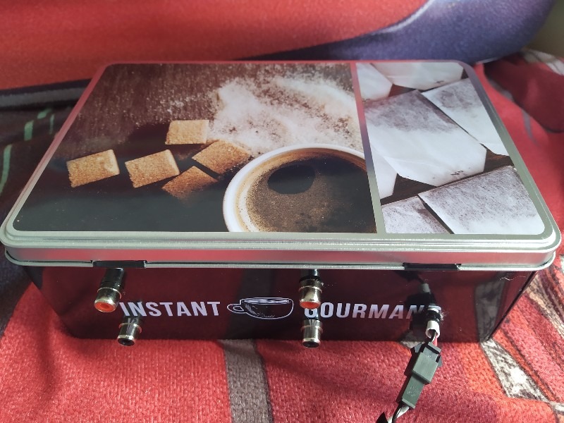

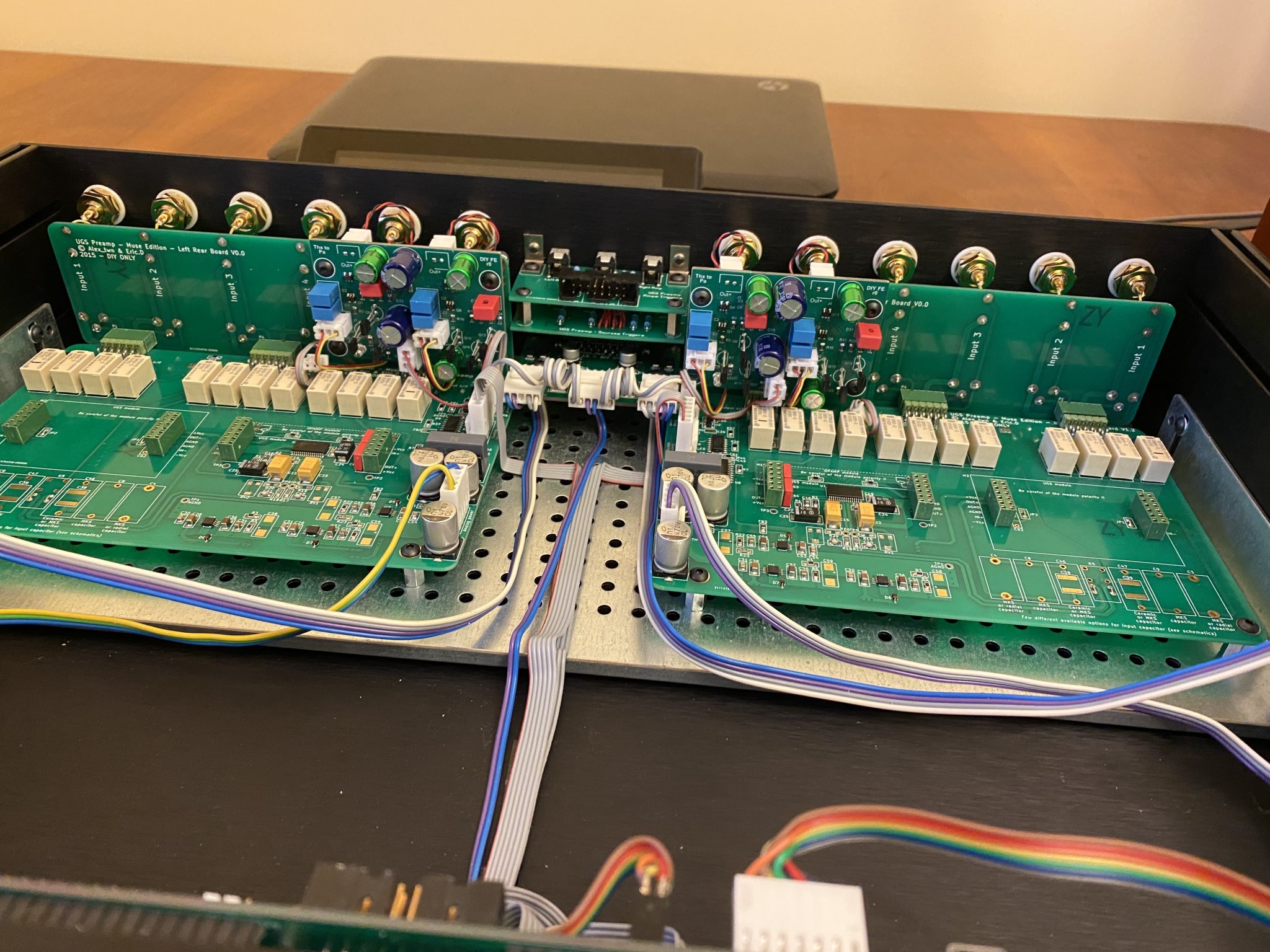

I sort of completed this preamp with the parts that I had in hands. Some parts (pot and power connector) are still not there, but otherwise the preamp is fully functional.
For the reference, the amplifier is MoFo, the speakers are Alpair 10.3.
Previously I had used used a Jfet Boz Preamp with J310 jfet. To my ears, that preamp sounds wonderful on low to normal volumes. But, if you crank it up, is is not so nice.
Now, some sonic impressions of Frontend 2022 (as compared to Jfet Boz):
Sounds nice and clean. Nothing that irritates or "sounds wrong".
But, the soundstage is a bit narrower, the sound is more "dry" and there is less "air" between instruments.
At low volumes, Jfet boz sounds better (or more "musical" if you like).
At high volumes (with ZZ Top for example) Frontend 2022 sounds better.
I think that in the end it boils down to the amount of second harmonic (negative phase) that I like.
So, the quest continues...
