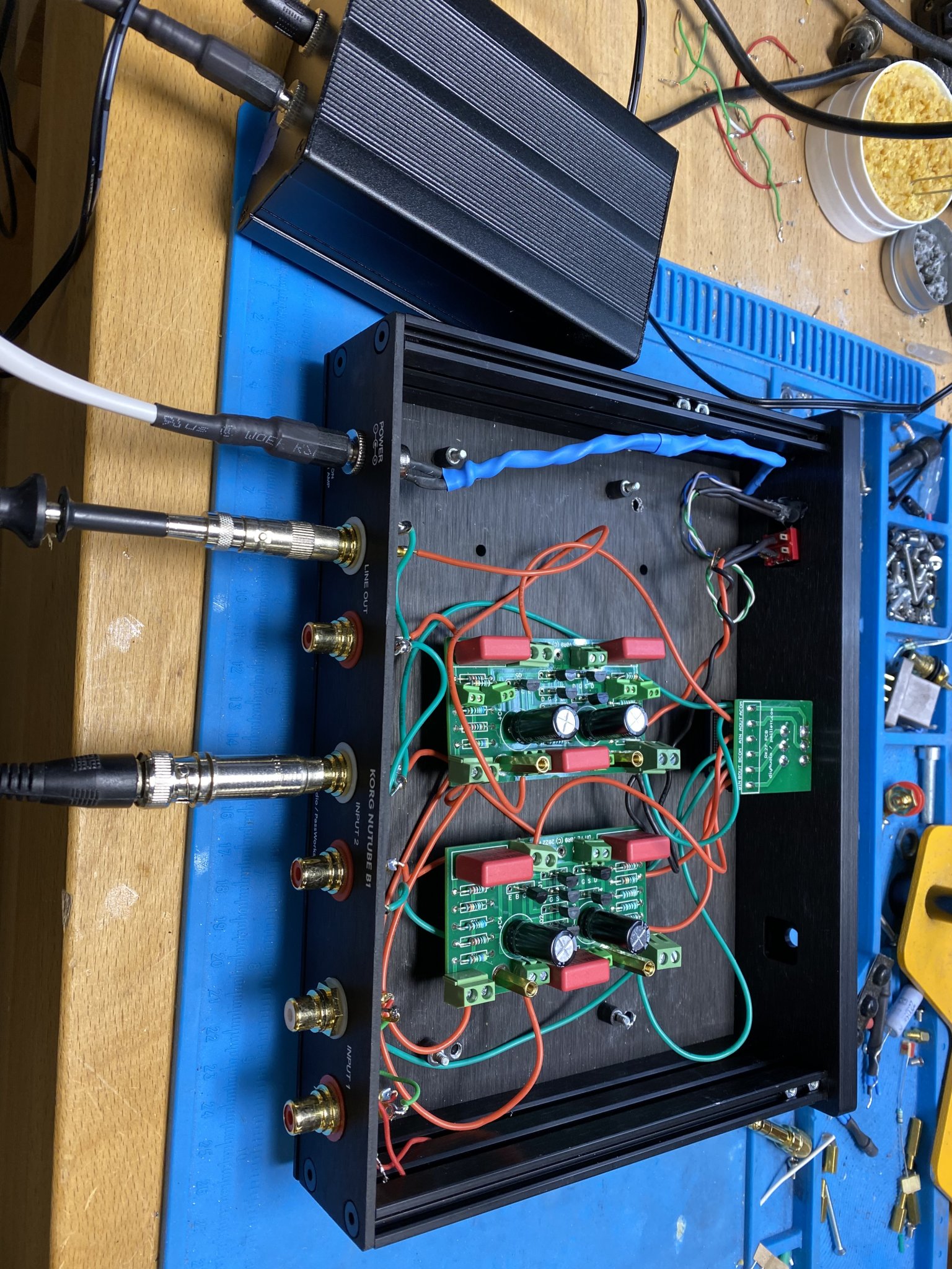

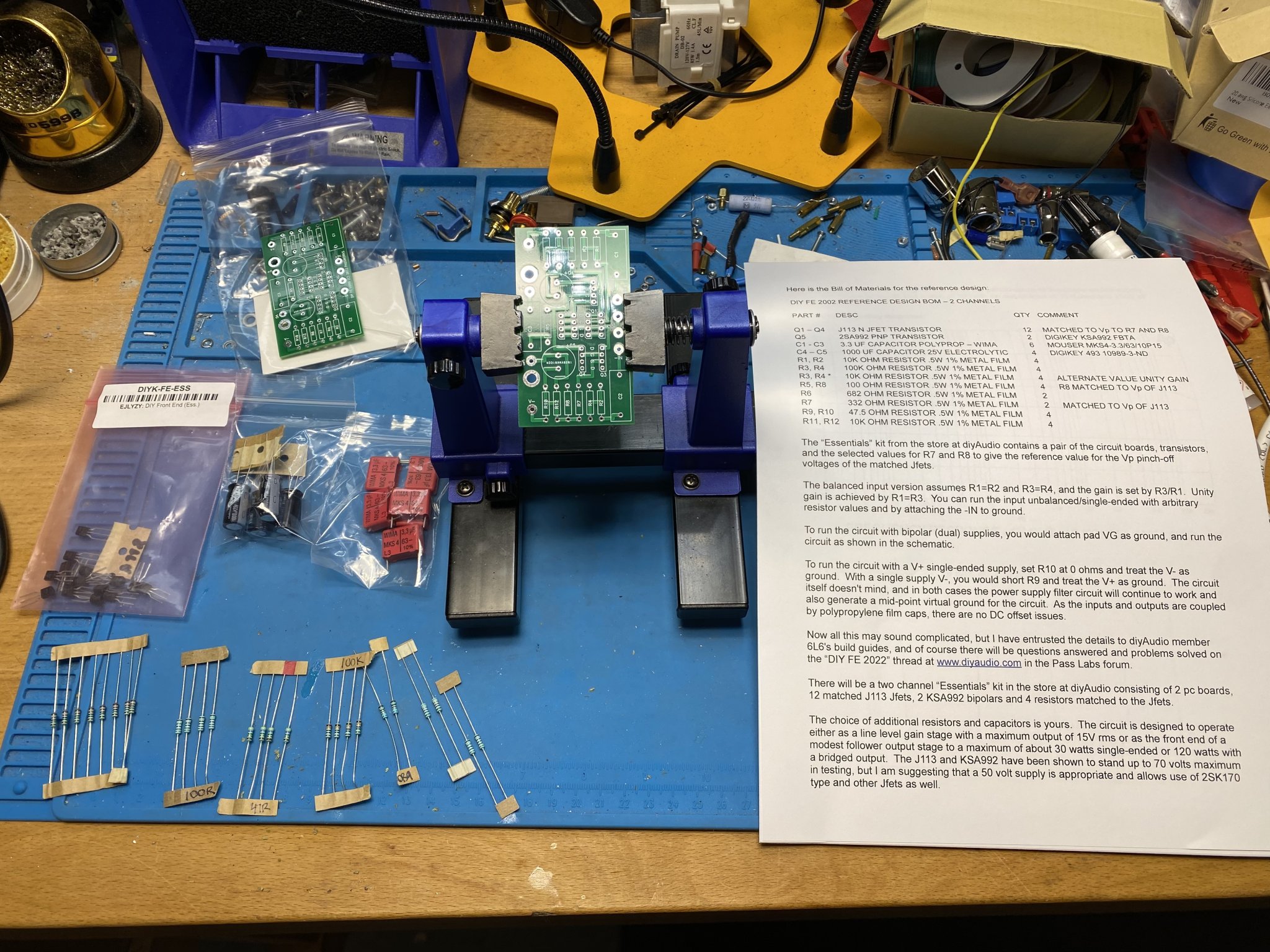

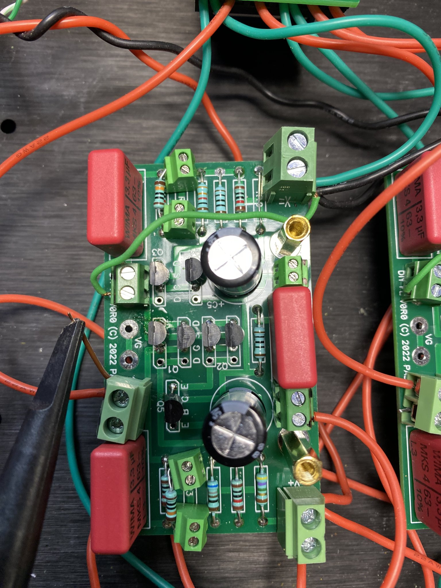

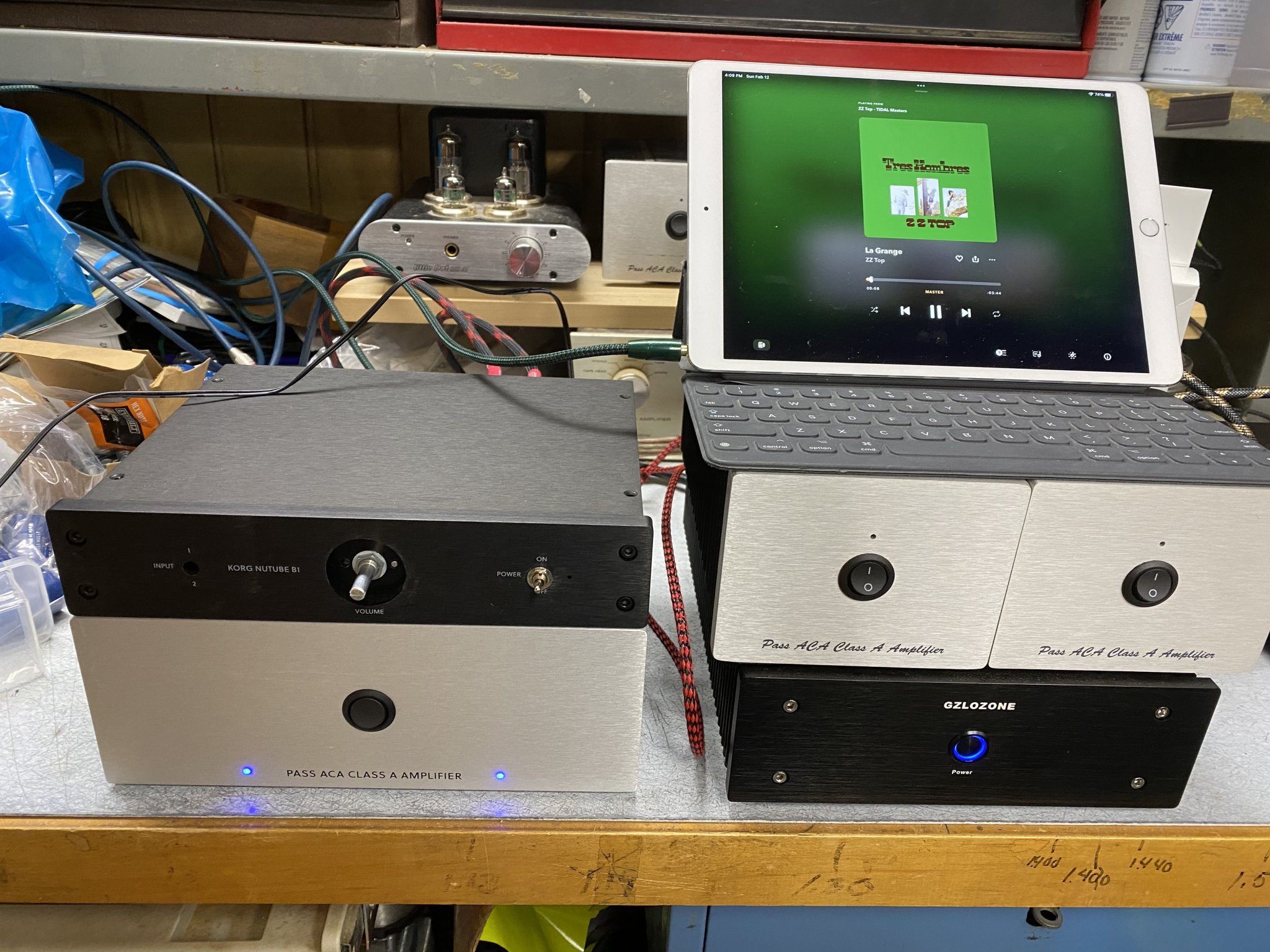

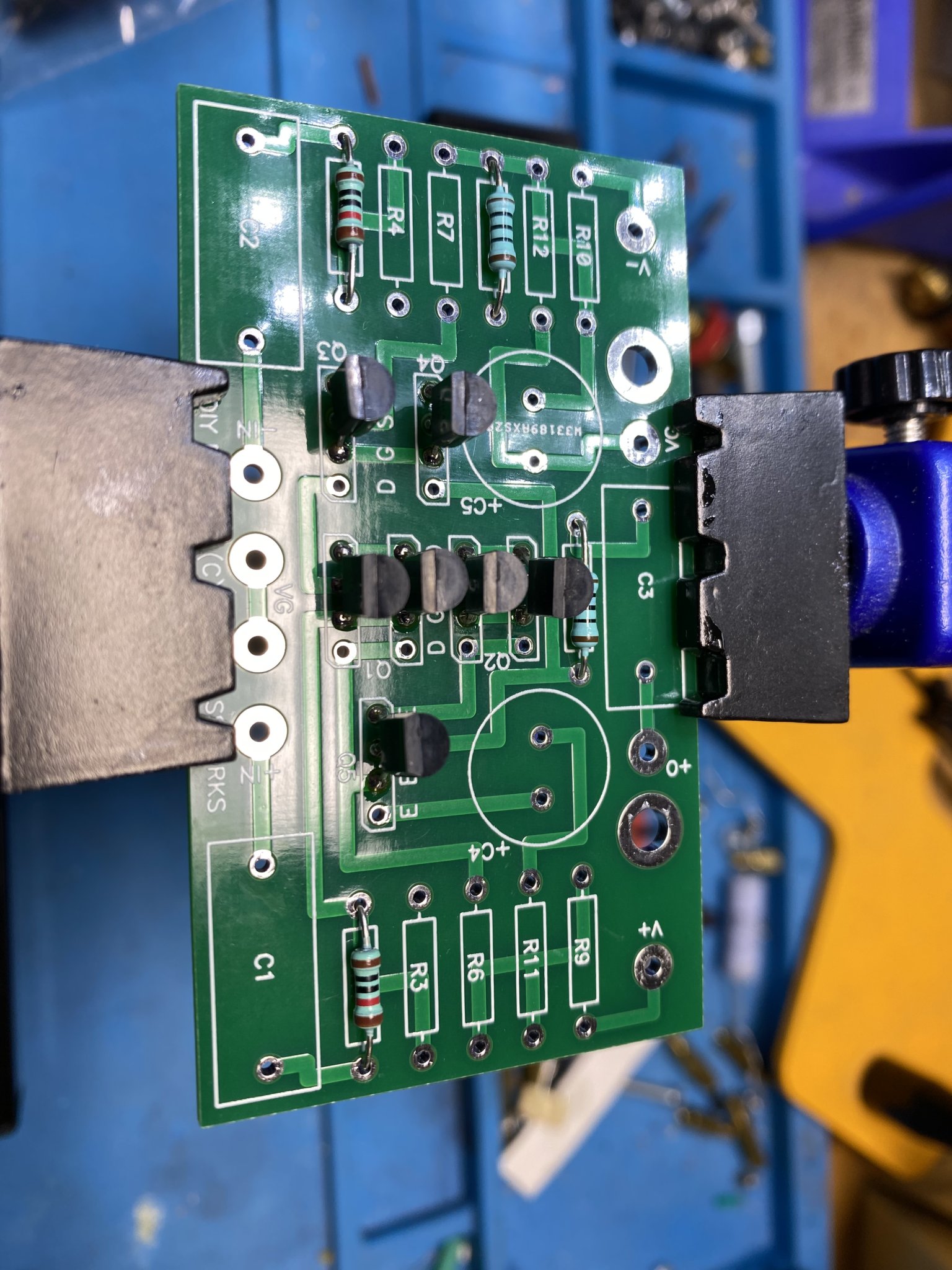

I had the chance to build the FE2022. Thank you @6L6 for all the help. Papa's instructions were sufficient except for one small bit of confusion, which is to say, you must connect ALL of the return paths together (you'll see the jumper wire in my pictures).
I built the single supply, single-ended version.

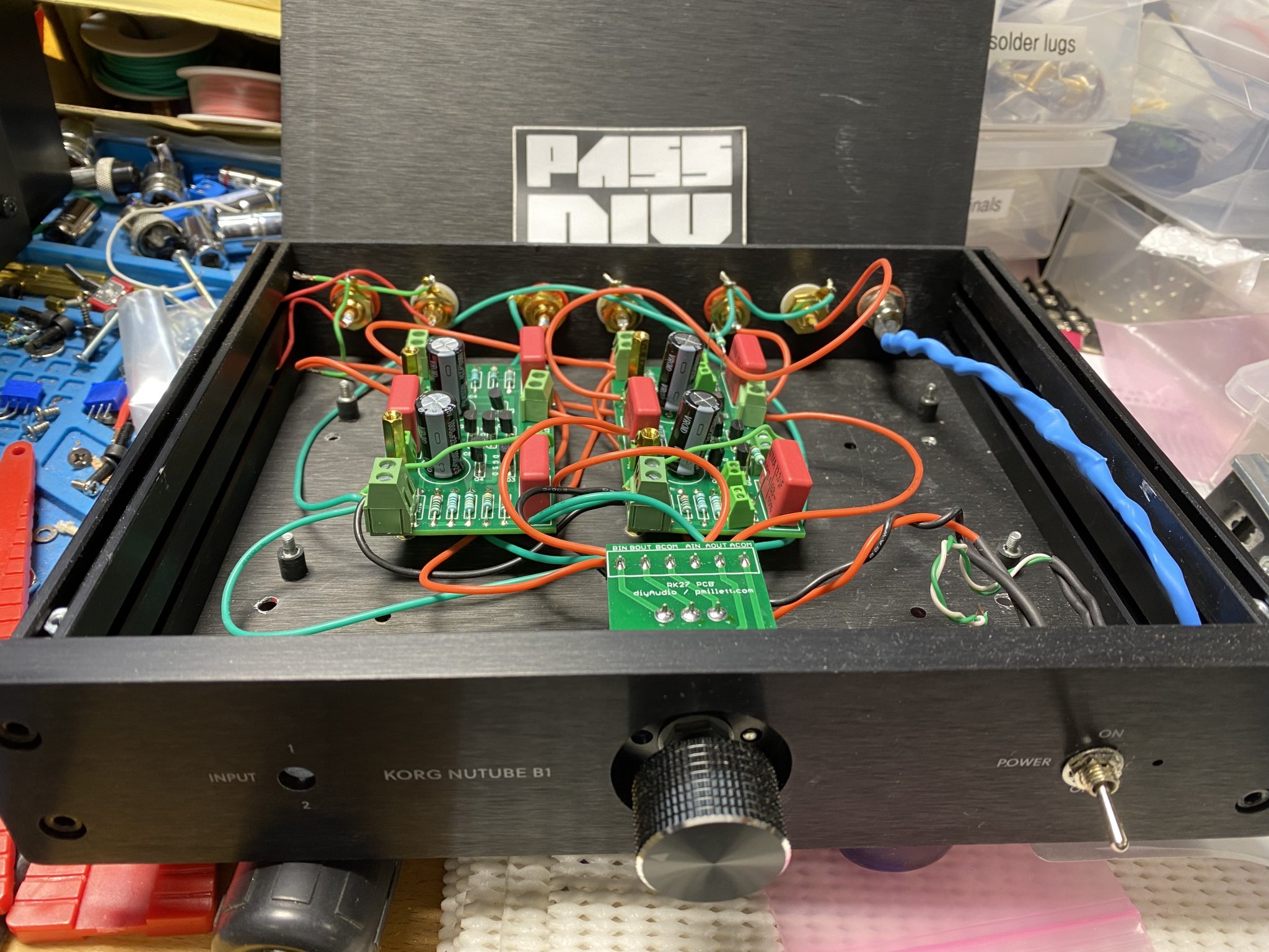

You will notice that this project, like most of the Pass preamps, will fit into the usual chassis from the store. I was fresh out and wasn't sure if I wanted to keep this in a dedicated box, so I repurposed my B1 buffer and as you can see, things swapped in pretty nicely. This also makes A/B/C testing / comparisons quite straight-forward and will rule out other variables as you are only swapping out the circuit - the vol pot/switch/PSU can be the same. You can even power two directly from the same PSU.

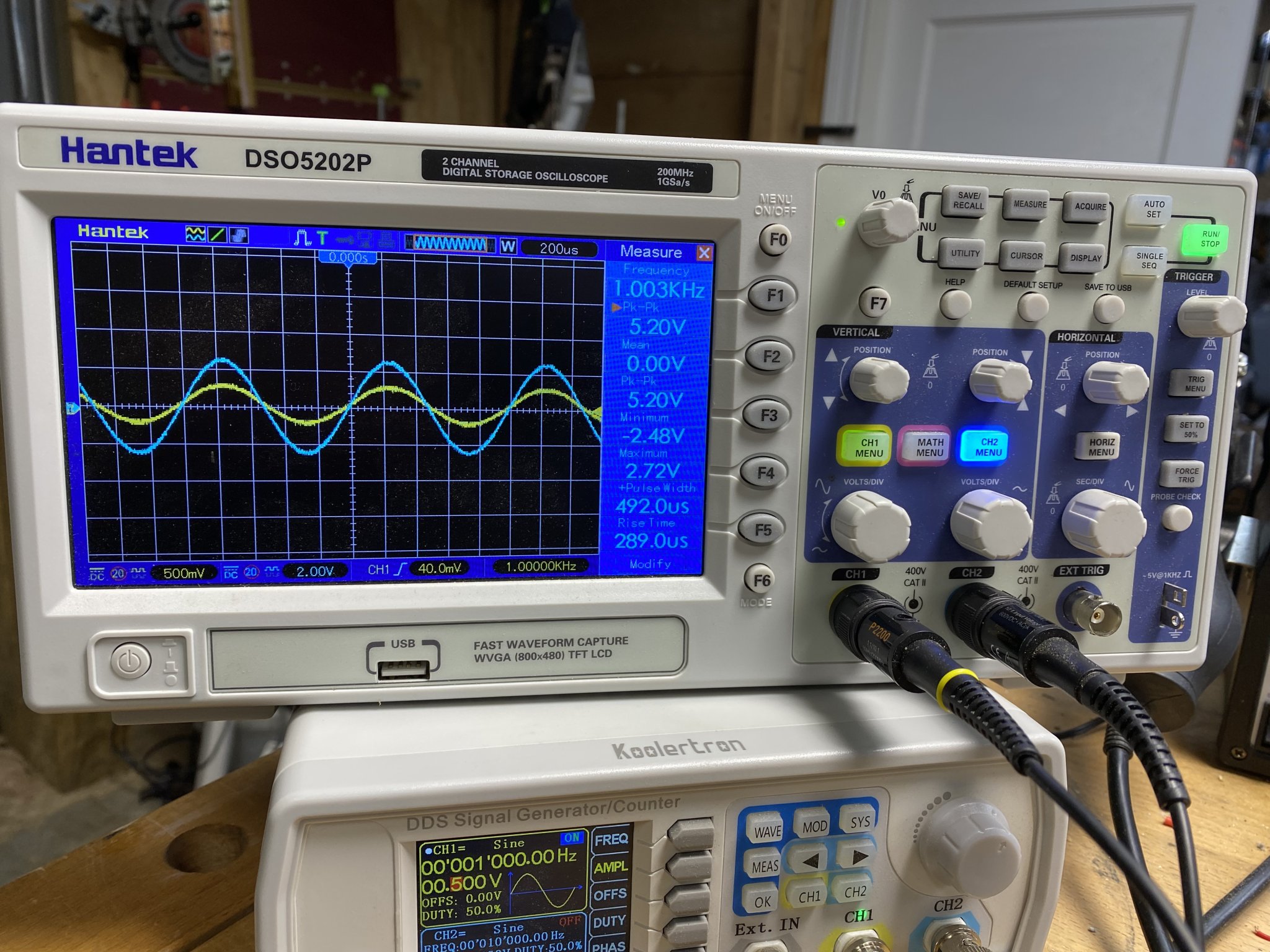

All in all, the circuit tested as expected with the following gain values when I swapped R4/3. Note that my values for gain/db are approximate to say +/-1db and +/- .5 on gain.
R1(2)R4(3)Gaindb
10k100k~10~20db
10k47k~4.7~13db
10k33k~3.3~10db
10k22k~2.2~6.8db
10k18k~1.8~5db
All in all, the circuit sounds nice for quiet passages at the two lower values of gain but I could start to notice distortion at higher volume levels with the 33k R. Nothing awful by any means, but I could notice. I will say that at the two higher gain levels, this circuit would make for a nice "clean boost" guitar / FX pedal.
