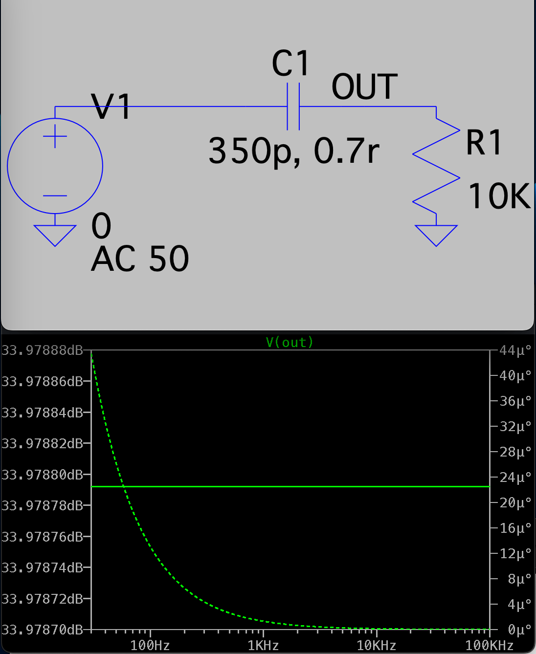

Using this a question as a springboard to start using LTSpice, I think this cable can be modeled by a 350pF cap in series with a 0R.7 resistor. Assuming I did this right, and the target device has 10KR impedance, the phase shift should be well under 40 microdegrees for most of the listening spectrum.
increasing the load to 20kR decreases the phase shift scale on the right by a factor of two; the divisions range from 0 to 22
to be clear: I'm not super confident that my analysis is reasonable. I would love to get some validation, either positive or negative.

Oh! I forgot to mention that this analysis was for the 10-foot cable, hence the capacitance = 10 ft * 35pF/ft = 350pF. the 7-foot cable should have less phase shift, I think, because its capacitance would drop to 245pF.
The resistance of the cable is dwarfed by the input impedance, rendering it negligible for all practical purposes in this frequency range.

Understood!, I've ordered the bulk cable and hope to make up any new ones I need with it. It's a less visually-obvious alternative and that's useful in my new living room 3ch installation -- lots of cables. I'll stop my off topic excursion here.I forgot to mention that this analysis was for the 10-foot cable, hence the capacitance = 10 ft * 35pF/ft = 350pF.

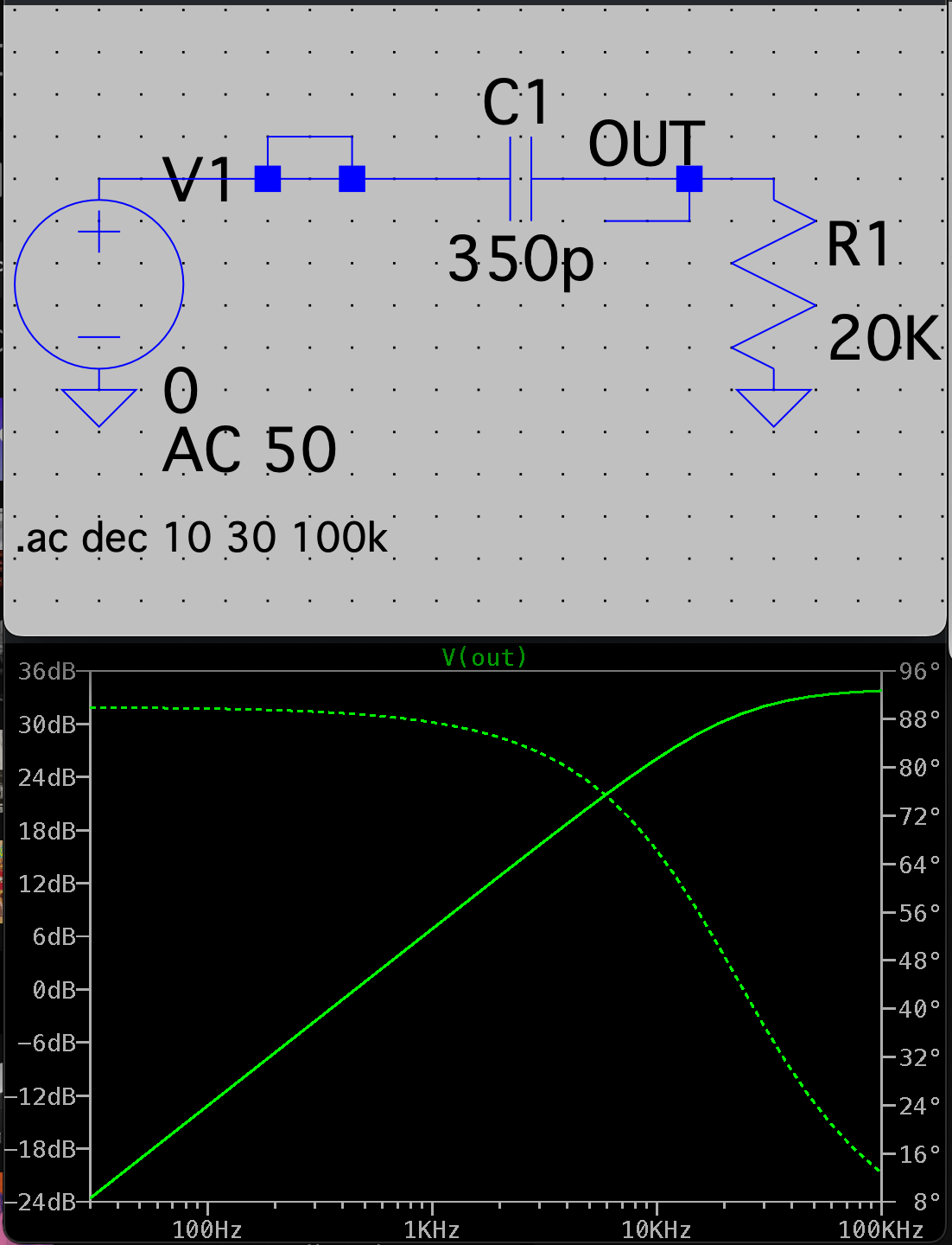

Hold on.
I was messing about, and now I get the following:
Not sure what changed, as the circuit looks the same to me, albeit with a 20K load.
The NET file:

* /Draft1.asc
V1 N001 0 0 AC 50
R1 OUT 0 20K
C1 OUT N001 350p Rser=0.7
.ac dec 10 30 100k
.backanno
.end
