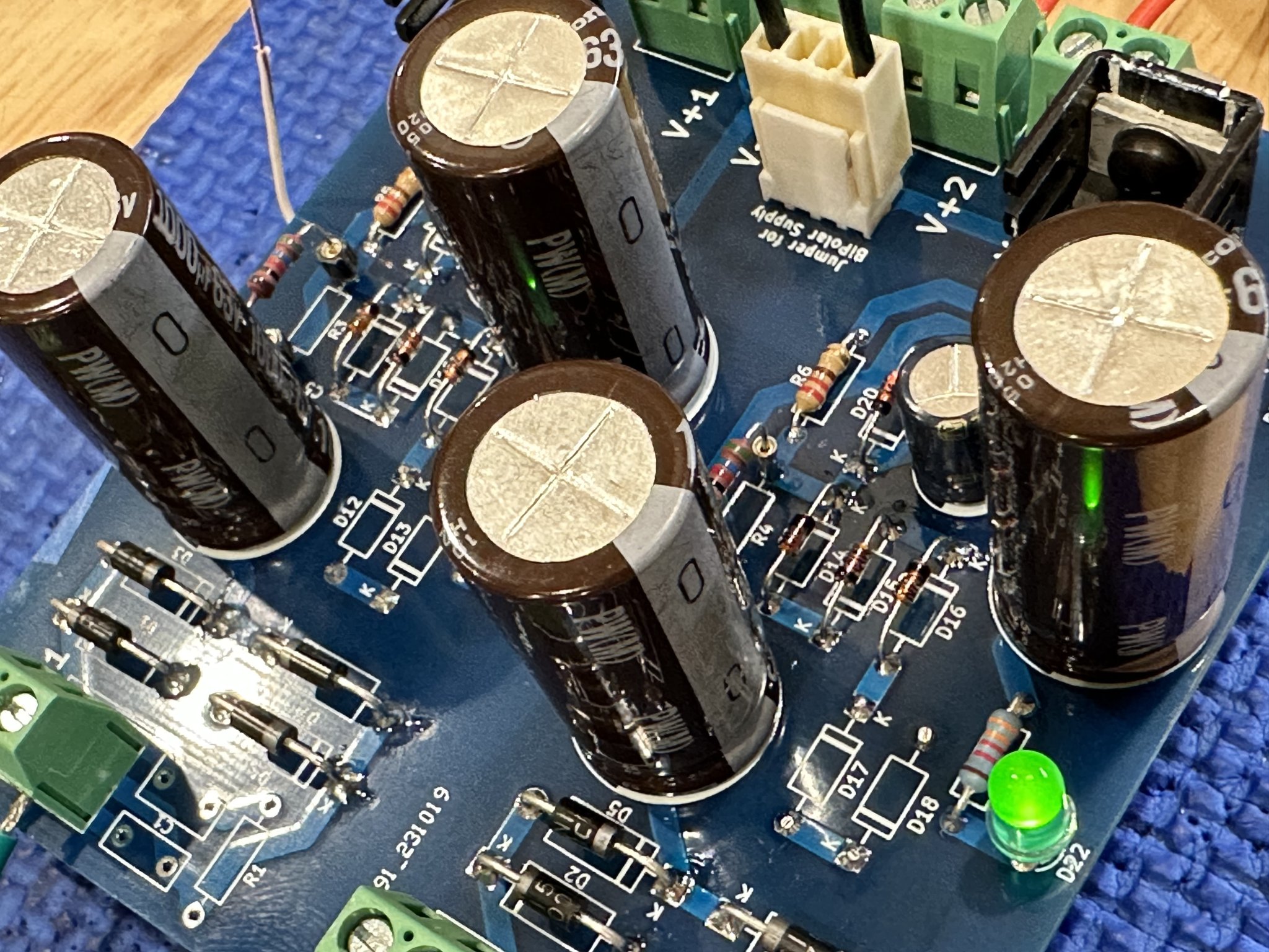

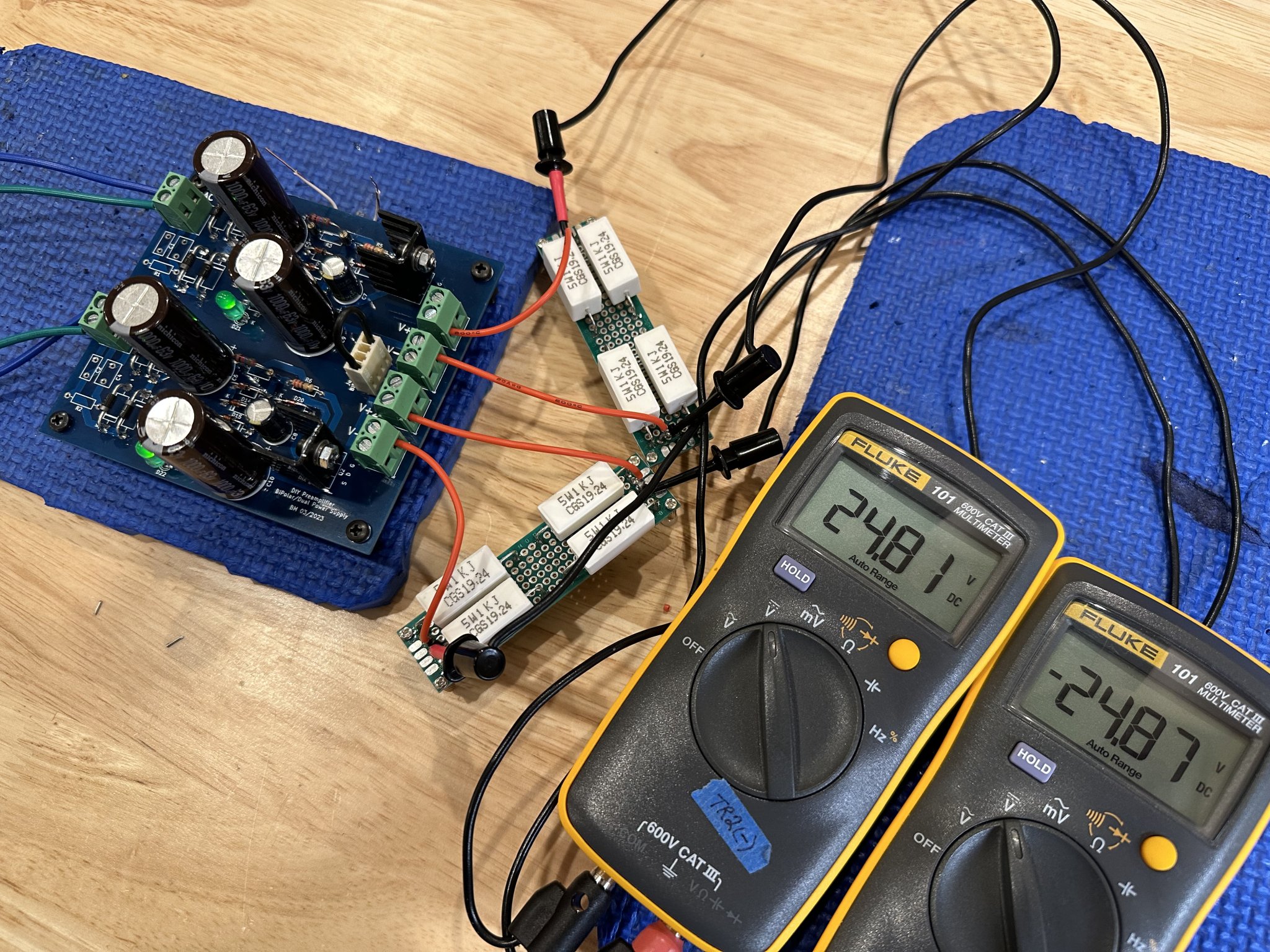

Where can I find this power supply project?Hot off the bench, regulated bipolar supply dialed in and ready to power a pair of FE2022 preamp boards.
Thanks for sharing this project @Ben Mah!
@Gerrit Kroesen : Yes, I think so. As far as I can tell, the 2sk209 is pretty much the 2sk117 in SMD form.
And the 2sk117 has the same pin out as the 2sk170 (not surprising since they're both Toshiba parts.)
