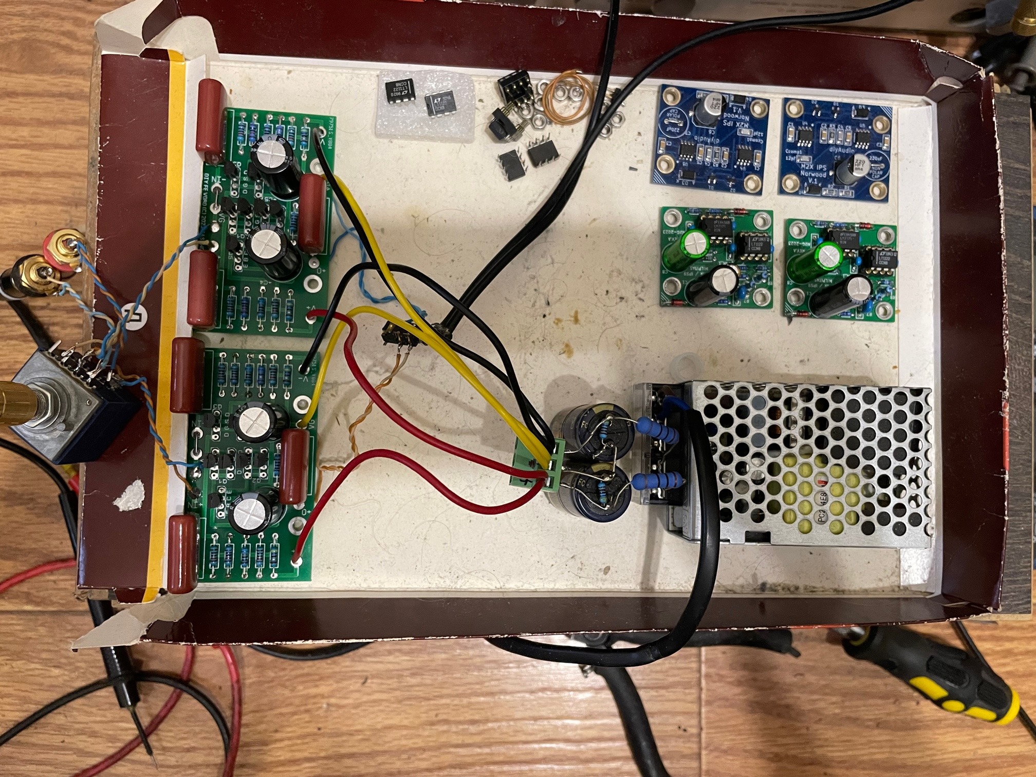

What do you want to build? A line stage or an amplifier using this as a front-end?
Single or bipolar PSU?
I got the complete kit and think it is a great deal, but I do like the look of brown vishay dale 🙂
I have a Studer 900 Chinese clone @+24VDC. Might I use it to feed this circuit as a line stage?

bipolar
you need
The FE2022 can be run with either a single or bipolar supply. if using as a “normal” linestage preamp, you dont need to have enormous voltages. A single supply of 0-24V will work nicely for a linestage.
In the recent example of @tonyEE , his stated application is to drive F4, which IS a time when the large voltage swings are necessary.

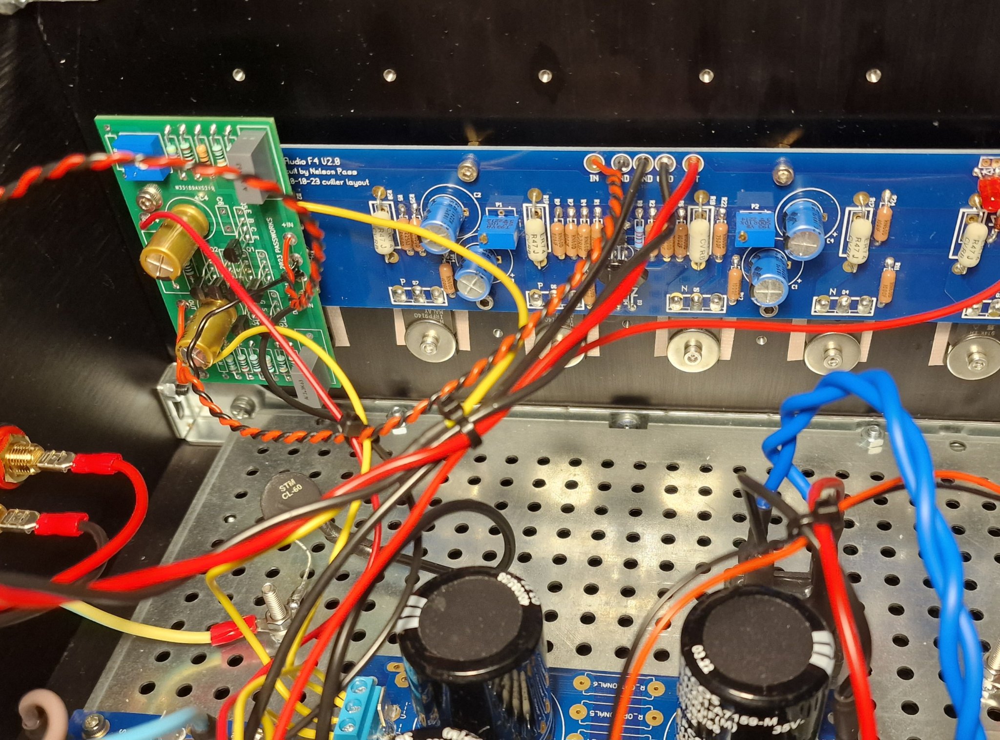

If the FE is solely for the F4, it can be installed in the F4 chassis and powered by the F4 power supply. Or the FE can be in its own chassis and a power umbilical can be taken from the F4 power supply to the FE, ala Quad II and Quad 22.
I want it stand alone. There are other amps.
