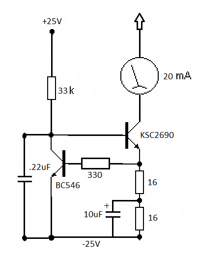

Currently my rails are 22.7V. I thought about doing a CLC with active bridge later that will bring the rails up quite a bit. I guess you get into needing to parallel some more outputs or something.... Would be nice to see a schematic of how to do this properly...

This might be beyond my pay grade... Came up with this current sink to replace Q4. Replace Q5 with a KSA1220. Would this work to get more output stage current for a difficult load? Or am I forever banished from the site for blatant ignorance.... 😀
