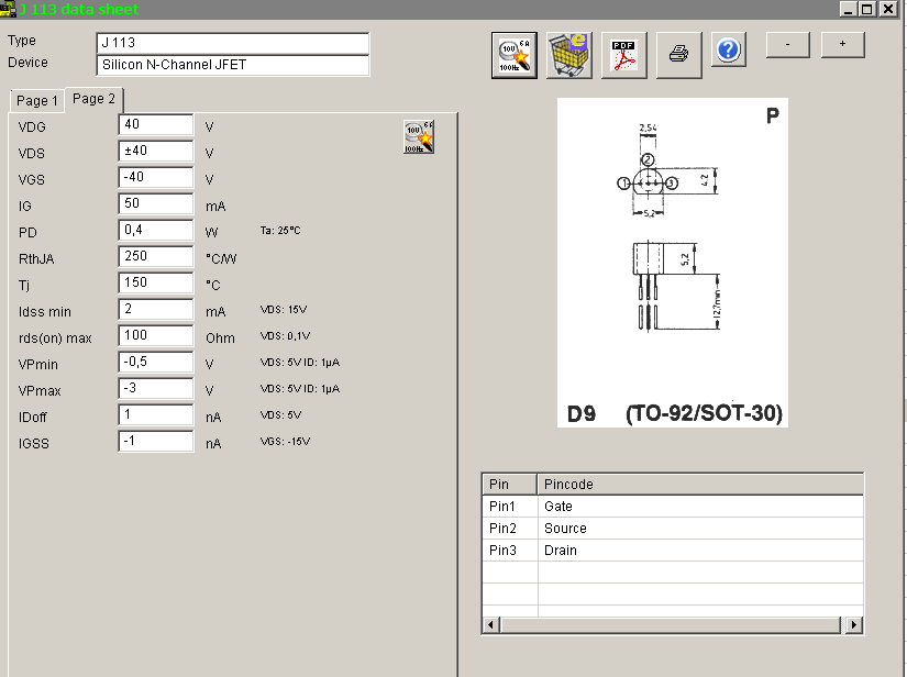

Forgive me for being ignorant here, but how do the values of R6, R7 and R8 change to accommodate other fets like K369, K389, etc? Aren't these devices N ch as opposed to the P ch J113?

J113 came from Process 51 (no known relation to Area 51 ), and was not considered unsuitable as a "low noise amp."
https://www.onsemi.com/download/application-notes/pdf/an-6609.pdf
I have some higher Idss J111 versions (and a few other types, but not J113), so may try using those here.
P.S.: BVgss is actually listed as 50V "typical."

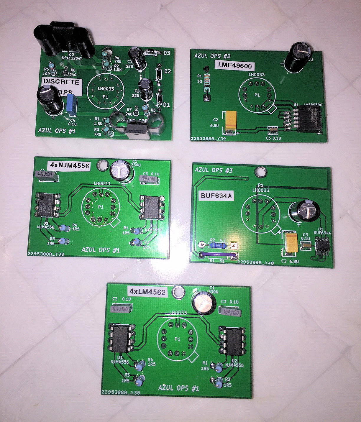

I displayed and demonstrated a DIY amplifier at Burning Amp Festival, that used the LH0033. But it wasn't an M2x.
Back then, LH0033's were so expensive that I socketed them, and for bring-up & initial testing, built "emulator cards" to fit the sockets. Better to destroy an emulator card or two, than a costly, obsolete, New Old Stock, hybrid circuit. The emulator cards were part of the display, I think Ti Kan's BAF photo essay had at least one picture of them. A photo from my kitchen table is attached below.
