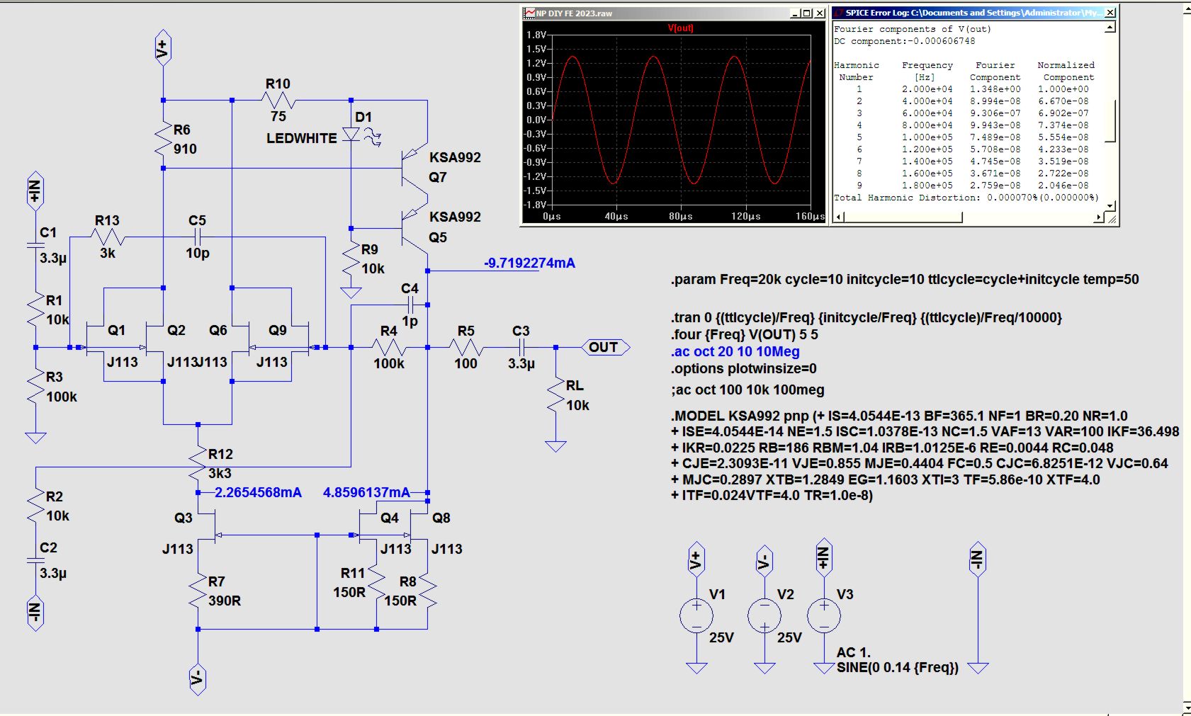

Tried so many combinations of R6 and R7.
Now everything backed to the values of Pass' reference circuit, only changed R7 to 1K. Now the offset reduced to 0.1V.
Looks like in the correct direction.
Now I understand why the essential kit has to have R7 and R8 and semis picked by Mr.Pass.

Spice file for Nelson's circuit to play with
The smallest distortions in the presented scheme can be achieved by changing R6 within small limits. If anyone needs it here.

Depends on the output transistors. The article shows a 10 Kohm in parallel with 1 nF load, @ 2.8V and the distortion goes
from around .0025% at 1 KHz to .005% at 20 Khz. As you increase the capacitance at 20 KHz it climbs to .01% at 2 nF
and .05% at 5 nF. Above this capacitance and/or amplitude it continues to climb, showing a negative phase 2nd harmonic.
In a MUFF the Cgd of a single output is the dominant load, and in the parts I have used ranges from 150 pF for the IRFP240
Mosfet to 200 pF for the Sony VFET to 800 pF for 2SK77 VFET to 3 nF for the 2SK182.
The 2SK182 is a bit of a stretch, but it depends on how hard you push it. I haven't noticed any subjective issues that I
would attribute to Gate capacitance, but I haven't tried it on an X1000...
