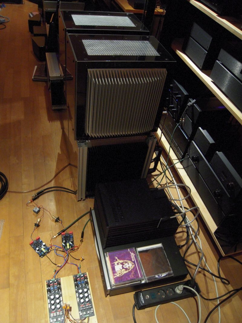

Works beautifully in my little test chassis. Note the LED+resistor hack to shine light through the vent holes to show power.
Will hook up to follower amplifier (in this case, MoFo) tomorrow and see what it can really do.

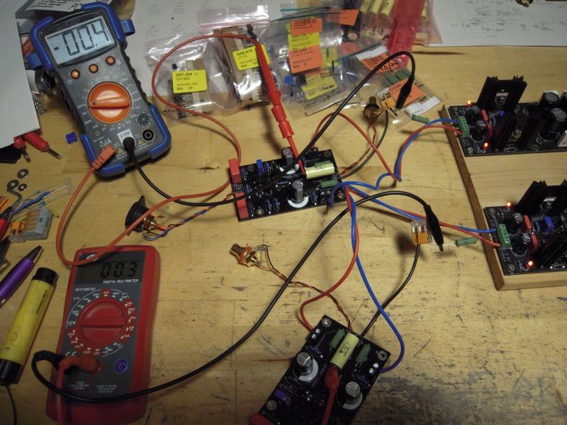

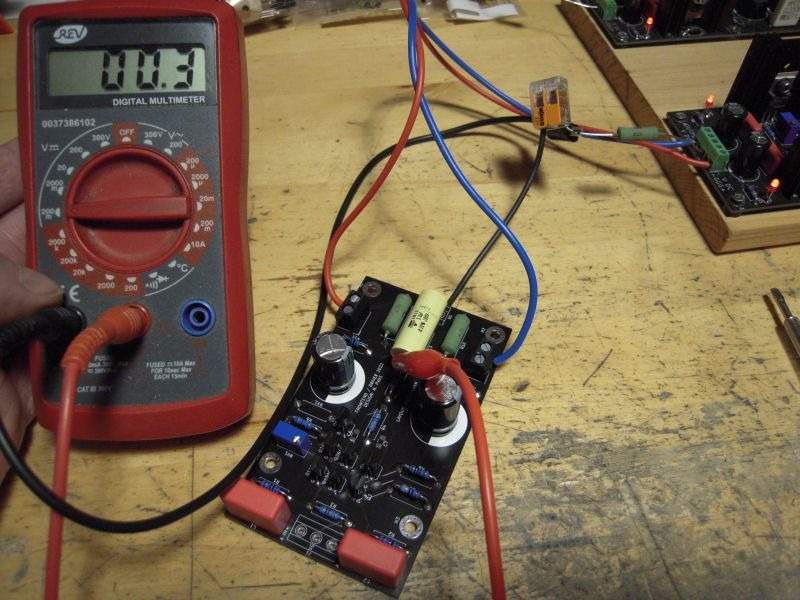

Hello Frontend2022 - builders,
I have started my boards today. All is fine so far.
The symmetrical PSU is adjusted to +- 20 V DC. It was easy to adjust the output -offset (between R5 and C3) below 1mV.
After a while of warming up, I could adjust this 'nice baby' to below 0,5 mV offset.
I think I will add some RCAs and should have a listen this night? No hurry - patience is your friend...
