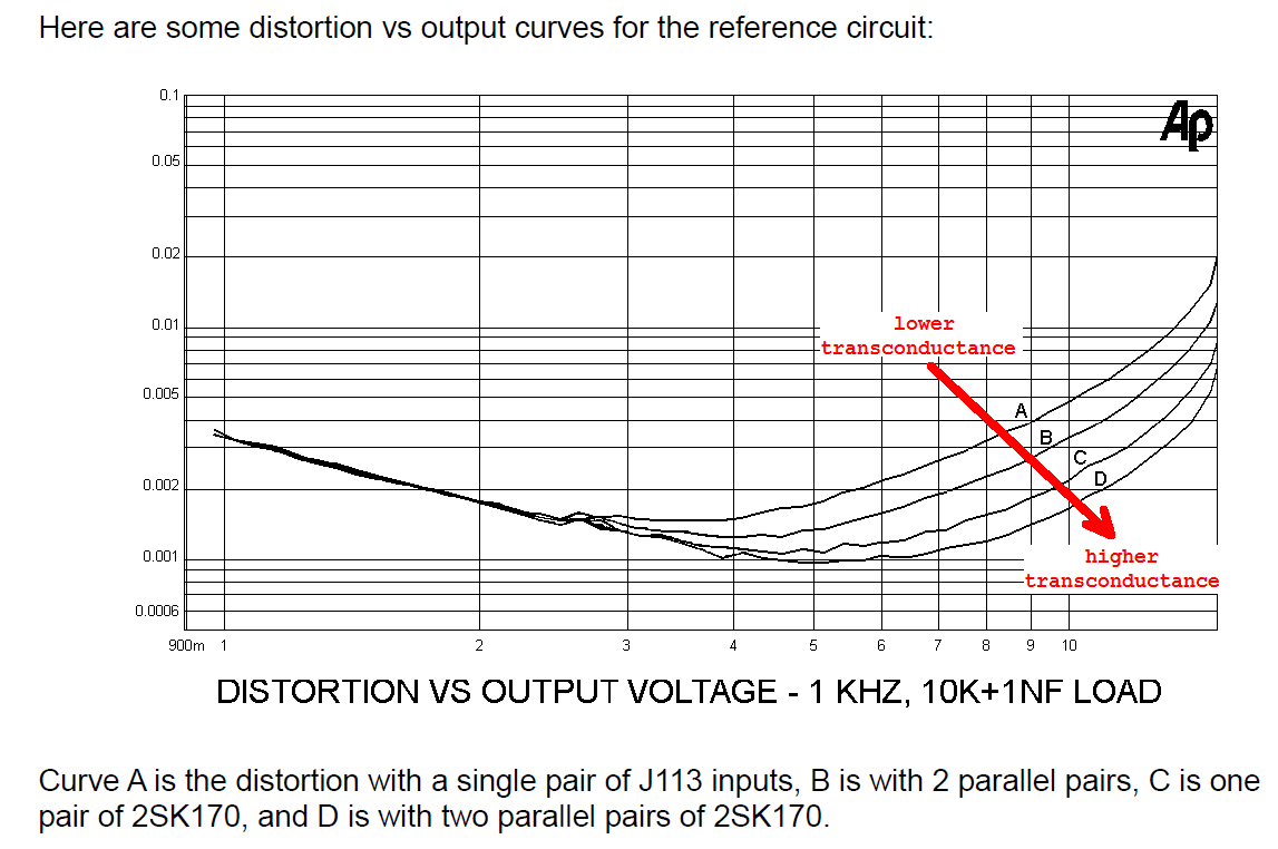

I was delighted to see the attached figure, in Nelson's technical paper about this circuit. It's one of those thrilling situations (to me anyway) in which academic theory and practical reality agree beautifully. Just exactly as James Solomon predicted in 1974. diyAudio member @Bonsai kindly makes Solomon's tutorial available online, here .
In a different thread, Nelson had this to say:
_... The J113 as an example has lower transconductance than the K170 Jfet types, and so will have less capacity for processing feedback. ... This issue can be addressed by using different quantities of them in parallel and degenerated, but it's a pain in the butt. Easier to spend a little money on the K170s.
Front end bias is 3mA total, according to post # 20.
That means 1.5mA per fet for the LTP.
Yfs at 1.5mA for 2SK170 is ~ 17mS.
Yfs at 0.75mA for 2SK209GR is ~ 8mS.
So I would definitely invest in a bunch of 2SK209GR (~30USD for 100 pieces) to get 2 quads, before I pay for a quad of 2SK170s.
Unless of course you already have the latter. 🤓

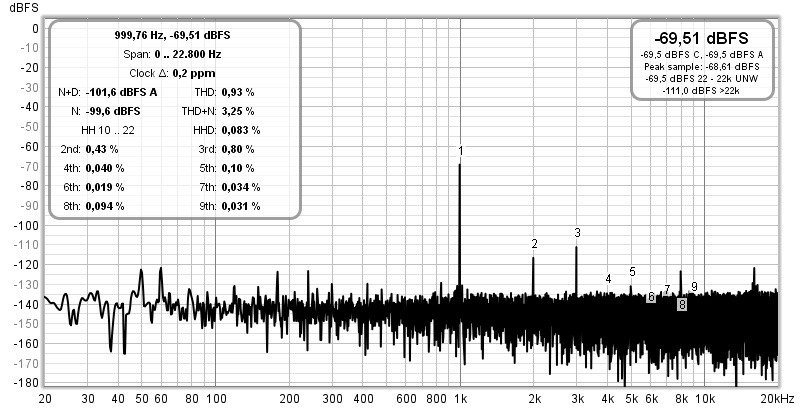

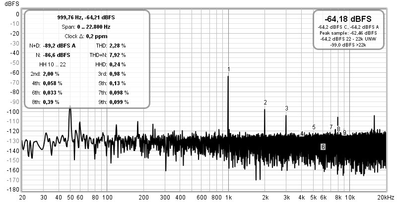

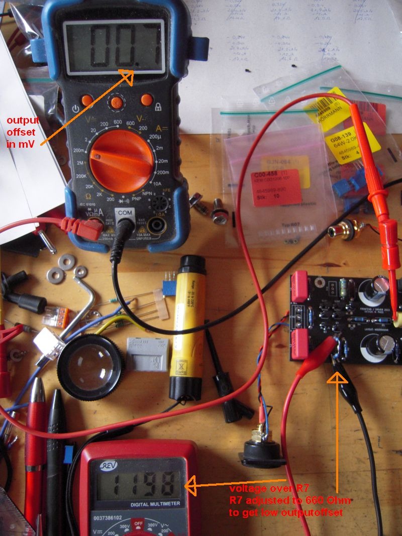

I have changed R6 to 680 Ohm, as in the original schematic. I had to adjust R7 to 660 Ohm, to get a very low output-offset (below 1mV).
I measured only 1.2 V over the 660 Ohm resistor (R7) = circa 2mA over the JFets - hmmm 🤔
seems low for me? Sounds good.
In my first version I had R7 at 330 Ohm and R6 adjusted to circa 50 Ohm. In the measurement this was slightly 3rd harm.dist. dominant.
In my second version -with resistors as mentioned above- the measurement showed more 2nd harmonic distortion.
Only some of my experiences - I don't know if they have any value?
Cheers
Dirk

Are you measuring correctly ? - i see Distortion very high even with R6 is as per schematics. What is the output Voltage when you measure the noise and distortion? Compare your numbers with the Pa' document.
Hello kannan_s,
could be that anything is wrong with my measurements. I also saw the pretty high distortion.
Inputvoltage was 2 V sinus, at output 10kOhm resistor. Forgot to measure outputvoltage.
Greets
Dirk
Greets
Dirk
