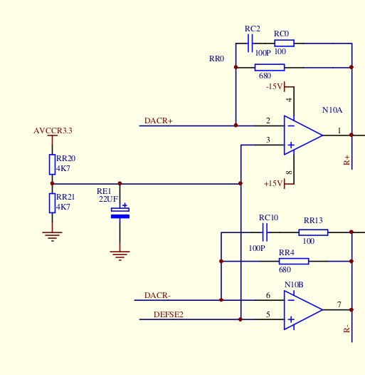

I will consider finite CMRR case.
Thus it have more than ten times smaller impact than other opamps...But at other than BPZ, the noise will reside in analog output amount of |N-32|/32*Vn at N level output of 64 pk-pk level even in infinite CMRR.
Therefore the performance will degrade proportional to RMS swing level.
e.g. at full scale sine wave have the level of 32/sqrt2 = 22.8 in pk-pk 64 level,
then (32-22.8)/32*Vn=0.288*Vn will reside in analog output.

no, the AVCC power supply and ground is the return for the IV stage, it needs to be as direct, unimpeded, low noise and low impedance as possible. perfboard wont cut it and I wouldnt trust AD797 running unity gain on perf anyway.
shinja, yes thats what I meant, but also for Clock. remember this board is not set up for any AVCC bias, so any output is not swinging around AVCC once it its the output stage. also remember that although the output stage opamps have higher CMRR, you are calculating with perfect cancellation in the output stage, with ideally matched resistors yes? that will certainly not be the case here.

AVCC bias means the 1/2AVCC bias at noninverting input of IV opamp? Ah, I forgot it.
yes yes,I know the CMRR and the cancellation will be limited by resister matching, but ignored to make my first attempt simpler.
I intended the "finite" to be such as 40dB of CMRR : 1% of gain mismatch due to 1% tolerance resister.
OK, didnt see that, its hard to tell with all those vias ... well it would help even more if AVCC was actually a worthwhile regulator. you also lose some performance by only using 3.3v, I prefer 3.6v. some push it higher, but I prefer not.
Positive and negative output pin of one differential output have noise from AVCC
each N/64*Vn and (64-N)/64*Vn
where N is the output level of positive pin and 0≦N≦64, Vn is AVCC's noise voltage.
At differential to single summation ,when their in-phase component is put as N/64*Vn ,thus differential component is |(64-N)/64*Vn-N/64*Vn|.
The in-phase component will canceled by CMRR, therefore output noise is
N/64*Vn/CMRR+|(64-N)/64*Vn-N/64*Vn|
arranging this,
{N/64/CMRR+|1-N/32|}*Vn

Full scale range sine wave have the level of 64/2/sqrt2 = 22.8 in pk-pk 64 level,
Adding 32level offset, this signal is equal to 54.8 rms level.
(revising previous post)
When CMRR is put as 40dB,
54.6/64/100*Vn+(54.6/32-1)*Vn = 0.715*Vn
