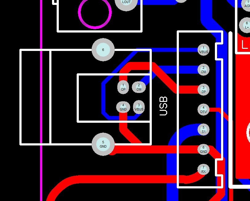

those of you who have this dac from weilang can confirm (looking at the traces) that the dac is working ONLY on spdif signal even from the USB card?
I mean , looking at the ES9018 datasheet and comparing with the board, you could very easily observ that I2S input pins are not connected to anything in the current chinese implementation
the AK4399 board which is selling on ebay and it is also designed by weilang it is working in I2S mode from the CM6631 USB card, I got a copy of the schematic and I can easily observ it there - but this ES9018 implementation I heard it is using SPDIF signal from the CM6631 board, so that's why I said that it's a lowsy design , not taking full advantage of the DAC chip's potential

one of the taobao sellers in his ad gives a clue on the spdif/usb connections and that pin 5 and 7 should be shorted when the usb module is not used. I dont think thats i2s and getting the usb module whould be probably not a very good investment.
In the dac chip d3-d5 seems shorted and i cant see whether DATA_CLK is connected to anything. Anyway over the weekend if i get the time i will try to connect the xmos board directly to the dac pins to get i2s. SPDIF sounds nice though and the implementation is not that bad.
