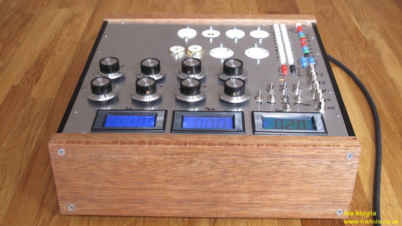

Back to the tracer subject again! Today officially completed this project that I think took me 6 months at least. I completed the chassis (bottom plate was still missing) and here it is:

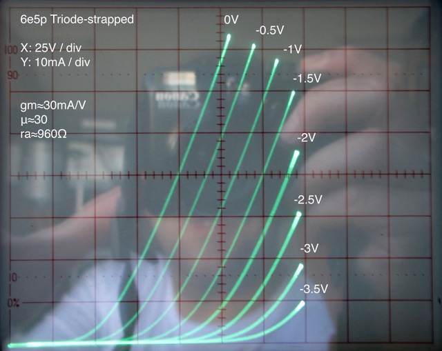

An example of the 6e5p in triode mode:

Now time to trace some curves. 😎

Congratulations!
Thanks. I may have to improve the PLL. When it get warm it drifts and require readjustment. Need an PLL expert to give me a hand here!
Very Nice Job Ale. Congrats.
Thanks Steven. Actually you made me start this project and helped me all along...
Ale, great job! See you have been busy tracing.😀

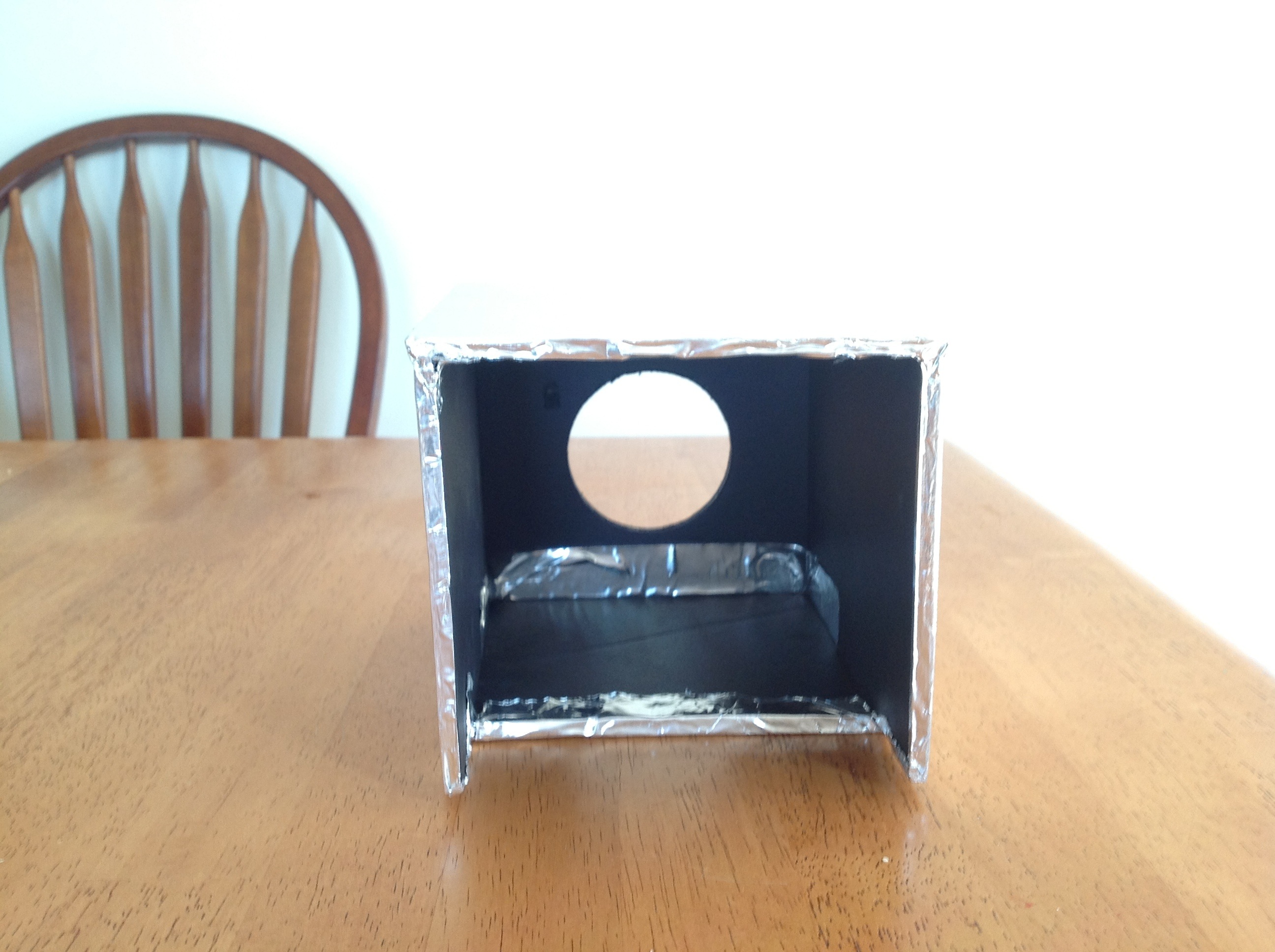

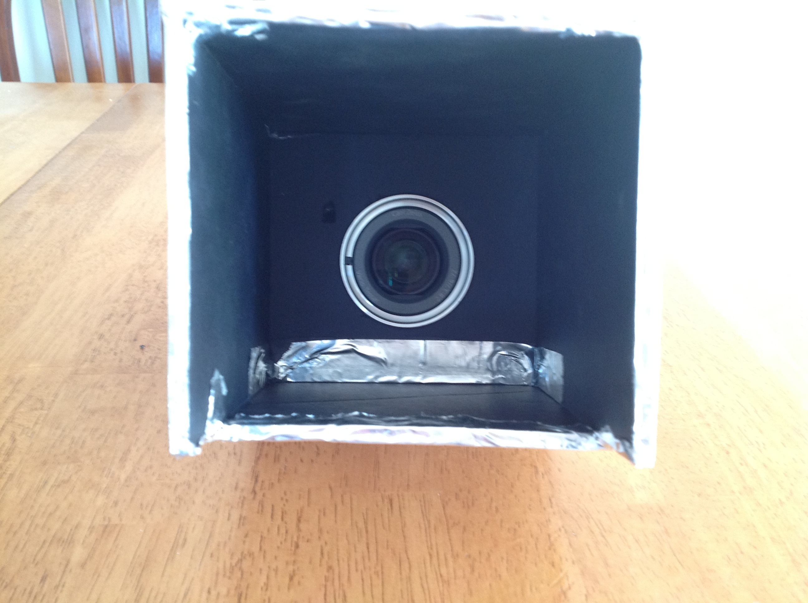

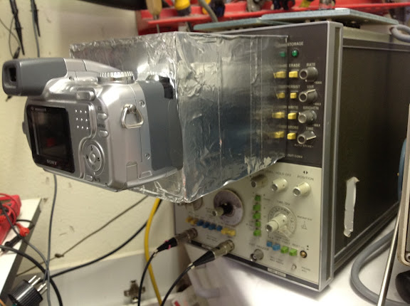

I built a camera hood that works great for me. It is made of 1/4 inch hard foam that is used for posters. The hood is light and strong and snaps tightly against the oscilloscope screen frame.

That's great! How do you manage getting the right exposure with the camera hood? Can you get to see the screen grid lines well defined? please post some pictures of the results

you'll improve the contrast of the pictures if you put some black tape over the foil facing the scope.

I will set the tracer back on the bench (working on something else) and get some pictures. Pretty sure I was using Aperture priority mode and there was a difference depending which oscilloscope I was using. For the curve tracing I have mostly been using the analog storage oscilloscope as it works like a charm. That one has more emitted light as it has no refresh problem and mostly I use the hood to get rid of nasty reflections from a upper garage door window in from of my bench. If I use the tek oscilloscope then I need to pay more attention to the settings.

Yes, reflections are horrible. I mostly taken most of my picture during the day and have a window as well on my attic just behind the oscilloscope. I guess that if I build a hood and is completely dark not sure if the grid lines will come up properly...will need to test

I have to play around with the exposure and speed to ensure the refresh is not a problem. Unfortunately the phone camera is useless here as refresh is an issue.

Yes, the darker the better. Need to do that.
