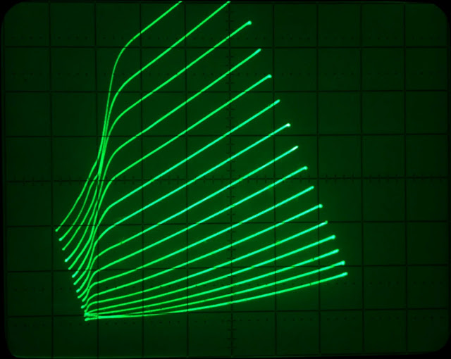

Here is a link to another thread I have been collaborating on to trace UL curves. I was able to follow some of the suggestions and use a Mosfet along with a dividing network to simulate the UL behavior. These curves show Plate Voltage vs (Plate+Screen) current. I am posting some of the pictures here as I feel they are relevant to the whole curve tracer topic.
These curves look beautiful!
Is it fair to say that the middle example approximates
the ideal (40%) AC signal for the screen grid?
It looks as though there is a nice 'triode-like' asymmetry in the spacing here.
It is possible. These was just a quick test using the mosfet to buffer the ul feedback. I will try running one test with real measurements for you. Your transformer is at 45% right? The one thing I think happens is that irrespective of the fixed DC screen voltage the UL feedback ratio may be applicable to all. Not sure though. I will try to confirm it.

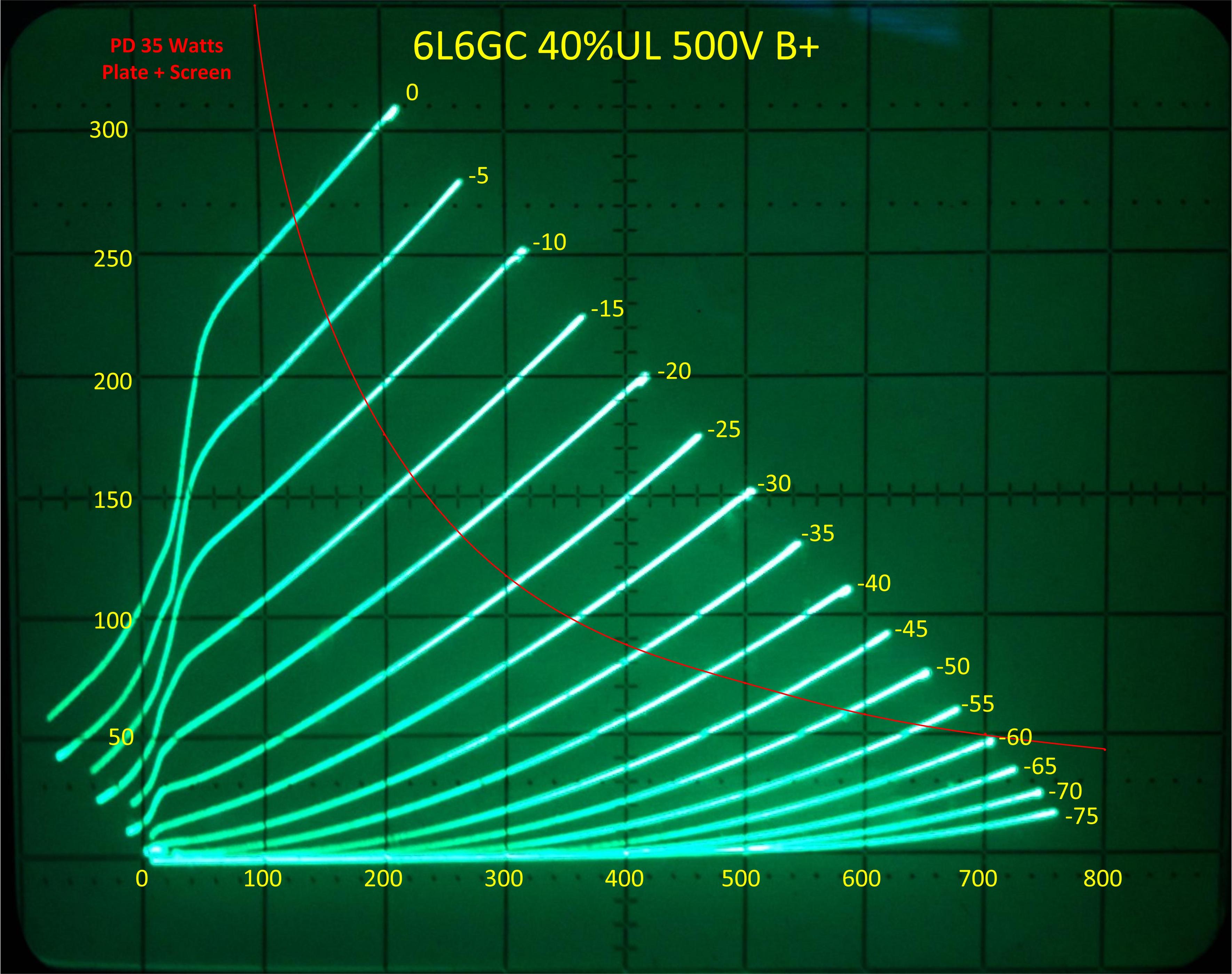

Here is the 6l6GC 40%UL at 500V B+. 800 Volts on the plate is the maximum my tracer will reach with my 1050CT transformer and fully rectified signal. Hope this helps. Let me know if you want the clean jpg.

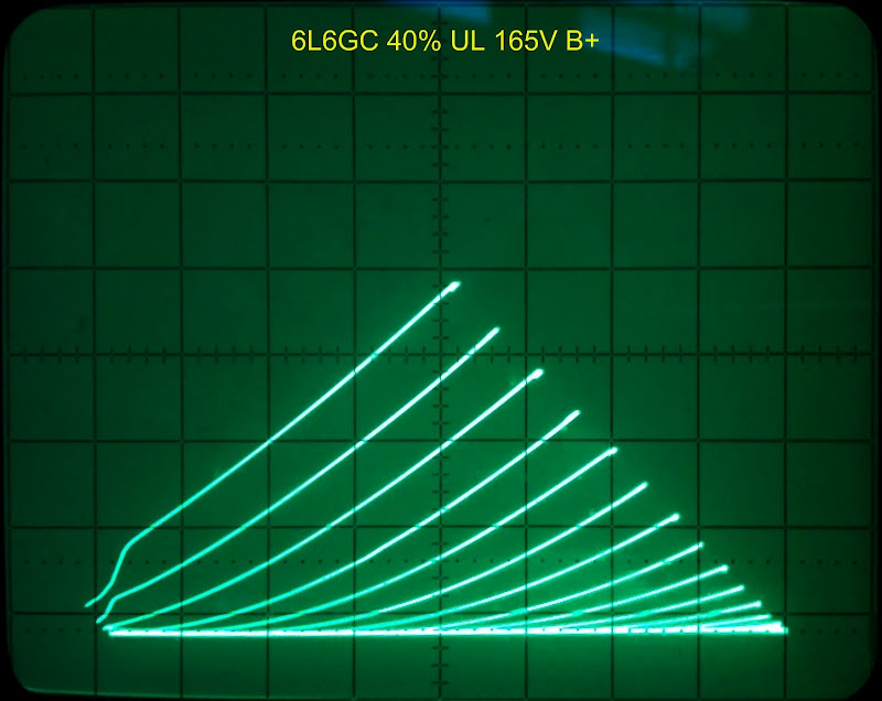

Also, lowering the B+ (and screen) does not do anything to the slope of the curves. The slope is set by the %UL. Varying the B+(and Screen) only increases or decreases the Plate+Screen current curve spread.

Wow! These curves are beautiful!
I appreciate also that you've marked the dissipation watt curve on it too!
I am wondering what is your experience here?
I know that the max design voltage is 500 volts.
But obviously people push these tubes so that momentary voltages exceed this by perhaps as much as 200 more volts!
I see you can trace curves far outside the max voltage rating,
and is it right to say that you have experienced no internal arcing at all?
Have the makers indeed underrated the tubes so much?
That is, is it safe to put 700 or even 800 volts plate to cathode,
as long as its only for short periods of time?
I am presuming that heater DC and other parameters are also being operated within boundaries
(e.g. heater-to-cathode max DC =100 v, + AC = 200 v) etc.
Thank you for tracing these curves.

I am glad you like them. The whole tracing process is very quick. I use visio to markup the picture and is also very easy.
As for my experience.... I have learned a lot from this forum and I am still learning. I am electrical engineer that never learned tubes and never designed any circuits. I am a broadcast engineer by trade. I am leaning to be more of hybrid guy, as i like both. I have been very lucky that here in Los Angeles I have been able to pick up the hobby at low cost since there is lots of surplus stuff here. It helps to have all the right tools.
I am actually enjoying doing this.
Alfredo

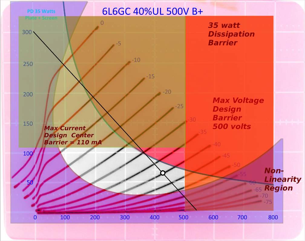

Here's what I've done with your curves:
Picking a UL loadline and quiescent point for the 6L6GC should now be easy!
Click to Enlarge:
The Crescent of creamy goodness...
