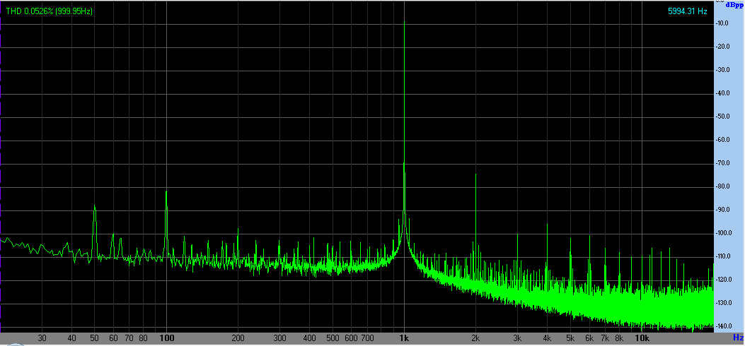

Each of all -in my collection four ST type Silvertone, and a pair Cunningham CX326- distortion spectrum below -60dB (2nd), and the best pair THD only 0.0526% (7V RMS out).
B+ 220V (Salas SSHV2), heater bias (10R/50W, Coleman regulator), 6mA (DN2540) cascode CCS anode load, 220nF FT3 teflon coupler, 100K Shinkoh resistor as load.

I need to retake the 26 measure as previously measured about 0.04-0.05% on my preamp. I'm measuring at 10Vrms output, so it should be worse.
Will look at this again!

Very good, but of course 7v isn't very much.
For comparison, I tested E282F triode strapped configured in a mu-follower (I/2 a 6BL7 on top) running 15mA at 150V. At +28dB (19v rms) THD was -59.4dB, all other harmonics were below the test equipment - -85dB etc. At +20dB out I got THD of -62.5 dB about 0.07%. I should add that in my set up the valve was driving a 20dB pad - 30k ohms.

BAD LUCK: I think I screwed up the Pete Millet's interface! That's the reason...
I just realised I got over the 10VAC rms 🙁 limit!!

had to bring my ferrograph RTS2 test set back to life to test THD somehow. And indeeed I screwed up Pete Millett's interface. Measured THD on 26 at Ia=6mA, Va=160V and Vg=-10V on a RCA ST valve and THD was 0.05% @ 10Vrms
Now, need to repair Pete Millett's interface!

Yes a good figure 0.05% - about -65dB I think. Trouble is that at these levels one really has to trust one's test gear

Sylvania 26 ST - randomly picked from the good batch of ST 26 I have:
THD=0.03% @ Vo=7Vrms - to compare against your measure above 🙂
THD=0.052% @ Vo=10Vrms - to compare against my damaged audio interface!😡
Both were tested at Ia=6mA, Va=158V, Vg=-10V using my curve tracer circuit in transconductance mode. Anode load is DN2540 cascoded CCS. Fixed bias. Input and output caps are russian PIO....
Good thing is that my tester is working, bad thing is not only that I damaged my audio interface but that I need to retake all THD measured I did yesterday 😀
