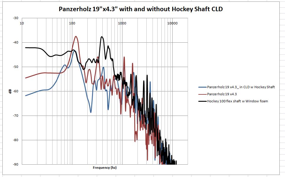

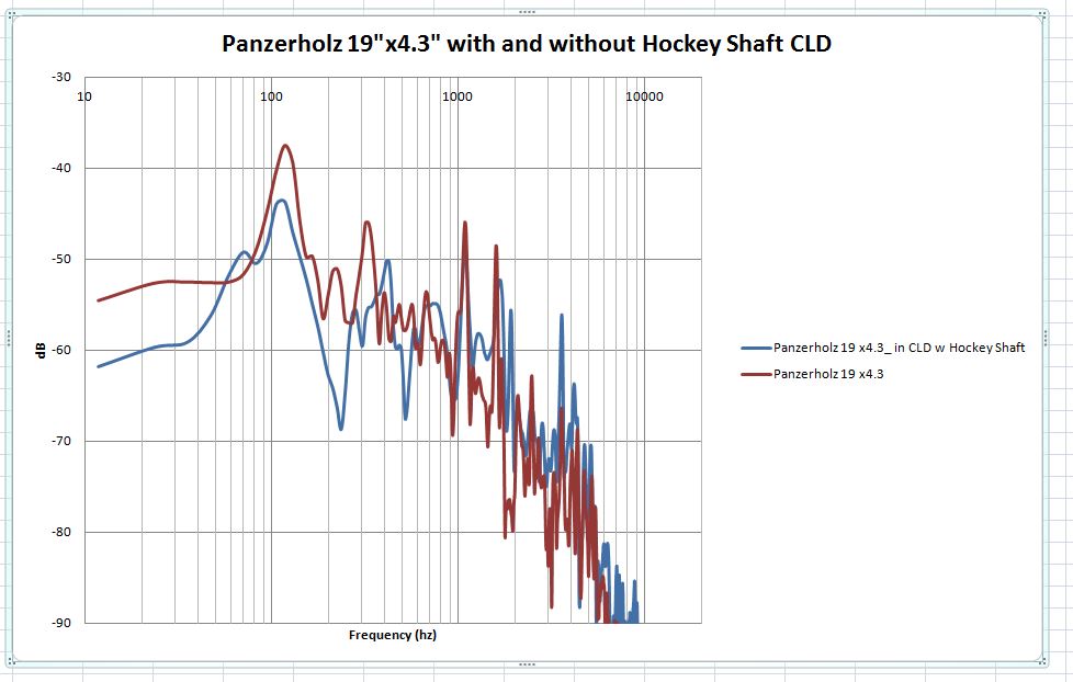

Here's what I tried last night. I wanted to see if something light but reasonably stiff could improve on Panzerholz on it's own. No Hammer yet - still marbles.
The brown trace is a 19x4.3 inch Panzerholz piece on it's own. It's supported on each end and struck with marbles as close to dead center as possible. The Accelerometer is mounted on the center of the long side.
I cut off a section of a Composite Hockey Stick shaft and filled it with a flexible foam meant for installing windows. Then I stuck it to the Panzerholz with Ductseal. This is the Blue trace.
It seems to have lowered most of the peaks by several db (while shifting a few of them a little higher in frequency).
Not an overwhelming success in my view... Above 2khz, the levels seem just a bit higher. I wonder if the characteristics of the Composite Shaft do that. It's shown as the Black trace on the second chart. (Or, maybe I'm seeing another limitation in the test method).
What I wanted to post was the shorter decay times. I may add those later if I solve that xls file problem.
Do you think this combination has a negative effect on Fc?
Hugh

the levels (height of peaks) are related to what? Traces look too jumbled to draw any conclusions.
I'm sure you are enjoying your time with the accelerometer, but Panzerholz on its own, is about as good as it gets for obtainable material. By adding more material, I can't see it getting any better. Are you chasing rainbows?
Make a plinth from 'pure' Panzerholz, with a thickness somewhere between 15mm and 25mm, and sit back and enjoy your music.
