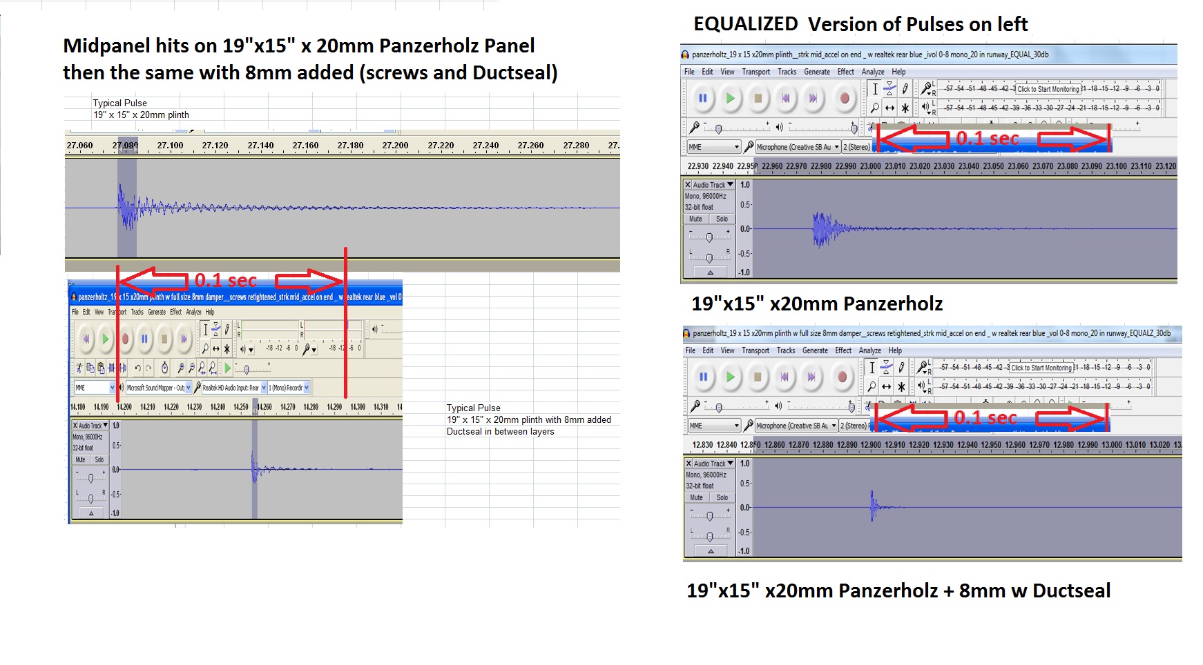

More tampering
By memory, I'm thinking I've seen damping numbers around 0.6 for Panzerholz. So, when I bought a 20mm sheet and cut out my 19" x15" panel it surprised me how lively it is when tapped. Maybe it's exactly what I should expect.
But, just to be a zealot, I added some blobs of ductseal and 8mm Panzerholz to the back and screwed it together. Surprisingly dead sounding now. But now it's total thickness is over the desired 20mm (for Fc purposes), so I'm thinking about a thinner version.
I'm attaching a screen grab of the raw pulses. You can see the additional materials do shorten up the decay time.
On the right, I've added the equalized versions. These are processed as you described, but 30db lower overall to avoid clipping.
Would you say I've overdone the damping?
Hugh
