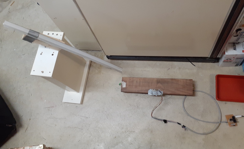

The jig
The final use is a Turntable plinth, so I mostly tested pieces that were about 18 to 20 inches in length. The widths were around 2.5 to 4.3 inches. Maple flooring, MDF, Birch plywood, Panzerholz are among the pieces tested.
The viscous layers tried were GreenGlue (from HomeDepot), an Underwater Butyl tape, Duct Seal and a couple of stretchy latex adhesives.
When I suspended the pieces and hit them with a Golf ball, the lowest resonances were typically 200 hz, 350 hz or so. Later, I placed the test pieces on the Concrete Basement Floor with audio points supporting the ends. Hopefully I just attached a photo of the jig.This typically lowered the first resonance peak by half (100 hz to 250 depending on the materials).
The grey piece on the left is a guide. I slide 5 or 6 glass marbles down the incline to strike the test piece. The mass of tape and wires near the middle of the panel is the Accelerometer. Audacity collects the pulses in an old PC.
Now, did that file attach?

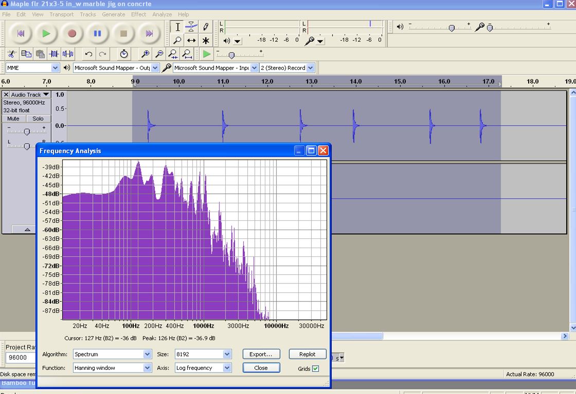

Collecting the measurements
It was not such a good idea to do this in front of the Beer Fridge. Lost some of my marbles underneath.
Hopefully, this is a valid method (comments please)... Here's a shot of six pulses collected in Audacity. I selected a window that engulfs the lot, then hit "Analyze" then "Spectrum". A window pops up showing the FFT results.
The "Export" button allows the FFT data to be saved off - and I did.

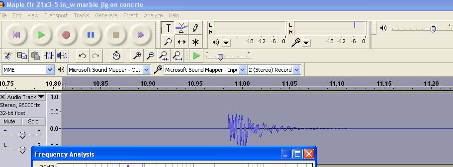

Then, I window around one pulse and zoom in to see the length of a pulse. In this case the target was a piece of maple flooring on it's own (no damping). The ringing disappears from view after about 0.13 seconds. CLD does improve on this in most cases.

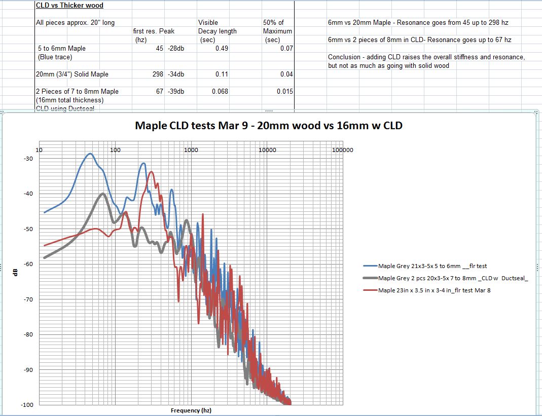

CLD vs Thicker wood
I can't see anything on the Accelerometer that convinces me I'm seeing Fc. Do you suppose that exiting the panels with sound would show anything? Maybe with a Microphone on one side?
Here's another chart showing what CLD seems to do on thinner pieces of Maple. (I'm not making the plinth from Maple, this is just material on hand).
All pieces are about 20 inches in length. The Blue trace is 6 mm thick maple. The brown trace is 20mm maple. Notice how the first resonant frequency goes way up.
The grey trace is (2) 8mm pieces (18mm total thickeness) with a thin layer of Ductseal pressed in between for Constrained Layer damping. This makes the pulses decay more quickly than wood alone.
It also raises the resonance a bit (vs. 6mm piece alone), but likely not as much as a solid piece would have. So, minimal effect on the first resonance and overall stiffness.
I'm guessing the effect on Fc would also be less than increasing panel thickness. Thoughts anyone?
Hugh
Hugh
