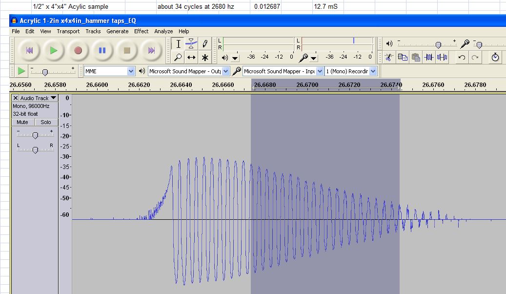

Acrylic on it's own has a damping factor of about 0.07 according to Cat's squirrel. I get similar results - about 0.05.

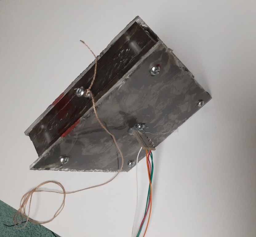

I wondered how Acrylic might work out in layers with viscous material (Ductseal) in between. Ductseal is not an adhesive. It will pull apart under force. So, I started with a single bolt holding two 1/2" layers of together and mounted an accelerometer with hot glue. The DF was pretty good - 0.2.

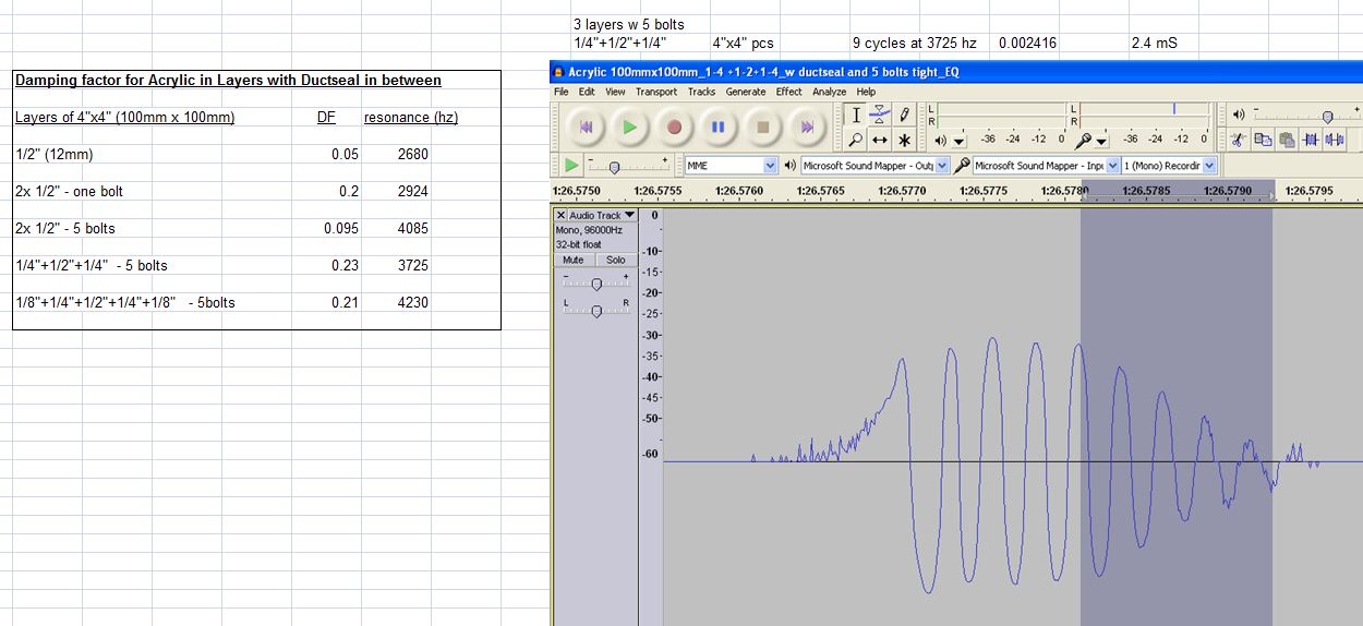

Then I increased the stiffness by adding moderately tightened bolts in the corners (now 5 in total). This reduced the damping factor to about 0.095. Loosening the bolts allows for more damping, but the resonance and stiffness goes down.
Then, I tried other combinations with more layers (and 5 bolts, trying to maintain stiffness). These are tabulated in the attached photos. A 3 Layer combo of 1/4" + 1/2" + 1/4" seems to be the best so far at DF = 0.23.
For the final 5 Layer combination I added 1/8" outer layers (pictured in photo). This did nothing for the DF, but did seem to raise the resonance and stiffness.
Notice that the single 1/2" x 4" x 4" sample shows visible ringing for 12.7 mS on the logarithmic scale I picked. The 3 Layer combination (1/4 + 1/2 + 1/4 inch) reduces this to 2.4 mS.
I'm thinking this could be a good method to make a plinth, Audio shelf, or even a platter. However, Cat's Squirrel did find some shortcomings when he was testing materials for CLD. So, this too may have a downside.
I would guess that the increase in damping would be effective above and below the Critical frequency Fc. I won't be, but if I was scaling this up into a plinth size , I'd likely put the bolts at 4 to 6" intervals around the perimeter and place one or two between the platter and tonearm.

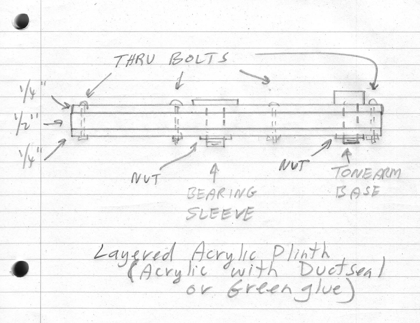

The compliant layer is a problem when used as a plinth material (or top plate). The bolts, although they confer a tiny amount of damping, just connect one side of the structure to the other, conveying vibrations.
Thanks Cats squirrel. Good to know. I'm going to post a sketch later and ask for you to take a look to be sure I'm grasping that one.
Cat's Squirrel,
Just to be sure I'm making it clear how the platter and tonearm would be attached in this hypothetical Layered Acrylic plinth, here's a sketch. The nuts for each would compress both layers together.
Hugh

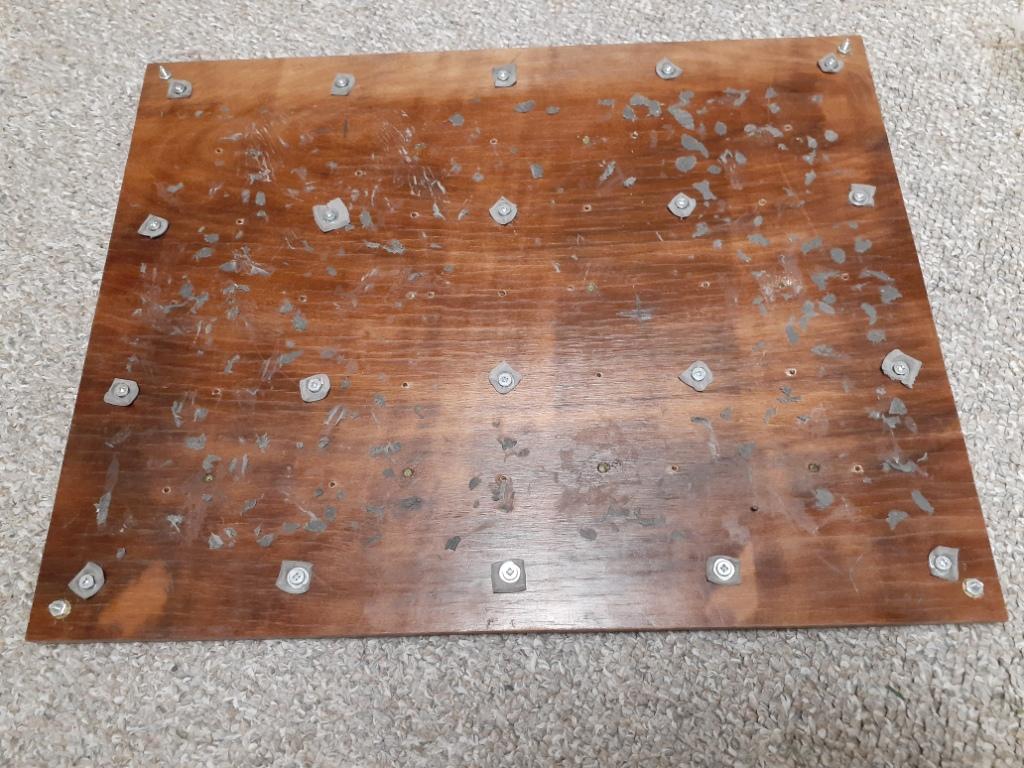

Layered Panzer
John,
Forgive the shabby appearance. Here's a top and bottom shot of the 2 Layer Panzerholz Plinth. I was actually trying to get 10mm Panzerholz, but got a great deal on the last sheet of 8mm.
The woodscrews are spaced at about 4" increments. This is mostly because the sheets are not so flat. The bit of foam under the screws was an experiment with the amount of pressure. It can be omitted.
It's Greenglue in between the layers. There's several small holes to let the excess glue bleed out. A thin layer is better than a thick one.
The panel sounds very dead when I strike it. I did get some reasonable waveforms from the hammer test. If memory serves, I think I got a DF of about 0.35.
I also tried attaching a third layer of P'holz - no better. 1/8" Vinyl floor tile - no better.
I haven't actually tried this as a TT yet, so I can't promise it's worth the extra money over other materials.
Hugh
