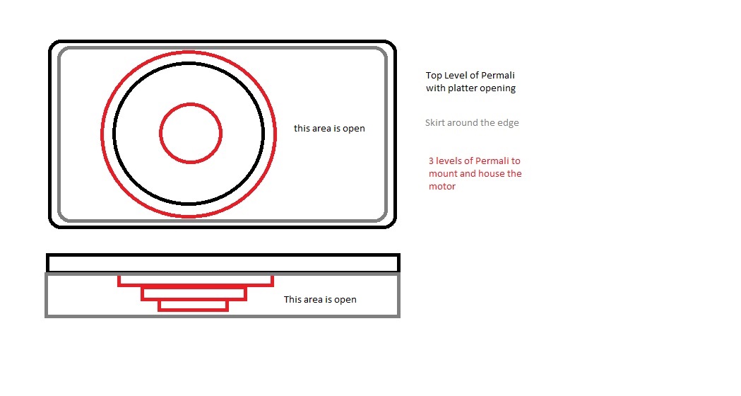

A question for those experienced with Panzerholtz/Permali.
I am looking to build another SP10mk2 plinth from Permali. In order to house the motor mounting housing and a 60mm deep platter the plinth is needs to be 145mm thick. I can source 24mm Permali no problem.
I was considering using 2x 24mm sheets of Permali and laminating MDF in between the Permali to increase thickness, with MDF as a top ring for aesthetics only. The arm and motor mounting layers will be Permali. So the layers will be MDF, Permali, MDF, MDF Permali, MDF, see attached drawing.
This is not CLD it's only to keep weight reasonable so it doesn't crush my rack and cost. Does anyone have experience with this type of construction?
EDIT: I've just noticed the notes didn't print. The grey teardrop section on the right is the plinth

If I am interpreting your diagram correct.
The placing of Permali within the Teirs, is to support the Chassis, and additionally Permali seems to be used to recieve flanges from the TT Housing belonging to the Sub Chassis Housing Parts, using Permali as a mounting Base for the parts with a Flange ?
It also looks like the Base of the TT's Housing is to be seated on a the lowest Teir.
To reduce the mass, and stay closer to the suggestions that are made, as a result of the measured Data, used to support how to produce the best performance from a Densified Wood.
Could a Plinth have a Skirt Surround used to produce the Desired Depth.
Permali Cross Bracings produced to the minimum profile needed can be attached to the Skirts, being used to produce the lower Teirs at the heights shown in the Diagram for the Flanges and Base.
On Lenco Heaven Forum the TTS 8000 Thread will show a Plinth Build that has a similar method as my suggestion.

There will be 3 bolts upwards (not shown) through the base touching the motor bottom housing to add some tension to prevent vibration. SO the motor will not be touching the bottom layer. The motor mounts to the second layer of Permali it's shown raised slightly as there will be spacers between the motor and wood.
The issue with the TTs 8000 style plinth is the cost of the wasted Permali would be hundreds of $$. Permali is about $200 per layer.
If adding MDF fillers between the Permali will negatively impact sound I'll scrap the Permali and make a mold and cast in resin/bentonite.

What is your opinion on this version. This uses a 24mm Permali top. The RED is Permali fixed to the underside of the top for motor mounting. The GREY is an MDF skirt for aesthetics and mounting the feet. Or would I better to leave the skirt off and make the 3 motor mounting circles the same size?
The Method to myself looks similar to other designs I have seen.
Whilst Looking at the Design as a Diagram, I can see one additional option that could be considered.
The Skirt could remain as a Separate Part and maintain the aesthetitic.
The Skirt can have a Footer on the Base and at the interface with the Plinth, a Small Space can be created between the Top of the Skirt and the Plinth using for example a Threaded Spike, or another type of adjustable Support, with any preferred choice of Contact Surface for the Plinth.
This will add another level of control for levelling and Preferred Isolation.
The last choice would be if either the Plinth or the Skirt Wall will have the Female Thread Part inserted to receive the adjustable Male Thread.
Hi CS,
as I have mentioned several times, I would NEVER use mdf in any design.
not mdf, but other (highly damping) stiff material. If you do as you suggest, you have a panel with a clamped edge (actually four clamped edges). That will dictate how the panels will vibrate. However, if you use four 'pillars' to support the top panel, the result will be virtually the same. But I would suggest separating the tone arm (pod) from the turntable. Not so critical with the SP's, but a useful thing to do. It allows easy swapping of tone arms, if that's your thing.
https://flic.kr/p/2m6i6dXsimple plinth by cats squirrel
DO NOT use any soft (compliant) material in the design of the plinth, except underneath the total bottom panel.
Re your comment about compliant material. Does that mean you would not recommend replacing the pillars in that design with 4 squash balls and that you would be better off if the pillars were panzerholz?
depends on how squashy the squash balls are going to be. Too compliant ( yellow spot) and the answer is no, but 'hard' (blue spot) and you may get away with it. Not sure about green or red ones. I am sure Panzerholz pillars would be better.
