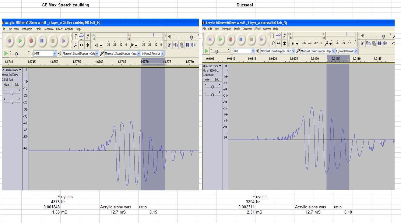

Here's a screen grab of what the accelerometer picks up. These two waveforms have been equalized and are displayed in decibels.
The right side uses Ductseal between the layers. (12mm Acrylic/14mm mdf/ 12mm Acrylic). I'm calling this one CLD.
The left side uses a Latex/Silicone Caulking called GE Max Stretch. I think this one may also be in CLD territory. Oddly, the resonance is higher.

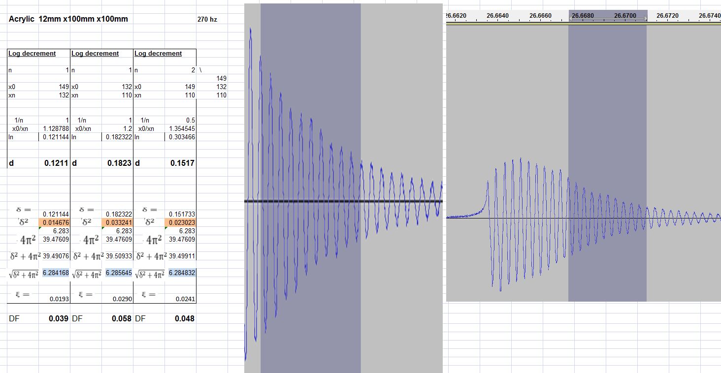

The waveform as displayed dies out in about 1/5th the time as Acrylic on it's own. (I.e 2 milliseconds vs 12.7 mS for Acrylic). So, it seems to be effective. I got a about 0.2 when I calculated the DF.
I'll pull it all apart and try an adhesive that's stiffer next.

Those scans you posted look highly suspicious. Try not to use the log (dB) scale except to look for linearity. The frequencies are not correct, and way outside the capabilities of the accelerometer. For mdf alone, 100mm x 100mm x 10mm should have a fundamental resonance frequency around 500 Hz, the other layer/s would increase that slightly.
As regards cld, I apply that term to very thin layers of material which must be able to flex (to work properly). All other constructions with layers are called laminates, specifically glued laminates, or 'glulams', much loved by the building industry since Victorian times.

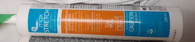

The "adhesive" is GE Maxstretch. I think I got it at Lowe's. I wouldn't recommend it for any real application. It stretches and breaks apart too easily. But for this test, it will hopefully be easy to strip apart.

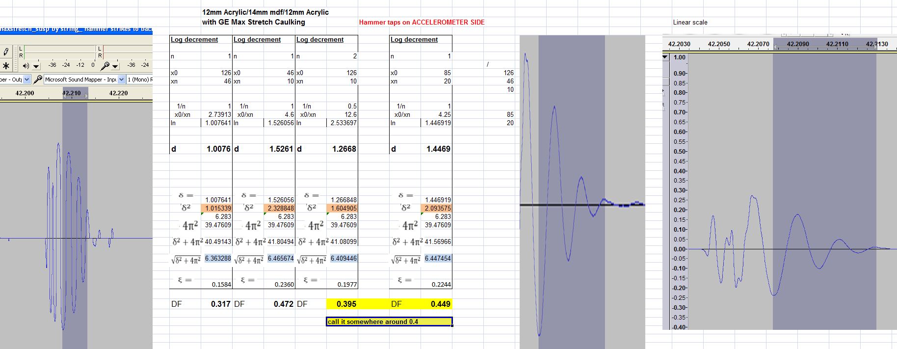

With a bit of HF filtering, here's what I get fro the Acrylic/mdf/Acrylic sandwich.
Resonance is about 650 to 700 hz. DF is around 0.33.
Cats, does this look credible? I found lots of ways to muck it up.
Hugh

Hi Hugh,
it certainly looks better, and more like what I would get.
BUT, the waveforms are very asymmetrical, leading to wide variation in results, but calculations look about right.

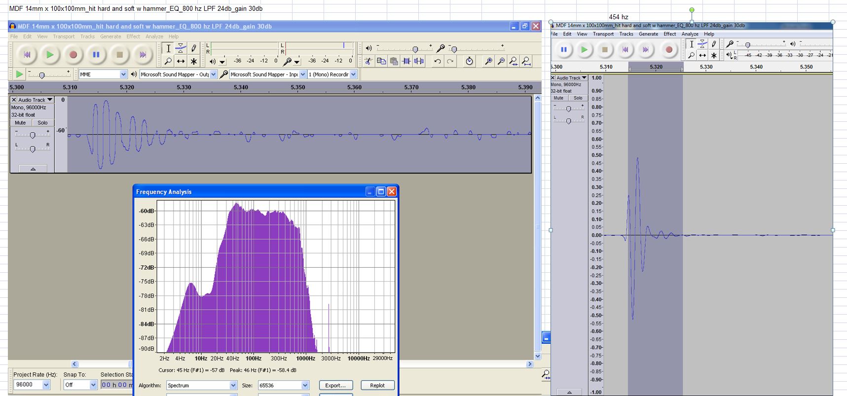

Although asymmetry is often present, it's maybe not as much as you have. Can you show a scan of just mdf?
What you seem to have with your construction is extensional damping, where one piece of mdf is being damped by the caulking and the other piece of mdf. If you have the accelerometer on one bit of mdf and you tap it on the other, it may give you a more representative answer. Try measuring and tapping on the same side. 🙂

MDF on it's own was a mess, but I think I have one semi-decent example I'll post a little later.

Here's a repeat test on the Acrylic/mdf/Acrylic with MaxStretch caulking in between. This time I tapped on the side with the Accelerometer.
It was much tougher finding a logarithmic set of pulses. In this example, the DF appears higher, but I had to try several Low and High pass filters to get something close. I don't put much faith in that 0.4 DF.
Hugh
Hugh
that looks a lot better. From your traces, I calculated a value of 0.0545 +3% - 1%, which is acceptable!

Yes, it's elastic. Do you consider this as a good combination?
The label says "800%", but that's likely based on when it snaps off when stretched. It's firmer than green glue.
