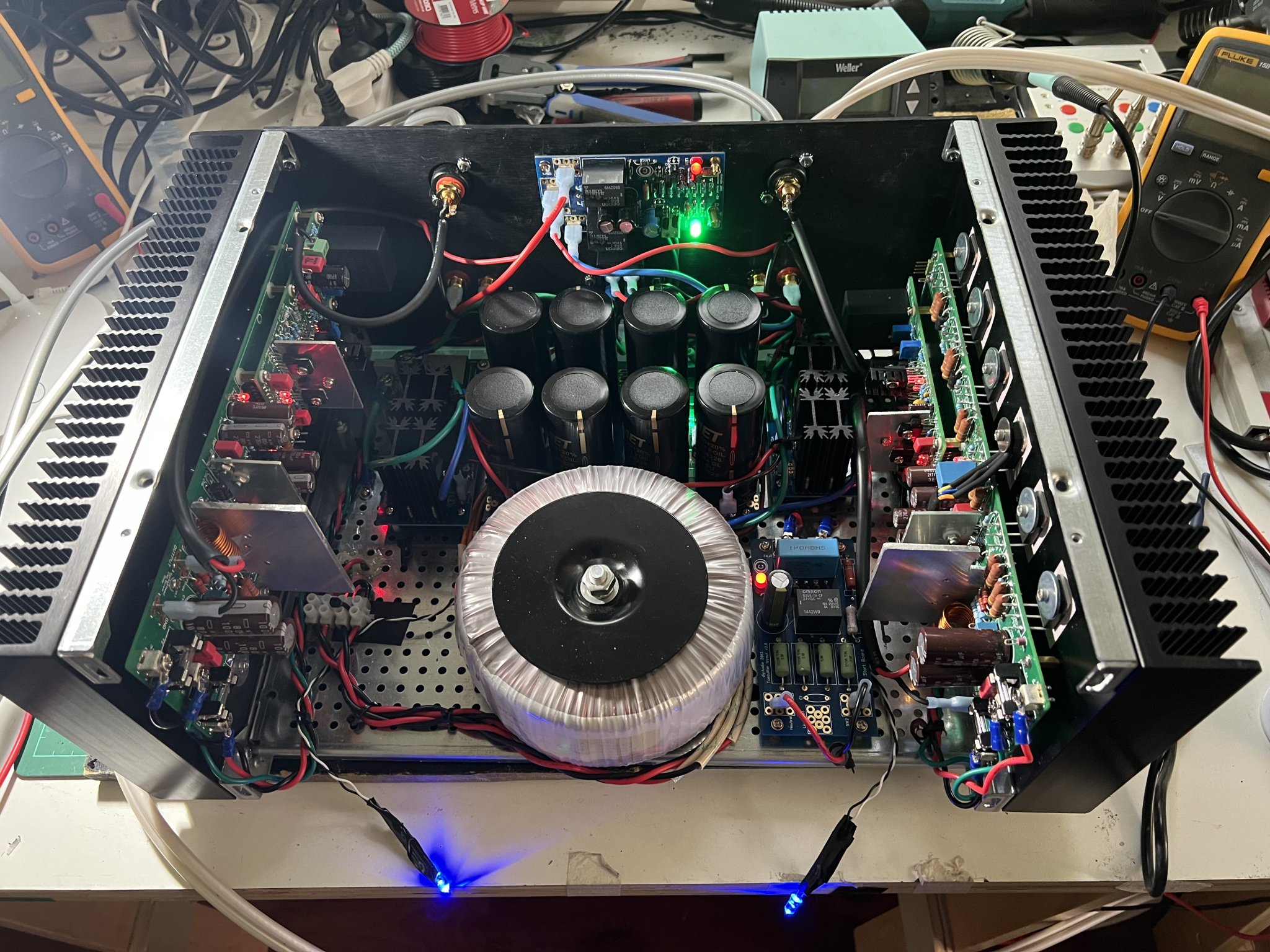

Second Wolverine eventually up and running and sounds as good/great as the first one. The first one was a EF3-4 in a 5U box and this one is a EF3-3 in a 4U box….a bit of a tight squeeze but nice not having to tap holes in the heat sink.
Both use a 56v power supply which i was going to use on a pair of Class A mono blocks. After building and listening to the Wolverine I shelved any Class A ideas I had…the Wolverine is soooo gooood!!!
It’s a fun and great project and the end result is incredibly satisfying!!!
Thank you Wolverine team!!!

A very nice example for me in terms of layout. It puts me in doubt how on earth I could fit in 2 transformers, one for each channel with 2 PSU's in there as well. Stacking the transformers is one thing but the 2 PSU's is another.......hmmm
