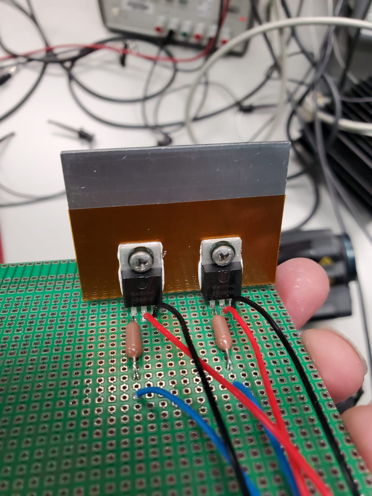

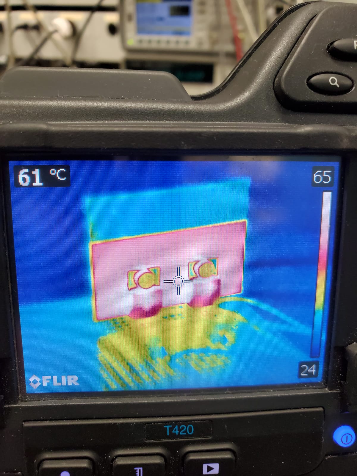

Hi @kokkieAnd while we're at it, can somebody explain the reason behind the increased thickness of the driver heatsink? Is it only to house the two pins that hold the heatsink in place ? From a thermal point of view it does not add much, unless more thermal inertia is a desirable feature. Please note I am not criticizing this fantastic project. I just want to understand and try out variations on a theme.
Ronnie
The size of the driver heatsink was something that the Wolverine design team debated and studied in detail over a few weeks.
As with all designs there's not always a perfect solution. However we wanted to get as close to that as we could.
We discussed the following.
- The first was space as we were trying to fit everything onto a board as close to the size of the Honey badger as possible while still allowing for a UMS mounting.
- The second was heat, We had to maximize the size of the heatsink and minimize the bias of the drivers without affecting the performance or causing to large of a temperature rise.
We simulated and tested many combinations of driver transistors, driver emitter resistors and heat sinks dimensions while logging temperature and performance data.
Ultimately we also needed a secure way of mounting it. The mil-max pins do a great job of removing any stress on the transistor legs.
This site was also very useful.
https://www.giangrandi.org/electronics/thcalc/thcalc.shtml
So please rest assured that the size of the heatsink is Optimal. I certainly would not make it any smaller.

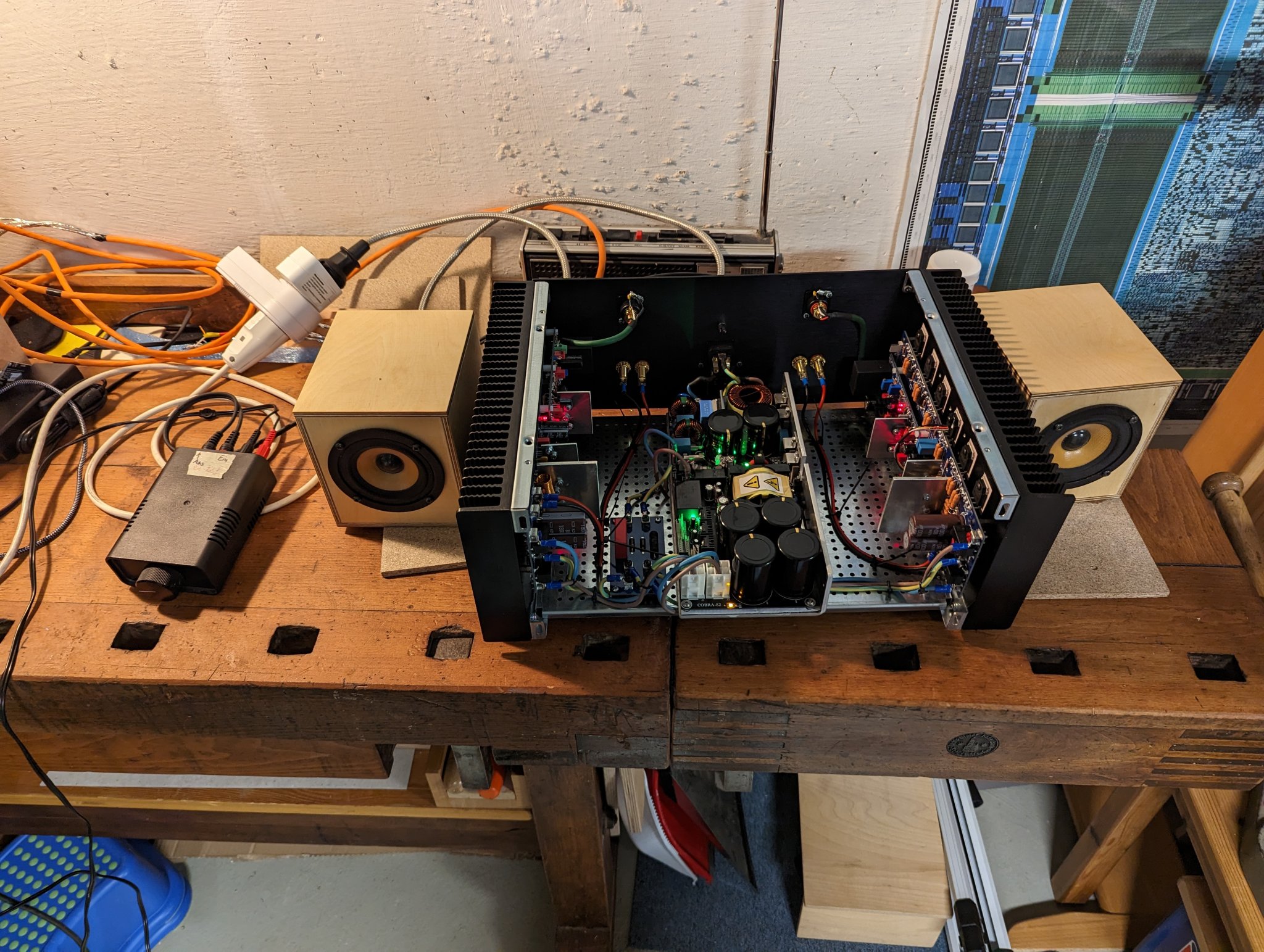

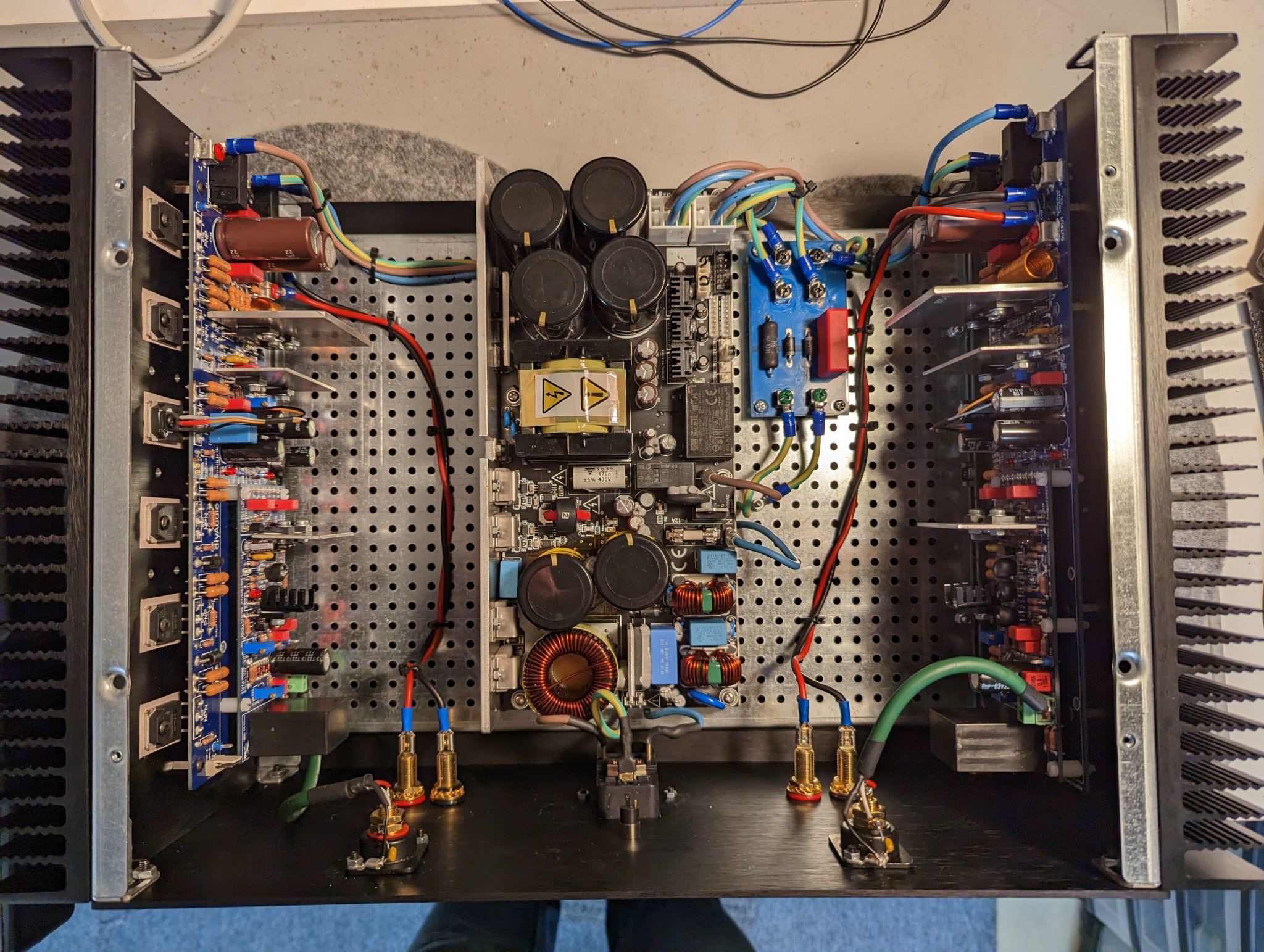

Final testing, everything is looking good so far. I cannot hear any noise even with my ear right next to the speaker.
Big thanks to the wolverine team for their hard work creating this wonderful amp.

Very clean build! Which output caps did you go with for your Cobra PSU?Final testing, everything is looking good so far. I cannot hear any noise even with my ear right next to the speaker.
Looks awesome! Great job, is that a softstart before the SMPS?Final testing, everything is looking good so far. I cannot hear any noise even with my ear right next to the speaker.
I am not sure what you are referring to. The blue PCB is my GND lift and distribution (parts are a bit oversized, but I did not want to risk anything). Apart from that there is only the Cobra SMPS and the wolverine boards.
I am using the same 2.5mm^2 cable for for AC and DC power, which could be misleading (removed the outer shielding)
Power input is a Schurter plug, double fuses, straight into the SMPS (not using the switch of the plug)
