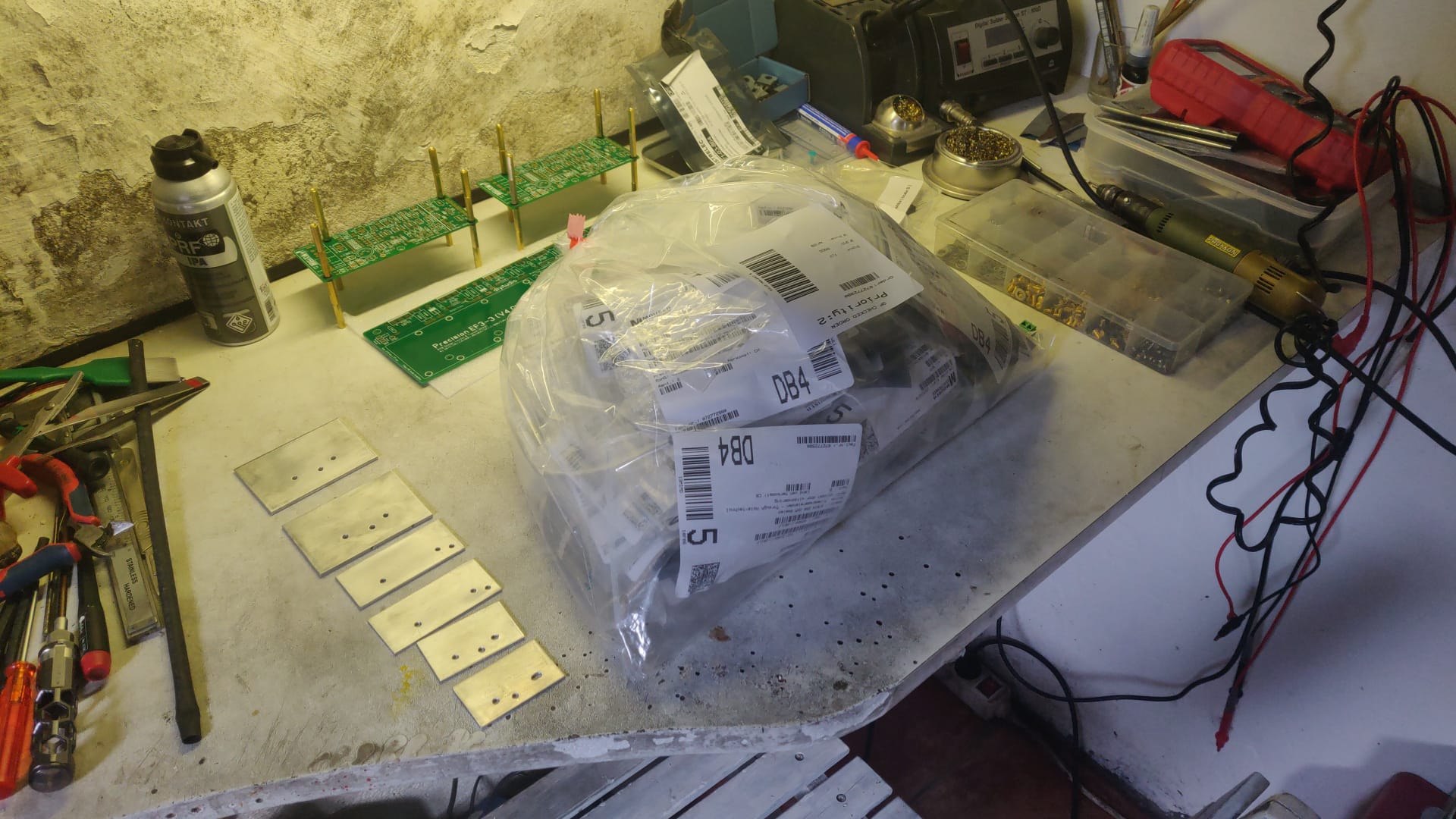

The mouser-bag has arrived. I guess I've got no place to hide anymore🙂
