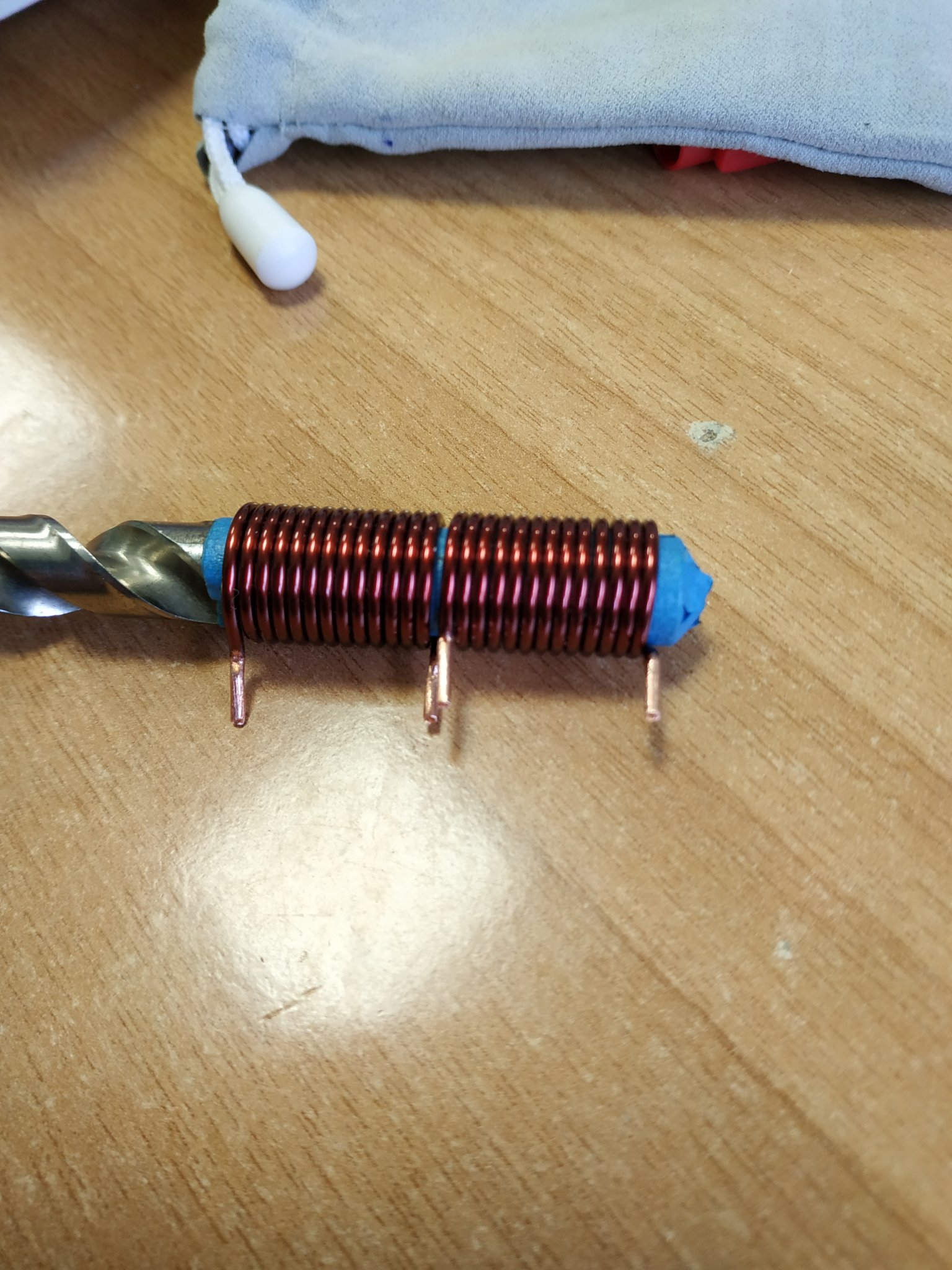

11.5mm former with 13turns 1.40 mm enamelled copper wire. Final coil size 14.5mm D x 19mm L.
I hope you don't mind this small difference.

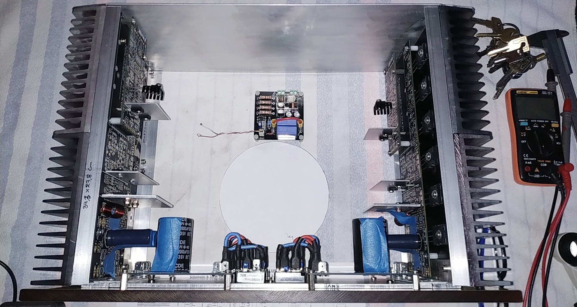

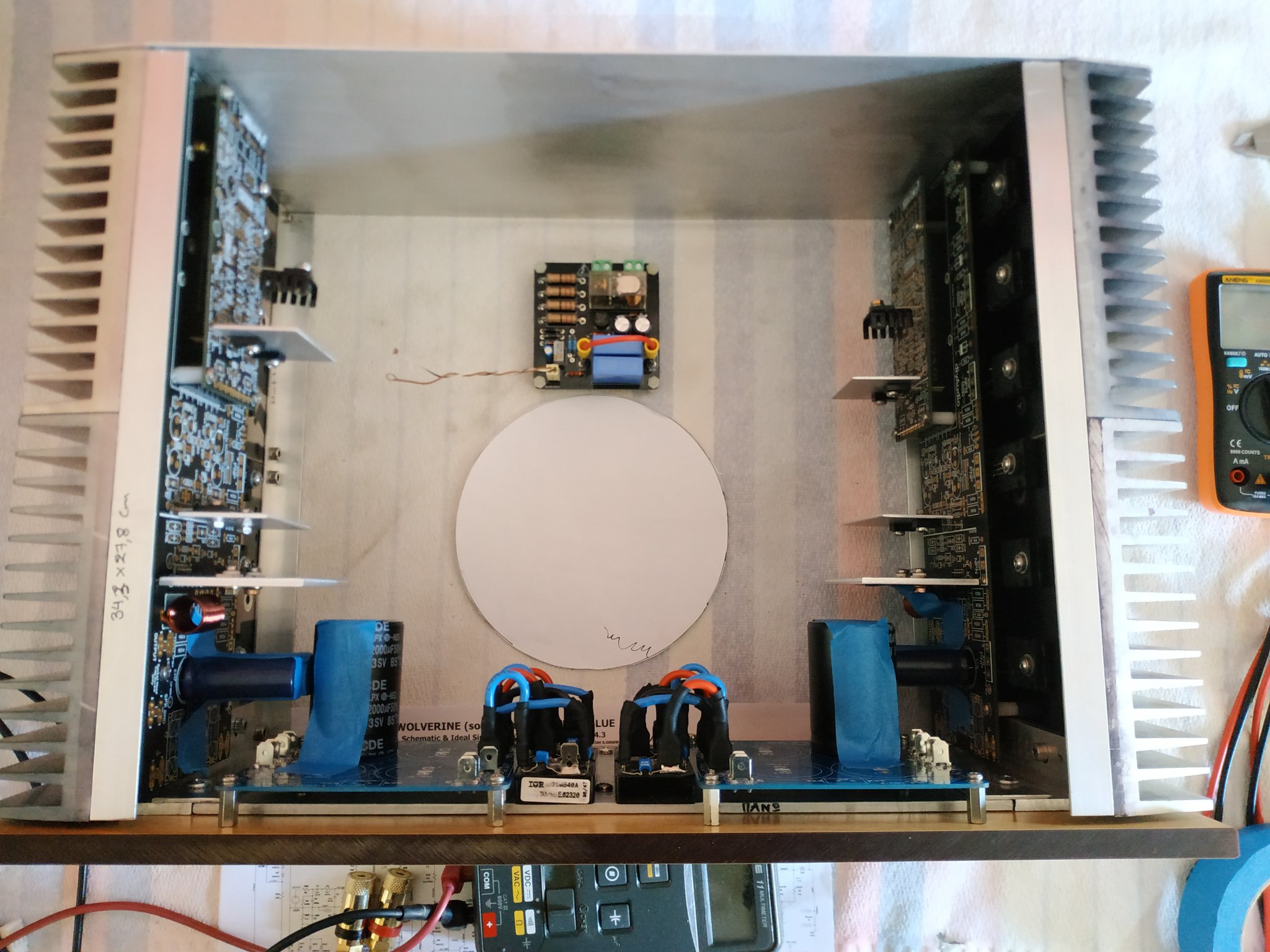

a small mock up preview for a smaller build 😗..2x Monoblock 150w thereabouts...57v rails...EF3 build...

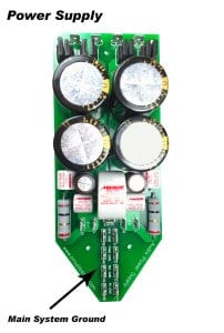

I’d be interested to know which PS boards people have used . . .
to power one of my mono blocks
https://www.ebay.com.au/itm/165087648438
I believe it has to do more with increased supply impedance.Nice tip Stuart. More holes to tap, joy 😳

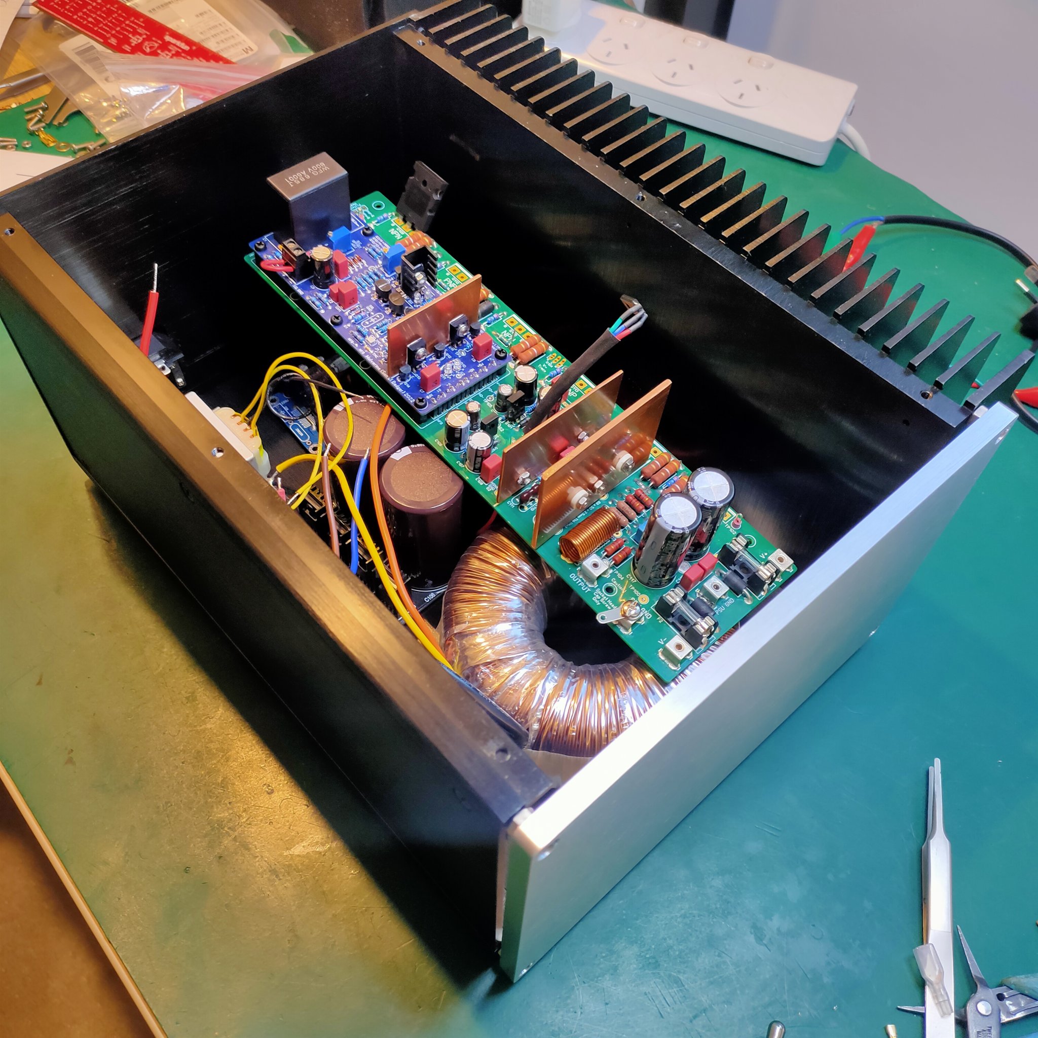

I had a spare 'bespoke' pcb left over from an old Gainclone build, so I used that with all components uprated accordingly. Not a very good photo I'm afraid ...I’d be interested to know which PS boards people have used . . .
The best way to eliminate hum is to use a shielded transformer with shielding between the primary and secondary. The shielding must be connected to the housing and to the ground. This reduces the stray capacitance considerably.

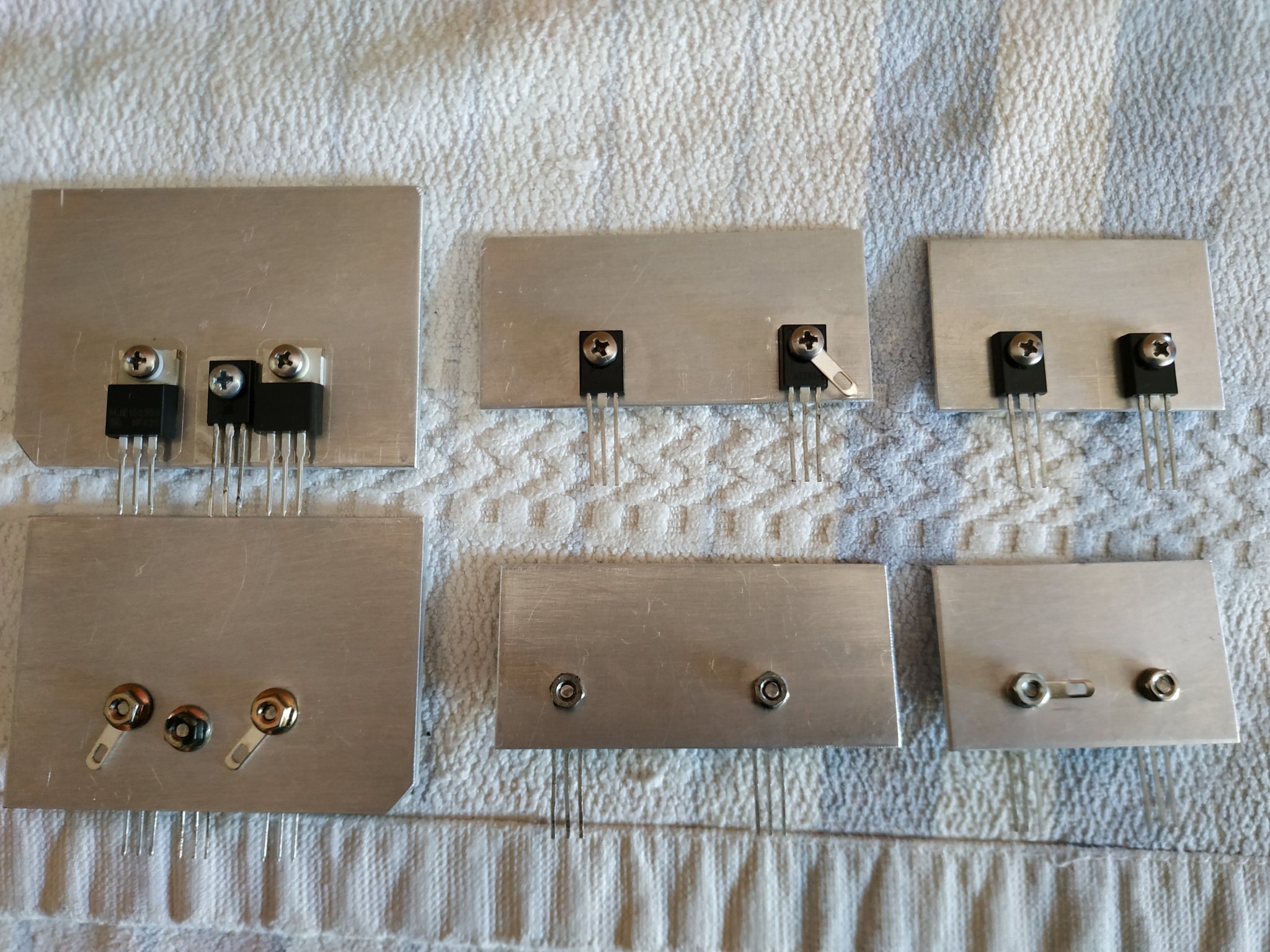

Hi diyralf,Why aren't the transistors mounted on the main heatsink?
One approach to temperature compensating an Emitter Follower Triple (EF3) is to place all three pairs (pre-drivers/drivers/outputs) on the main heatsink along with one device of the bias spreader. In this case, all devices will essentially be at the same temperature and therefore compensated as a whole.
Another approach such as the one one used in the Wolverine design, is to separate the outputs devices from the pre-driver/drivers and track them individually. The bias spreader can be constructed using two transistors such as a Darlington pair with each device mounted separately on the respective heatsinks of the driver and output devices. This can provide better bias stability as the two groups are more accurately tracked. It also allows the drivers to run at their own temperature rather than be subjected to that generated by the output devices which can be much substantially higher.
Both methods are equally valid and is ultimately a design choice. Personally, I prefer the separated driver/output temperature compensation and think it has been really well executed in the Wolverine design. Cheers.
