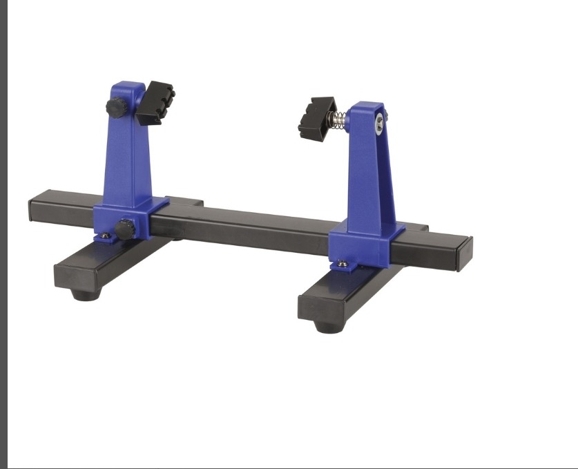

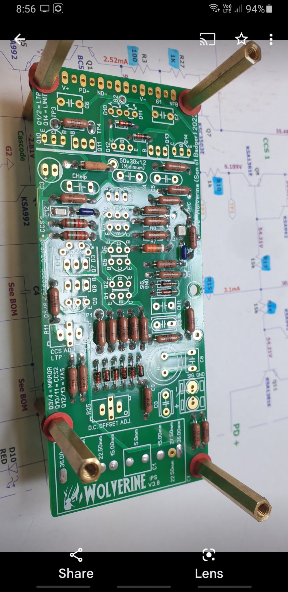

Hi Guy, Talking about pcb holders. I find just using long pcb stand offs on either side of the pcb is good enough, in fact I prefer this method to using a pcb holder like shown below. I like just using stand offs because its quick and easy to flip and more importantly rotate the pcb to the exact orientation so you can get your soldering iron tip right in there and at the optimal angle to solder each joint.
I find the pcb holder to be great for flipping the pcb but its not very friendly when it comes to rotating the whole pcb board clockwise or anticlockwise as you have to rotate the entire pcb holder frame.
Anyway just my 2 cents on the subject. 🙂

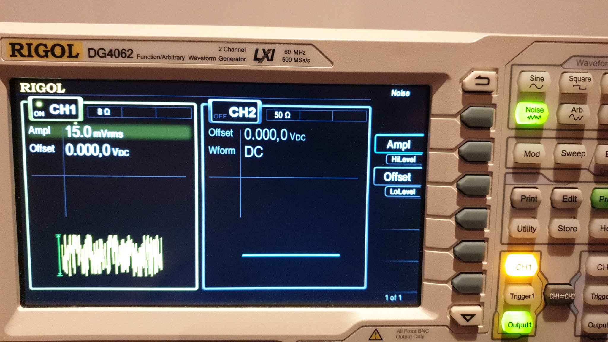

Hi Richard, thanks for your detailed response. From what you explained it does sound like the noise is coming in on you RCA cable and not something that is happening inside your chassis due to your wiring or the wolverine amplifier modules.
For completeness yesterday I did do some testing.
I found that injecting 1mv of noise from my signal generator was audible from my tweater with my ear approximately 5cm from the tweaker. The sensitivity of your speakers will also affect this number. My speakers have a sensitivity of 90dB
I then repeated the test at 1 meter from the tweeter. I needed 4mV of noise to be able hear anything.
I then had @danieljw measure one of his completed Wolverine amp modules to see what the AC measurement was. With the input terminal shorted at the ips board he measuring 80 micro volts from the output terminal to the speaker return terminal. 🙂🙏
So if you measure your AC voltage at your speaker outputs, at the binding posts or at you speakers binding posts a value of 1mV or less should be ok. It would be interesting to know what you have so please measure and post your value.
I will update the build guide with those numbers so a basic test can be done while preforming the initial testing of the wolverine amp modules.
Once again I happy that your enjoying your new Wolverine build.

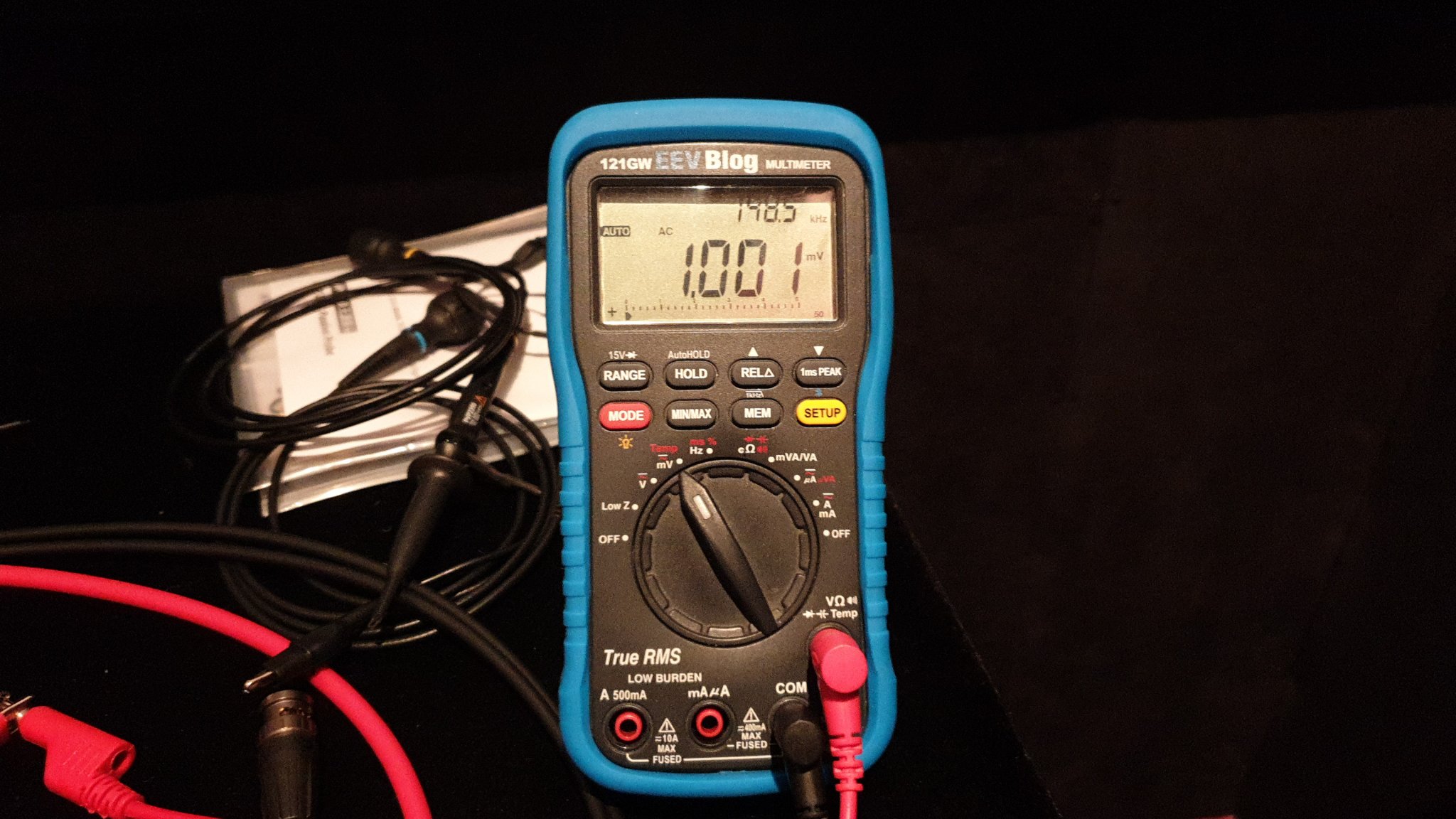

The leads leads to the bench multimeter were approximately 1 meter long twisted leads and the multimeter meter was not nulled or zeroed prior so it it is likley less than this number.
Hope this information is useful.

Thanks Dan, noted ....Just a quick note on this,
- Dan

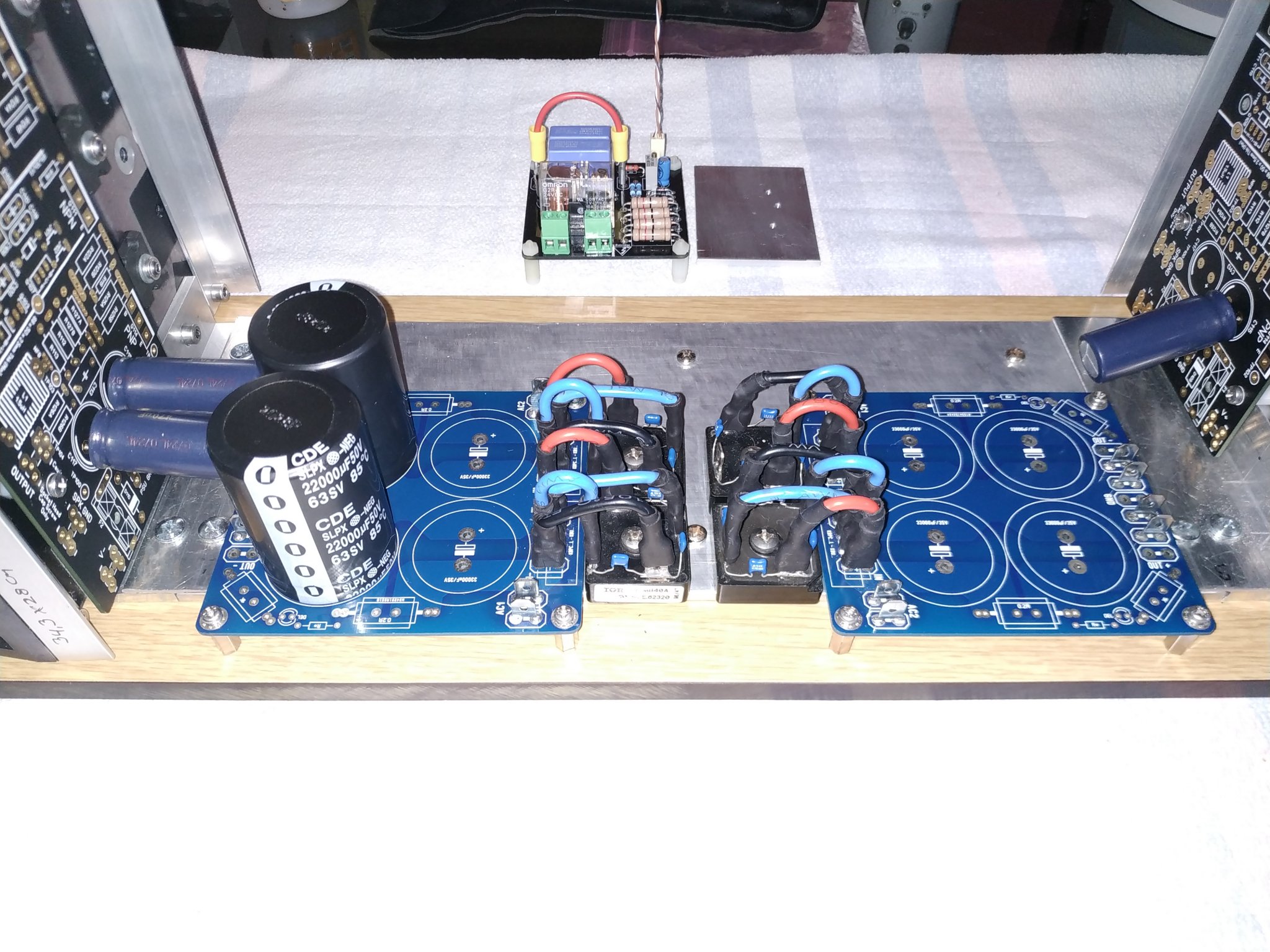

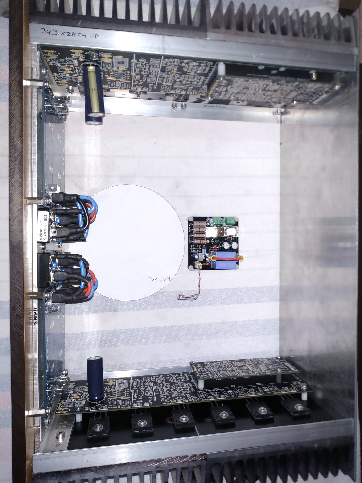

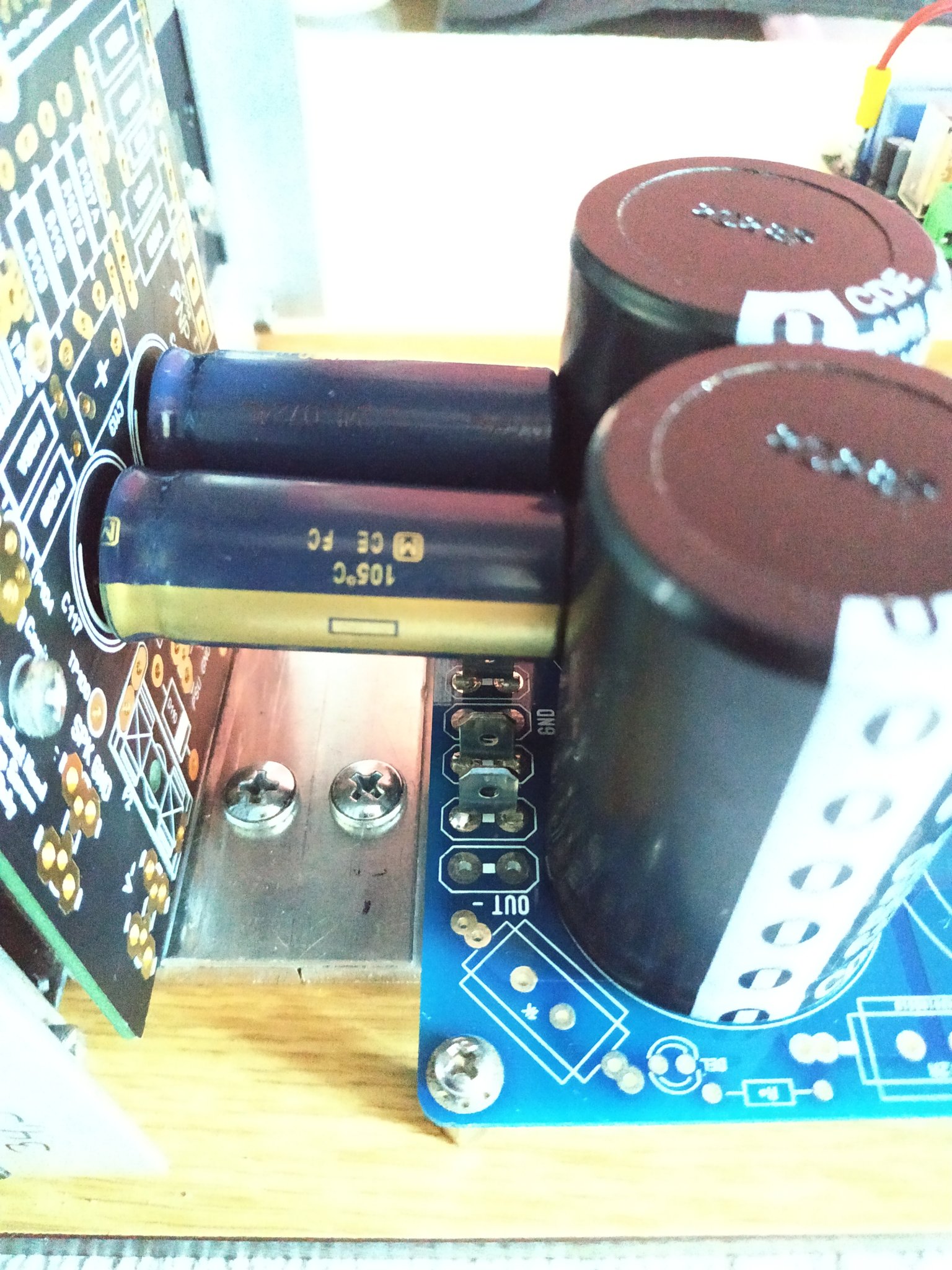

Small progress.
The distance between the PSU boards and positive negative entry spots of Volverine EF3 is about 4-6 cm...
