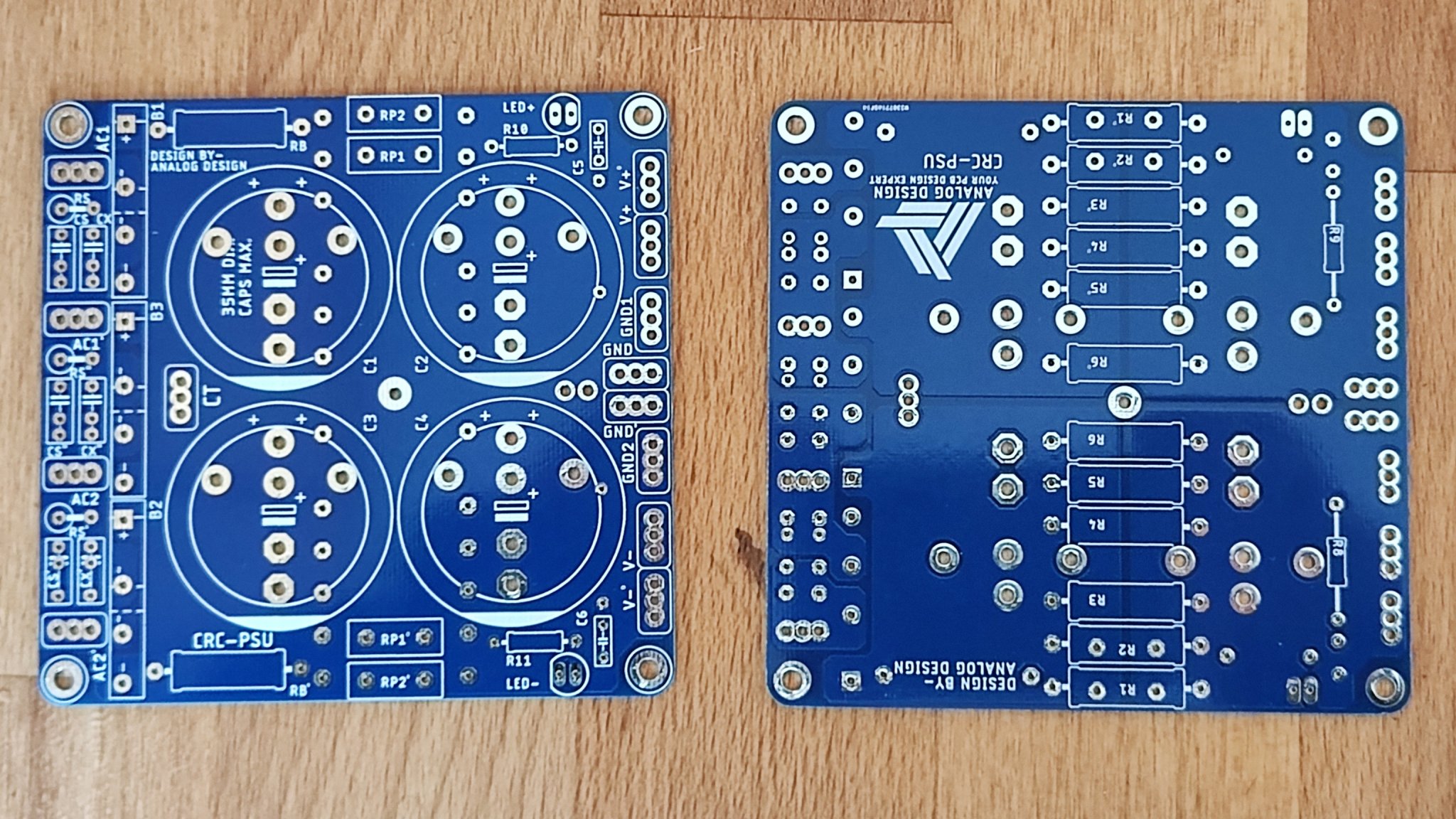

I ordered a couple of PSU Boards, designed by @prasi . They are intended to be set up as CRC supply but i am intending to short all the filter resistor positions with jumper wire to achieve an almost only C supply. I like this design, because it offers everything i need: directly integrated bridge rectifiers, the possibility to snubber the transformer secondaries, solder pads for LEDs and enough faston terminal positions. Its also very small, only 100mm by 100mm. The SIP Bridges will be bolted under the PCB directly to the base plate of the enclosure. That way i will save even more space. I hope to squeeze two Antek AS-4445 and two of this boards into my 4U 300mm dissipante deluxe case.
I have some additional boards to give away for a small price to fellow DIYers inside the EU. Please hit me up via PM.

Excellent psu boards AD! I’ve used them in a few builds. You can easily use Prasi’s SMD LT4320 active rectification boards (no heatsinking necessary) in the SIP bridge rectifier locations. (2 active rectifier’s required for this option)
Will you consider shipping to the uk?I ordered a couple of PSU Boards, designed by @prasi . They are intended to be set up as CRC supply but i am intending to short all the filter resistor positions with jumper wire to achieve an almost only C supply. I like this design, because it offers everything i need: directly integrated bridge rectifiers, the possibility to snubber the transformer secondaries, solder pads for LEDs and enough faston terminal positions. Its also very small, only 100mm by 100mm. The SIP Bridges will be bolted under the PCB directly to the base plate of the enclosure. That way i will save even more space. I hope to squeeze two Antek AS-4445 and two of this boards into my 4U 300mm dissipante deluxe case.
Thread about Prasis CRC supply on diyaudio
Order your own PCBs through pcbway.com
Yes I would, but the shipping costs to UK are on the high side. It's about €7,- for a big international letter, and about €13,- for a tracked parcel. Maybe some fees or UK VAT will be added by UK customs. That's why I said "EU only".. But if you still want some boards drop me a PMWill you consider shipping to the uk?
Thanks. I get home and read the thread of the PSU board.

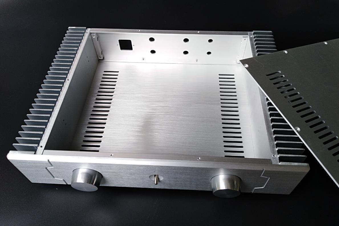

What is the requirement for heat dissipation and size of heatsinks? I am looking for alternatives to modushop- with some cute Chinese chassis around 90-120 mm in height available. I haven't seen anyone with a chassis smaller than 3U yet. The attached image is an example.
You showed us a 3D drawing a few posts ago, surely that will inform you about the fit and height requirements of all your components. Then think about drilling and tapping the heatsink holes - they need to be very accurate - are you able to do this? If the stuff you want inside will fit then a case around 100mm high internally should be OK for temperature rise but this depends on the heatsink specifications. Black would be much better of course. Bigger is better too, keeps everything cool, much safer.
I am more curious about the temperature than fit this time around. I don't want to pick a chassis which will be useless in terms of heat dissipation.
Then select a large chasis and heat sinks with heat resistance lower than 0.3 K/W. Keep this board in cool and spacious chasis. As I can recall, you intend to put the preamp in the same chasis. You will need enough space to hurl everything into a single chassis.I am more curious about the temperature than fit this time around. I don't want to pick a chassis which will be useless in terms of heat dissipation.
Thanks. I have several options, I understand implications of stuffed enclosures. Thanks for the 0.3 k/w valueThen select a large chasis and heat sinks with heat resistance lower than 0.3 K/W. Keep this board in cool and spacious chasis. As I can recall, you intend to put the preamp in the same chasis. You will need enough space to hurl everything into a single chassis.

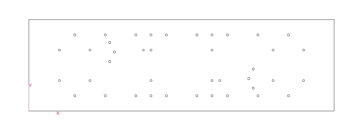

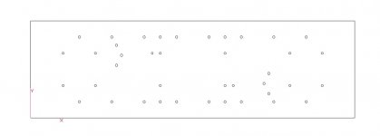

Hello @Gianluca, are the 3U heatsinks drilled in a way that the PCBs can be mounted in parallel to the heatsinks?Hello guys,
I've just returned from BAF and as promised I've added the "substitution" for the Wolverine heatsinks in all our Dissipante 3U 400 chassis to make it easier to purchase them https://modushop.biz/site/index.php?route=product/product&product_id=811
This is how we drill the heatsinks. The two 200mm heatsinks are drilled and held together by a bracket to avoid tolerance problems as kindly suggested by @stuartmp some time ago.

I think I have to ask more precisely: If I want to mount the PCBs on the 3U heatsinks like here:
https://www.diyaudio.com/community/...he-wolverine-build-thread.385920/post-7027432
Then my question is: Are the holes in a high enough position so that the PCBs do not touch the bottom of the case?

Yes, I lay'd out all the holes for the 3U, 4U and 5U chassis and supplied them to Gianluca.Thank you, @Gianluca for the explanation!
From memory the only restriction with the 3U case is the output transistor package. You are limited to using a TO-3P transistors like the NJW0281G / NJW0302G
All the hole dimensions are in the build guide and a dxf file showing all the holes is in the Dropbox folder.
Thank you, @stuartmp - this was the information which I was looking for 👍
I think the pcb dimensions were the missing peace here 😉
