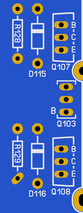

Should those of us who have boards from the first GB take any of these changes into account?
No, these are really just cosmetic changes. They were also made to provide the builder with more options and component choices. All modifications can be achieved with the existing boards except for the ability to use the smd melf resistors which was added just to provide more options.
The only changes that I would make are the modifications to the capacitance multipler and R130, R131 which has already been discussed and the information provided

Hi Stuart,
Should owners of the PCBs from the first GB, who had not built populated them yet, try to incorporate these changes, or should we be contented and happily building them as per original?
Reactions: dazcwl
Hi Stuart,
The new additions just provide more component choices for the builder and get rid of some unnecessary and unused components.
If you use the components from the latest bom and follow the latests schematic you will have no problems and your build will not suffer any degrade in performance.
I think, all changes can be implimented on the first GB boards, without any modification on the traces.
Also, Melf smd resistors can be used for R5, R26

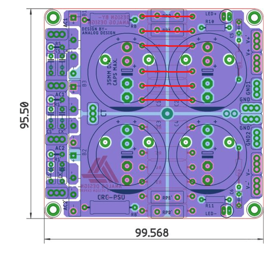

I just joined the Wolverine club and after reading big parts of the discussion thread and the build thread i want to thank everyone who contributed to this project. I am really looking forward to build my first Class A/B amp.
While waiting for my Mouser order to arrive I was thinking about the PSU. Did i get it right that a pair of bridge rectifiers and a filter capacitance of 2x 10.000 uF is sufficient as raw PSU?
I searched for PCBs to mount the caps, but then i found a PCB design by diyaudio member @prasi . I intend to mount the SIP bridge rectifiers to the base plate underneath the board, that would free a lot of space in the small 4U 300 enclosure - plus it will reduce the amount of wiring to be made. I want to go dual mono with two transformers, so i need double the space for my PSU. The board also offers mounting pads for snubber parts for the transformer secondaries.
The board design is intended to be used as a CRC PSU, but i am planning to stuff the resistor positions with 1mm wire, so the PSU shall become a "C" instead of "CRC" design. Will this work? Please see the picture attached, wire bridges marked on the upper side of the PSU PCB.

It's personal preference. I bought 4 Kemet 36.000 uF caps with screw terminals, 2 Onsemi bridge rectifiers, 1 Amplimo 1 kVA toroid and some foil caps, this for a stereo supply.
While looking throug specs of various caps, I found large differences in ESR and life expectance, this brought me to my choice.
