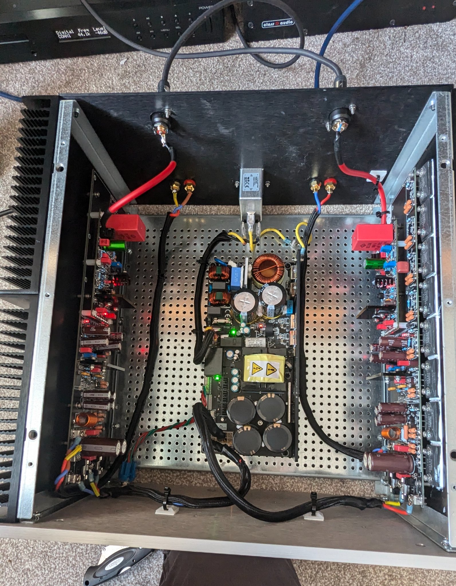

Well, I got there in the end! Here is my completed Wolverine. Clean and simple - no soft start (Cobra has a soft start anyway), ground lift, T ground or protection circuits, thought I would see how it sounded just as it is. And the verdict? Astonishing. Completely silent - no hum or hiss. I was prepared to be underwhelmed, but boy was I wrong. This is better than any other amp I have heard, and with power to spare. I have learnt so much along the way, much of it from this forum. I would like to thank everyone involved with the project, and specifically @fireanimal , @stuartmp , @danieljw , @mainframe99 and @bullittstang , together with Sami from microaudio@aol.com and Gianluca at Modushop. It's been quite a journey.....now what to build next?!

Hi @plasticator - Great to hear you have completed and are enjoying the amplifier.

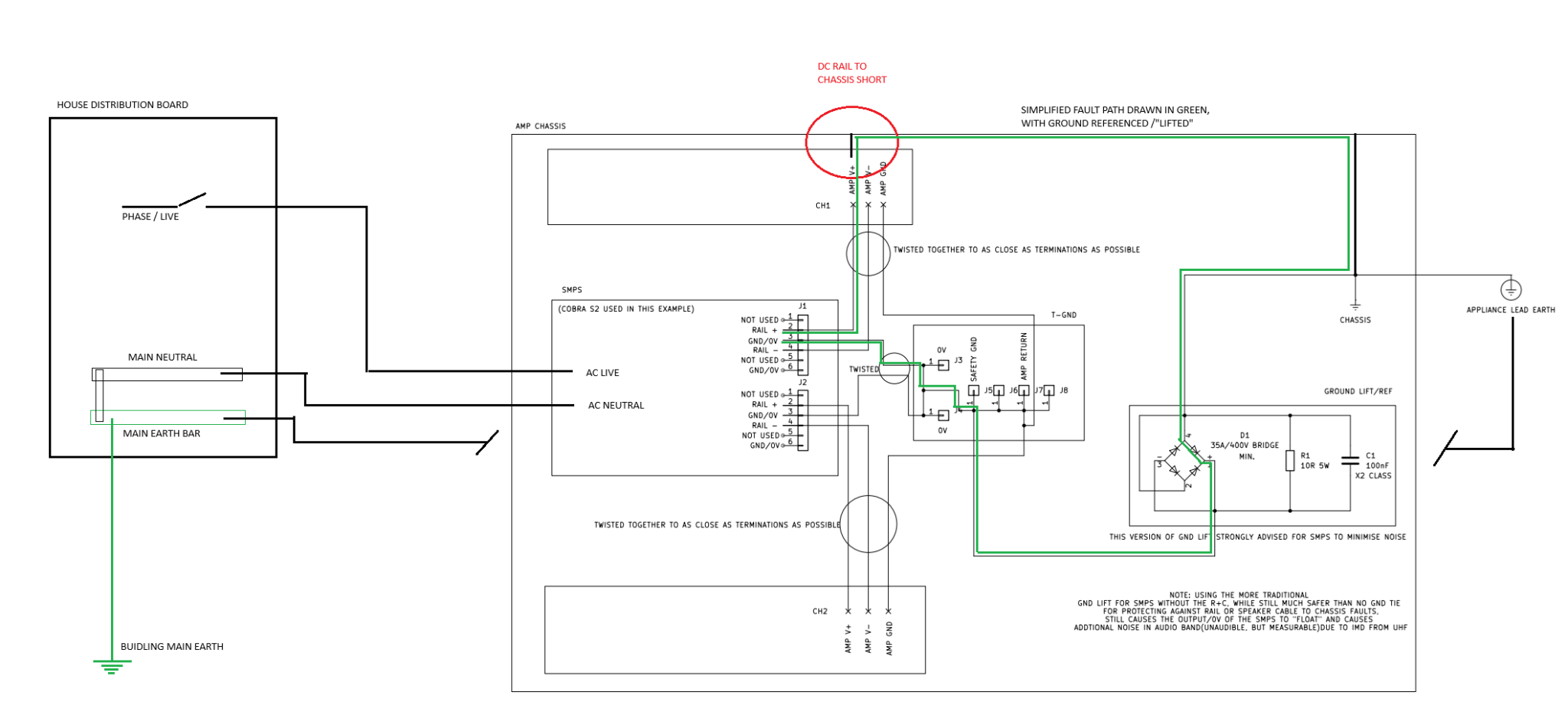

Let me start by saying from an mains electrical safety standpoint you have done all you are required to. The chassis is connected to mains earth and will protect anyone touching the chassis from electric shock, should an internal failure occur. I also note - that the connection you have from the chassis bond point to the SMPS heatsink is only necessary if you have installed the SMPS on non conductive (i.e.. nylon) standoffs.

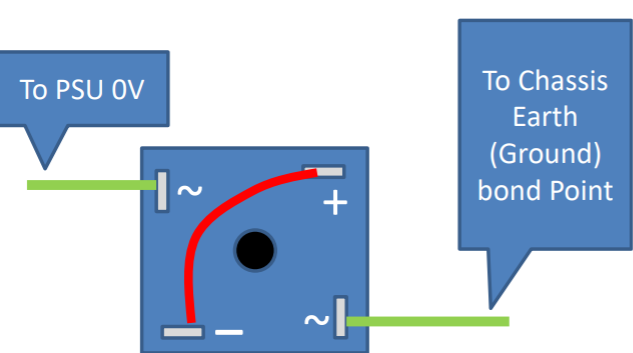

I'll tell you what to build next, and at your earliest convenience. A ground lift (1). This is in the interest of protecting your nice amp, SMPS, and rare outputs. I have attached 2 ideal schematics for you to follow (pick one). The T-GND section is not necessary but is a preferred option. You may also use the simpler (but for noise reasons with SMPS, not preferred) Bridge Rectifier arrangement as shown in "How to wire-up an Audio Amplifier" (2), distributed with the wolverine document package. Both attached and cited below. This also applies to Linear power supplies IMO.
Here's why:

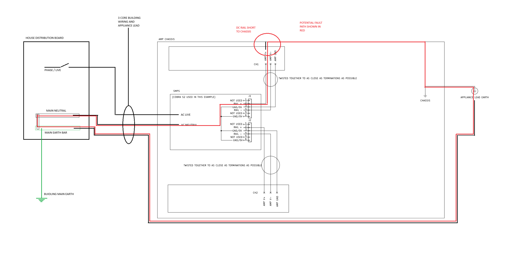

Lets say you have either
  1. Stray swarf steel/alu wedged between an output transistor and the heatsink, piercing the thermal pad not enough to make a short straight away during testing and commissioning, but may work its way through after multiple thermal cycles and short the transistor collector to the heatsink,
  2. An internal DC rail cables insulation eventually wears out and shorts to chassis,
  3. There are many scenarios, but basically a full DC rail, or to a lesser extent a speaker output finds a path to the chassis
In the arrangement you have shown pictured with just the chassis connected to mains ground, and no power supply secondary 0V line "lifted" from the chassis, there is no fast return path for the SMPS secondary fault current to flow. If one of the aforementioned scenarios comes to fruition, the fault path will be as I have drawn below. This is very likely to cause issues with the SMPS, the SMPS rail protection will eventually activate but not before quite a bit of damage is done both to the boards and SMPS. It is a slow fault condition.
** I will admit, I'm aware the AC line input and DC load output are isolated + opto-isolated and this shouldn't occur, but the SMPS feedback control sure doesn't appear to enjoy having its own output fed back into its input**
If the 0V line of the SMPS is connected to the chassis via a ground lift, the fault path is as follows, and the protection in the SMPS will activate much faster, resulting less damage done, maybe even none. Cobra Rail protection is fast.
Once you have installed the ground lift, before connecting back to mains, I urge you to perform a resistance test (not beep/bell) from each output transistor leg to the chassis. If anything is reading a low resistance say under 10k ohms, you may have found a potential future short.
Hi @mainframe99 thanks very much indeed for your helpful and insightful reply. I was happy re electrical safety aspect (and glad you agree). The Cobra sits directly on the chassis but is heavily anodised so electrically the connection is the 6 x M3 bolts attaching it. I guessed it was overkill to add a bolt + star washer earth directly to it but it made me feel more comfortable. I had thought the main application of the T ground was helping sort out ground hum/noise problems and the like, so I thought I would try without (and it sounds really clean). But your argument for adding a T ground to protect the amp boards and the Cobra is very compelling - thanks a lot, I will definitely follow that up.
