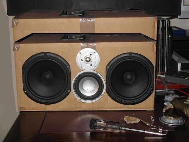

here's a laugh for ya's put the woofers in a cardboard box…
No laughs, this is a DIY WOA model that might be very functional in the end. 🙂

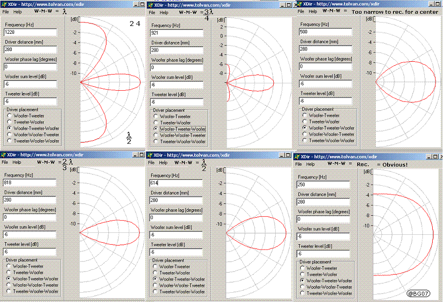

Rec. In order to reduce the M to T distance; See picture; 1(2).
Decide for an appropriate even order crossover frequency (acoustic) between the M and T as low as possible.
Where you put your lower dividing depends on the c-c distance between the centerline of M/T and the W drivers, use Tolvans Xdir program to choose an odd (at Woofer level (dB) = - 3 dB, Woofer phase lag = 90 degrees)) or even order filter (at Woofer level (dB) = - 6 dB, Woofer phase lag = 0 degrees)) and simulate the MT as an T driver in the M-T-M configuration.

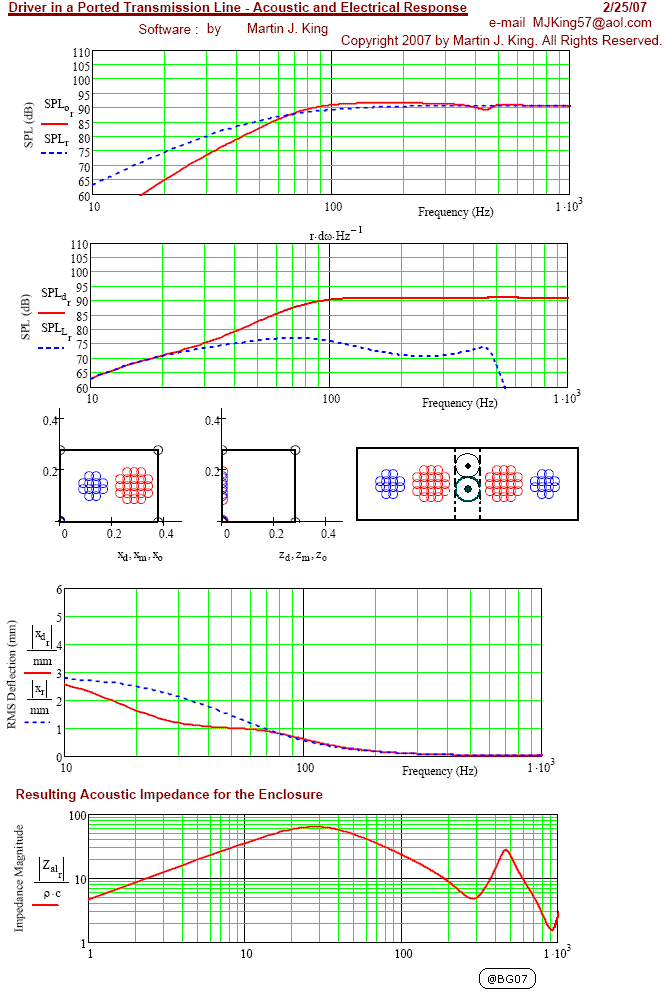

I modeled your suggested VifaBC18SG49-08 in a minimal box that happens to be a Damped Box Damped –Vent System (Aperiodic) in order to avoid a too large box and a peaking low end.
The Stuffing density in the totally filled port is 32 kg/m^3 about 0.054 kg and the box should be filled with12.8 kg/m^3 = 0.125 kg stuffing.
A box with the outer dimension of 15.5”x11”x10.75” with the internal dimension of 14”x9.5”x9.25” will do and must be doubled for a WMTWW box i.e. to 31” + 5”(width of MT enclosure) = 36” in total.
See the simulation 2(2).

Two Woofers in parallel will yield a + 6 dB increase of the SPL level using the same reference where 1 W equals 2.83 V RMS over an 8-Ohm load, the reference for the suggested M driver but the sum sensitivity stays the same if in series.
This is only valid for low frequencies; typical for wavelengths longer than 8 x the W-W c-c distance,
The minimum c-c you can use is very close to (lamda/8=228 Hz) and the suggested crossover frequency at 250 Hz thus will work well.
Now a parallel Woofer sensitivity of 87 + 6 = 93 cannot match your suggested M driver = 88 dB.
For this case you must choose to put the Woofers in series = 87 dB sensitivity, but if you really want to use the higher sensitivity that comes from paralleled drivers, you must choose a more sensitive M driver that will deliver a matching SPL level as the one I suggested.

I recommended you to chose about 250 Hz for a W-W crossover for an obvious reason, see picture.

Alright, I've got all my speakers now. (the 2 vifa woofers, the vifa tweeter and the mp14rcy)

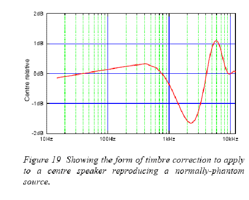

As an example of timbre matching making sense and free form DIY Urban Legends is taken from this paper:
J. Robert Stuart: THE PSYCHOACOUSTICS OF MULTICHANNEL AUDIO
See picture: 1(1)
http://www.meridian-audio.com/w_paper/multips3.pdf

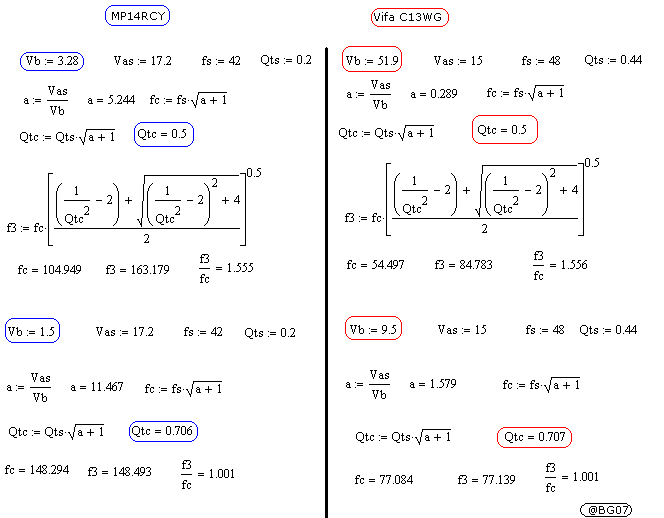

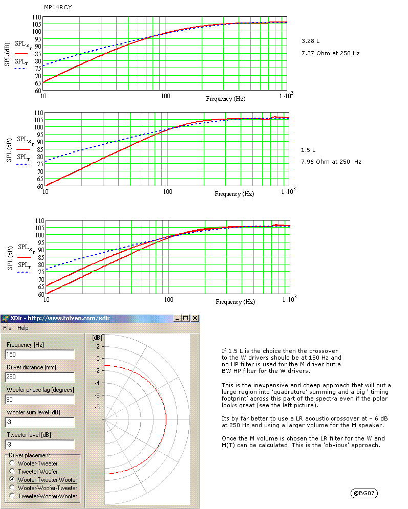

looking at box design now. for the midrange, looks fairly straight foward.. the qas is gonna be the volume for the flattest response right?
when it comes to the woofers, I would like to try and extend the bass output, so I'm thinking of a ported design for that, but not really sure where to go with it 🙁

No the flattest FR is for a volume of 1.5 L but then you must crossover at about 150 Hz using no HP filter for the MP14RCY and use a LP filter for the W drivers at that frequency. See picture 1(1) for more comments.
Make decisions and show your drawings.
The most important for this project is to make the T and M right, as you will later use the CSA to the left and right of the MT drivers and continuing the compartments for the W drivers.
For the MP14RCY you should pick a volume between 1.5-3.3 L (larger doesn’t matter as you then will use a 12 dB filter) that first can be done after you have decided how the W-M (T)-W integration affects the horizontal dispersion, i.e. if you follow my rec. to choose 250 Hz crossover (the ‘obvious’ statement) or a BW filter using the lowest possible volume = 1.5 L.
The minimum enclosure height is 228 mm and you should also decide the internal width for the MP14RCY compartment that cannot be less than 134 mm. See picture 2(2)
Make also decisions based on the fact that the W drivers should be placed as close as possible to the M (T) drivers.

In my examples shown, the net volumes for two drivers will be around 45 L (closed) to 89 L (small ported aperiodic box) and I think this is large enough for a center speaker recommendation.

Maybe a surprise for you; Normal closed box for this driver is a rather large size and one driver requires for a Qtc of 0.7 about a volume of 42 L but in a Aperiodic box the volume can be reduced to a minimum of 20 L if there is sufficient headroom dimension for a 4” x dia 7” port.
