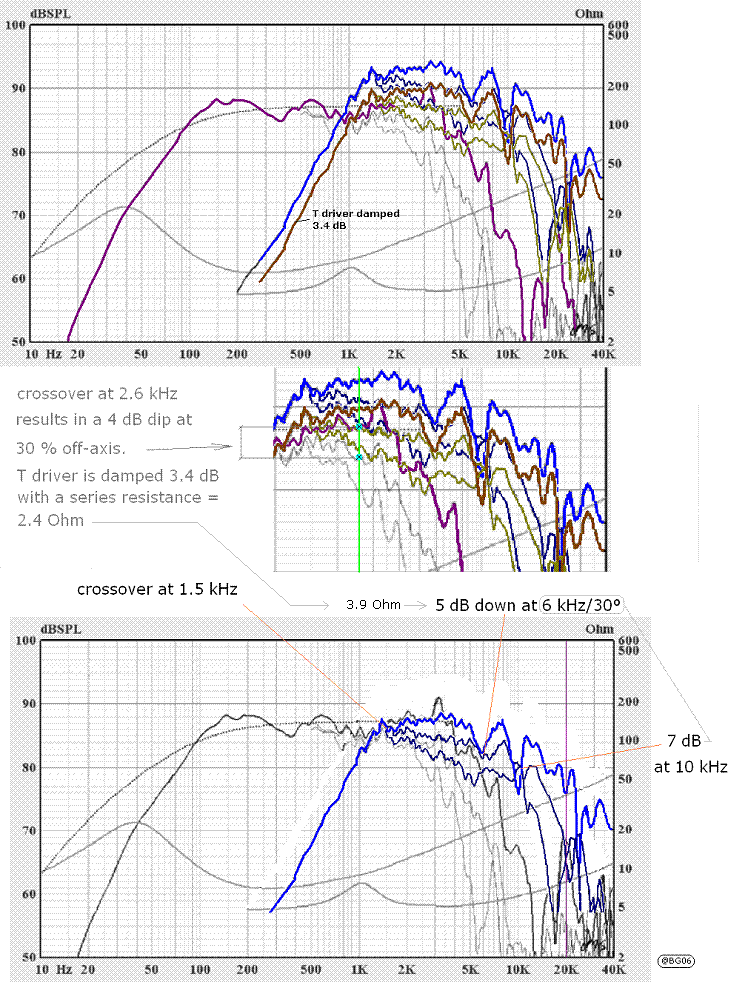

The T18RE_XFCTV (H1333) is the better coaxial driver if compared with T17REX COAX/F (H723).
H723 should be crossed over at about 3.5 kHz for a smooth FR but the dispersion is not as good as for a separate tweeter because of the wave-guide action of the M-cone.
My opinion is that the coincidence mounting is better if used as an L or R speaker but to narrow for a HT center setup and is not better than small tweeters normally used in cars.

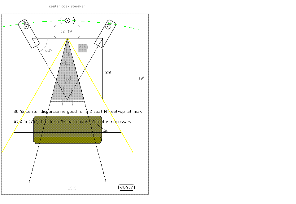

The Seas H1144 Coax Box and Xover pdf show only on axis FR measurement (at 10 degrees) and this cannot assure good of axis response.
I think your listening distance will be important if using coaxial driver if not a larger one is chosen, I agree with LineSourse of the use of a single 12" coaxial driver that can handle a lower crossover frequency for wider than 30 degree dispersion.

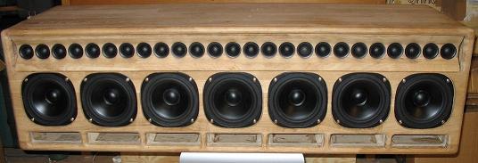

Se pic for a (WMMMMMW) center array that has a very low ripple horizontal omni coverage and a vertical 45 degree coverage when placed at floor aiming up (adjustable) or about 90 degrees if mounted high.

No, The (WMMMMMW) center array that can be placed high, between or low.
The center has very low horizontal ripple, omni coverage and a vertical 45 degree coverage when placed at floor aiming up (adjustable) or about 90 degrees if mounted high.
This center matches tonally the L and R speakers designed with Scan-Speak drivers (D2905/ 97000, 12M4631G00 and 18W8531G00) and was a requirement when built, confirmed to be true by the HT owner who also claimed the aimed center provides him a seamless focus, flaw free in apparent size when compared to L and R when listening to DVD concerts and seat independent with respect to the whole room width (= 4, 3(m), room Length about 8 m) even if standing up or moving around no ripple or change in the depth perspective could be heard.

bjorno,
Interesting picture.
Are the 25 tiny little black dots on the top tweeters? What are they? How wide is the speaker? Do they need to be tilted up towards the viewer? I guess the directivity is controled by the angled timber? I have no doubt this speaker works, but how many of us can find and build a centre speaker with 25 tweeters?
Yes, They are PartsExpress Dayton ND20TB-4 but there are not available anymore and replaced with newer types:
http://www.partsexpress.com/pe/showdetl.cfm?&Partnumber=275-035
http://www.partsexpress.com/pe/showdetl.cfm?&Partnumber=275-025
The first tweeter is identical in size and probably better than the Dayton ND20TB-4.
The center is 1.05 m or 41.34” wide, 0,35 m deep (13.78”) and the height is 0.3 m or 11.8”.
Do they need to be tilted up towards the viewer? I guess the directivity is controlled by the angled timber?
No, The center is supposed to be placed upright at floor level or higher up, even close upside down to the ceiling.
The nominal directivity is about 45 degrees at the floor or ceiling levels and max about 90 degrees or limited by the driver dispersion when placed higher up.
In additional the aiming and directivity is further controlled with a built-in rotating and tilting feature for the T array, pivot points are attached to the ends of the array, this gives at maximum + - 10 degrees.
At last also by electrical reversing the filter, where + – 15 degrees can be added by shifting the T array polarity (the crossover).
The tweeters are only at $4.10 EA (4 +).
