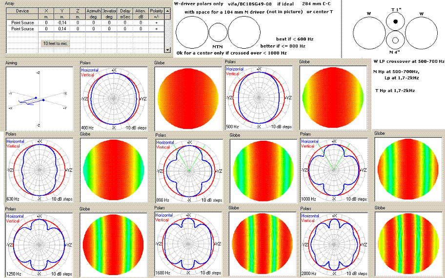

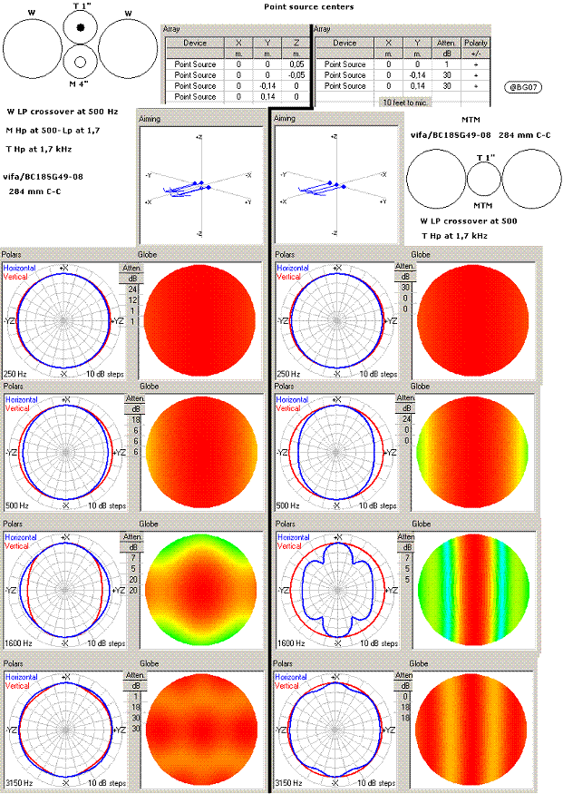

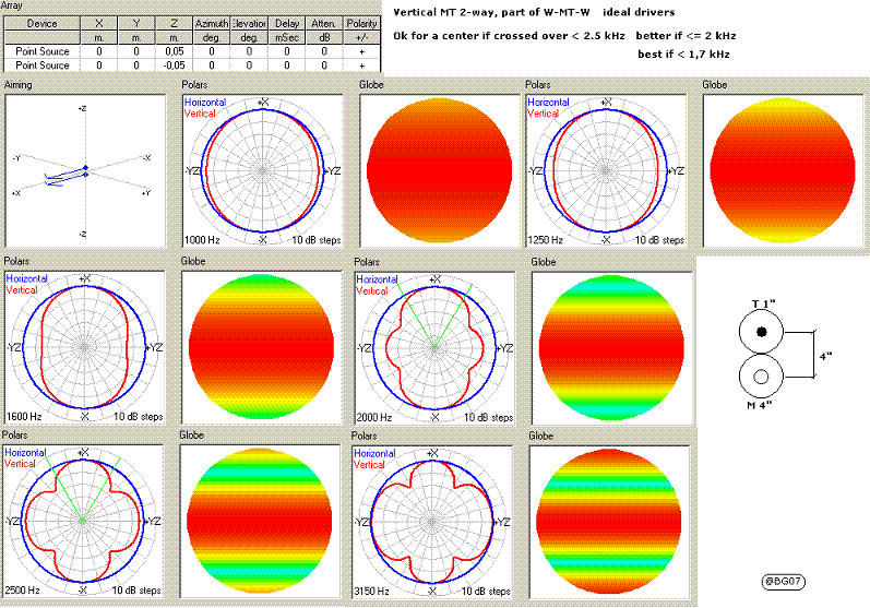

Don’t fall back. My opinion is that most MTM’s for center use are disastrous, compared to the use of this option in a HT set-up, it’s often better to invoke the HT-amp virtual center function than using a MTM but your proposal of a W-M-T-W is by far better.

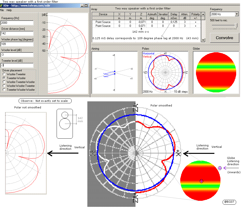

Pictures should explain more than thousands of words..or? See example picture where xdir are compared with ArraySHOW. 2(2).

And I would agree that horizontal MTM's are a bit too much of a compromise for ctr channel usage as lateral dispersion and power uniformity is often quite poor.

Sorry, I completely overlooked your location. May be a moot point however as I was under the impression you were trying to keep a reasonably low budget for this speaker. The 3 way WMTW horizontal speakers I would normally recommend are much more expensive and that doesn't even take into account shipping to Australia. If you could find an existing budget 3 way tower with local drivers you could easily adapt that to a horizontal design provided it had a small tweeter that could sit above the mid and keep the 2 outside woofers center to center distance within 1 wavelength at the xo point. I wouldn't get to caught up with BSC and diffraction from the TV at this point.
