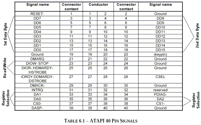

hello guys...
you haven't reply to my last post. Plzz help me in my final year project. I need to know where should i connect csel,dmarq,dasp,iordy,intrq pin of cdrom ?? in VCC or GRD. I'm using paulmon kit to control cdrom and extract data from cd.
thank you
waiting for your reply

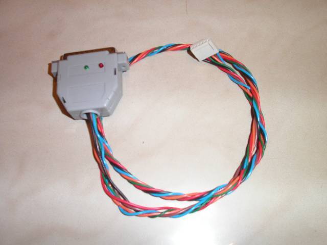

Hi rendisha,
I think you can try your cd-rom controller separate two parts
- 16x2 LCD Module
- Control CD-Rom
At First, just connect 16x2 LCD and test it. If this test failure, check PCB and all connect pins. If yes, connect CD-Rom for Full Testing.
Remember, the pin assignment of 16x2 LCD may be different, I use pin1 is gnd, pin2 is V+. Check your 16x2 LCD datasheet. And you need to adjust VR to change contrast.
Refer to lock & fuze bits on MCU, just want to protect the program onto MCU can not to be read and copy again. If you program lock & fuze bits, you can not to write it again.
If 16x2 VFD and 16x2 LCD is the same pin assignment, it should be work.
